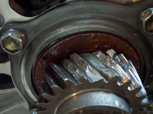

Well, here's what happened. Any ideas why this would break? The counter 5th gear I replaced about a year ago still looks good.
It does look like they were squashed doesn't it? Actually, they are broken off. All the pieces were in the bottom of the transmission. One tooth was even nearly complete.
Look for something in the debris that doesn't look like a tooth and look around to make sure something didn't break off from another part of the transmission.
Could be that one of the teeth just failed and ate the others up on the way out.
