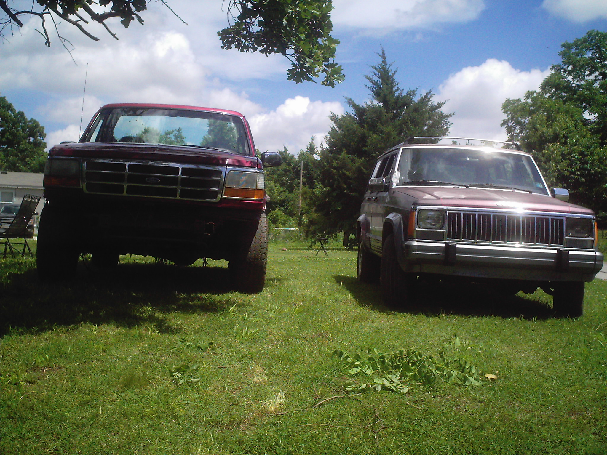

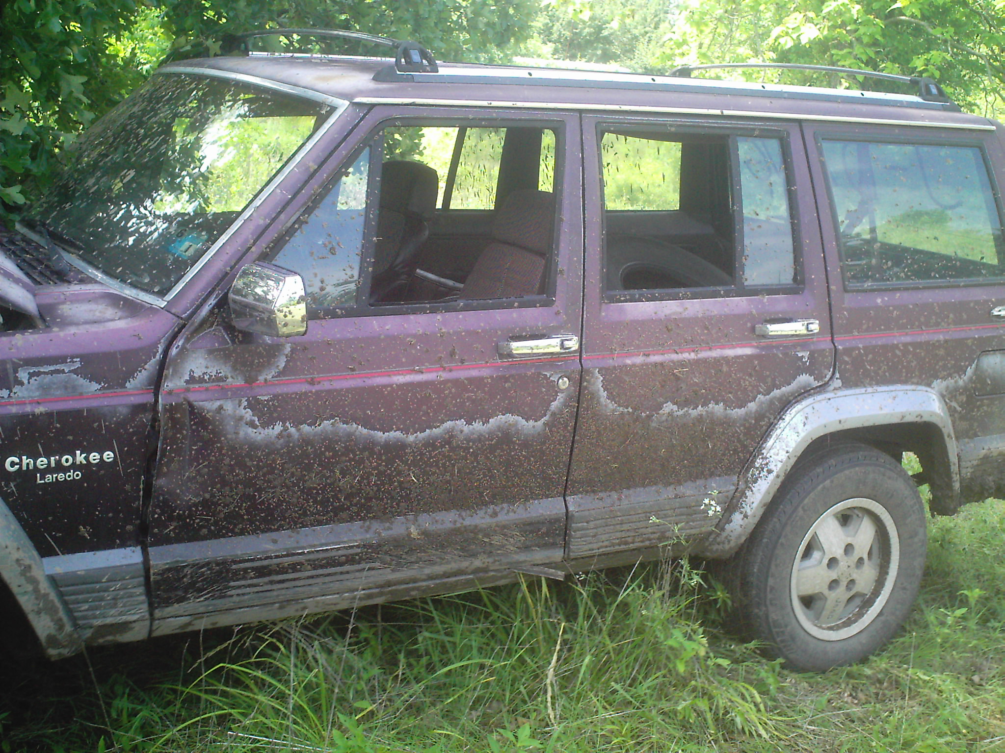

here is a pic of my last 4x4 and my next one.
I plan on folding the roof down right behind the front doors and make it look like an avalanche. useing the metal from the fenders and doors to close the gaps.
I'll definatley post some more pic's after I get it.

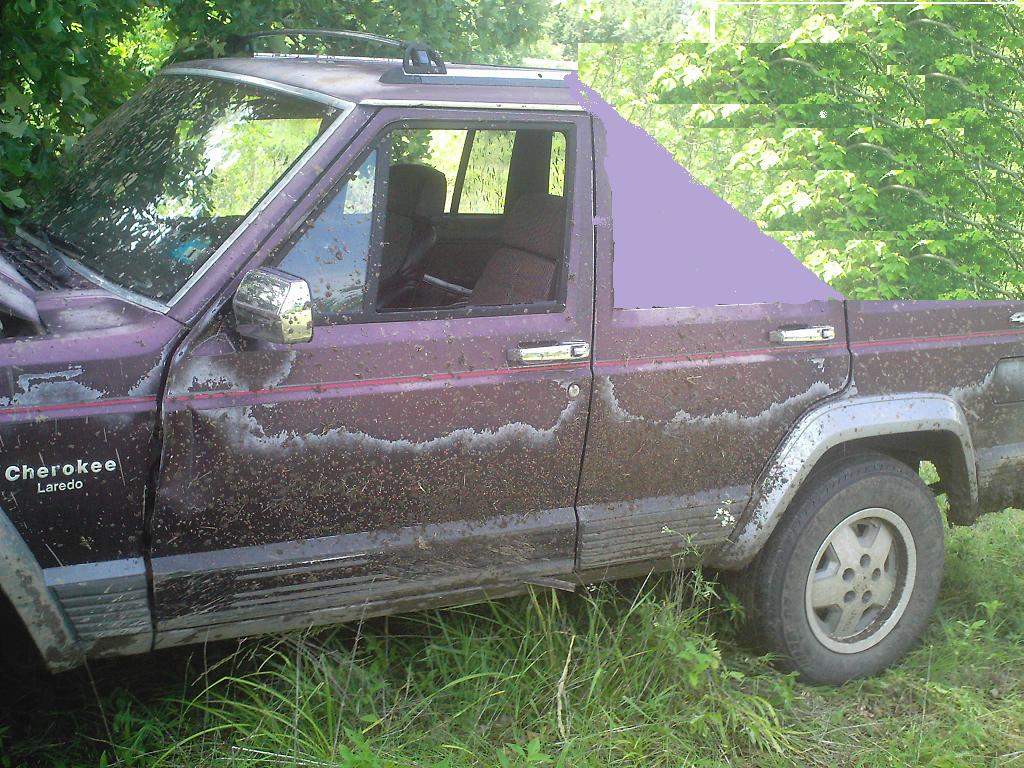

Ok the bottom picture looks alot better than what I was thinking of.
The top is what I "try'd" to do with microsoft paint.
let me know what you think?

The unitbody "frame" is only 16 gauge steel and not all that strong. I plated mine but if you cut the top plan on a cage or you WILL taco the thing if you plan to wheel it.
Personally, I'd leave the body alone for the most part, I'd sawzall the crap out of the fenders and get rid of the flares, and you should be able to fit 31's without a problem, possibly even 32's or 33's, I'd stick with a narrow tire, and get a good offset so they dont rub too bad when you're at full lock on the steering wheel. I'd go with the Swamper LTB's in 34X9.50 and do the necessary surgery with the sawzall, and rattlecan it OD green or flat black while you're at it :)
jesus christ. How did that thing straighten out?
ok I doubt I will cut it, That was horrible.
