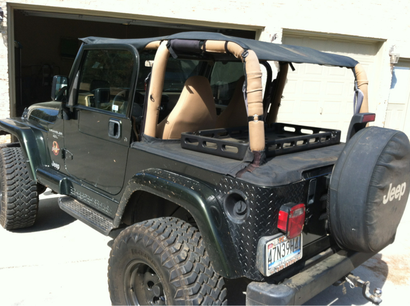

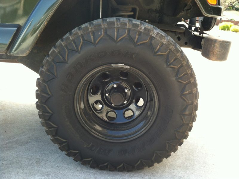

I have a 98 wrangler Sahara edition with a 4 inch lift and 33 inch mud terrain tires. I'm moving from Alabama to Texas and Ill be traveling back and forth frequently but I don't want to get rid of my baby. So, I will have to make some upgrades to help with MPG to make the trip a little less heavy on the engine and a little less expensive in the long run. What upgrades could I make to help?

The best upgrade would be a cheap commuter car LOL. Other than that, regear the axles to get the engine operating back in the proper RPM range for best mileage. Too tall of overall gearing will cause the engine to lug and use more fuel.
