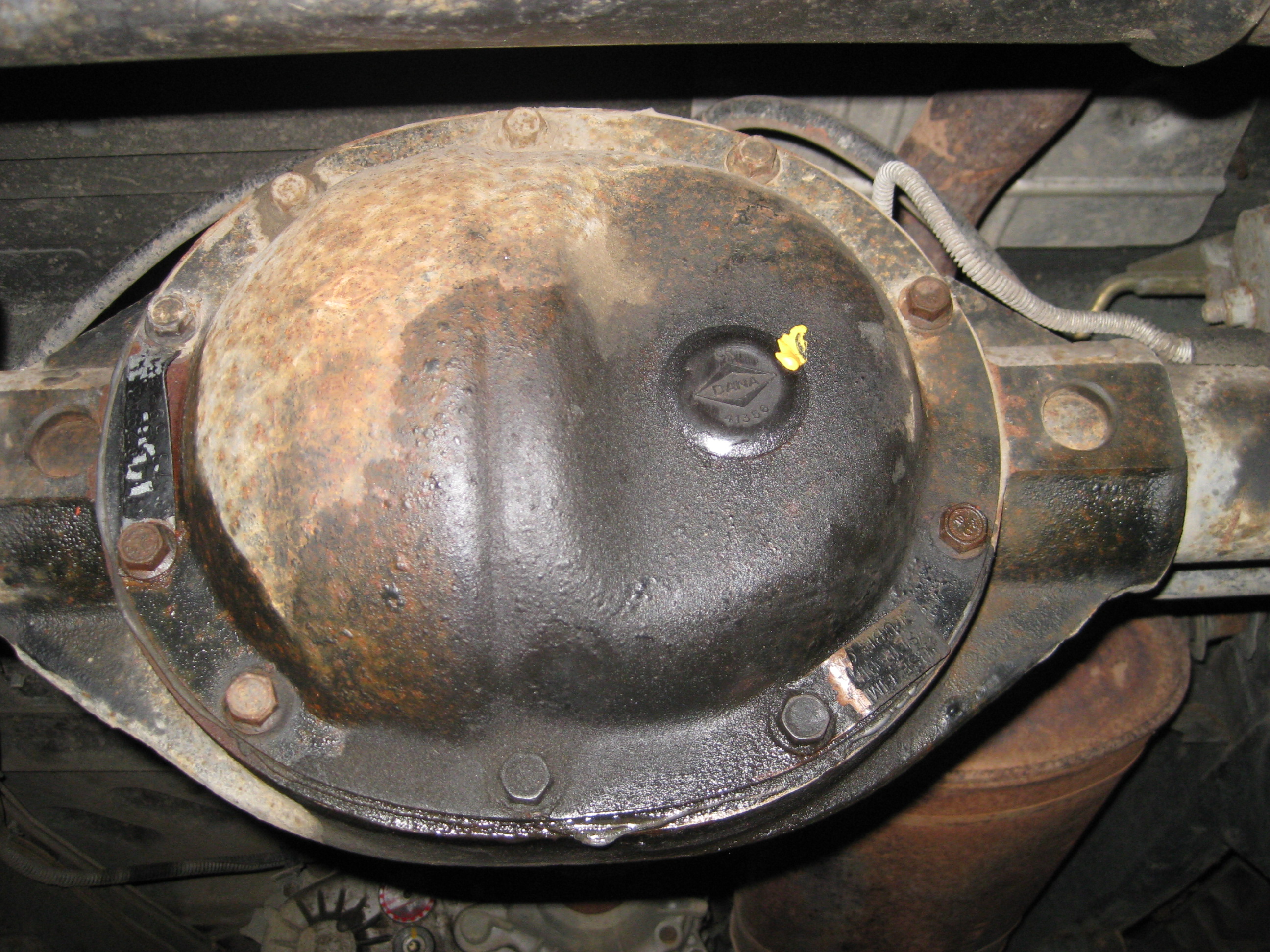

3.73 maybe? There was one tag that talked about the fluid i should use, the other had a list of numbers that looked like this:
111929AB
3 735993
didn't see anything between the 3 & the 7 on the second line.
Here is a picture of my rear diff. Just took it, just for you!

You have a 3.73...

To sum up what I have: 3.73 ratio. Inline 6. Manual transmission. 31" tires. No lift that I know of.
