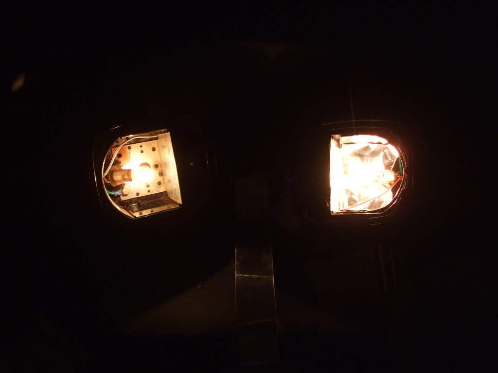

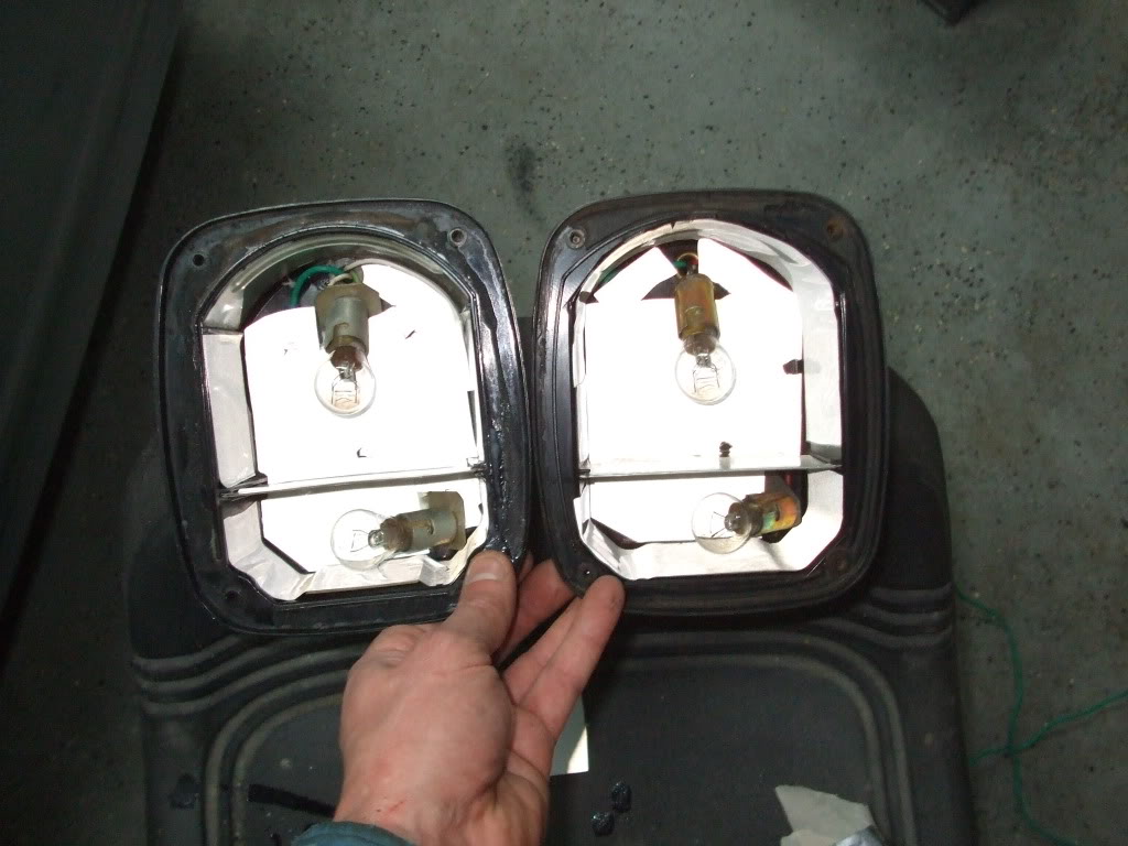

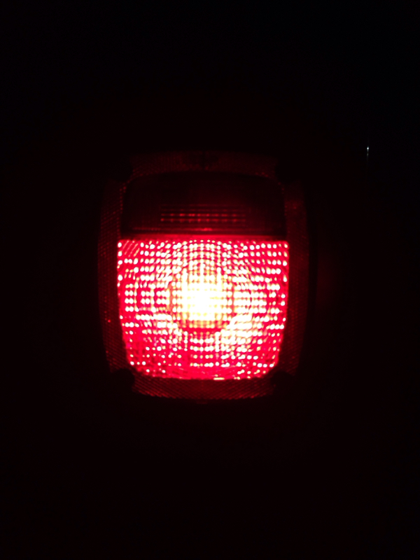

To get a more even lit taillight, remove the lens and bulbs. Then line the inside with white reflective emergency tape. Replace the bulb and lense. It seems brighter but it's not really, it is a better distribution of reflected light. image-2908100149.jpg
Like idea of tape going to give it a try !!
