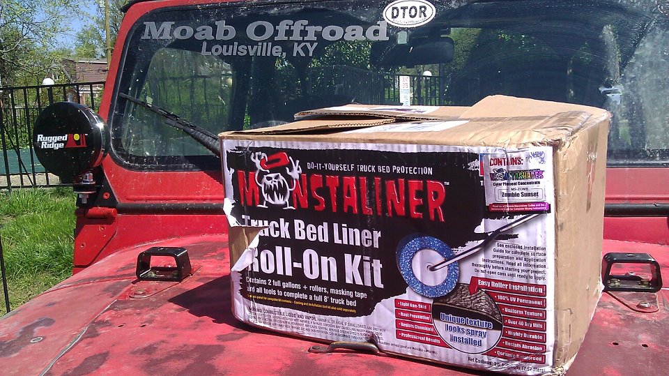

been sanding away at my Yj and have two gallons on Zombie Sunset tintable Monstaliner to put on but I want to be sure i get it right the first time. :D Measure twice cut once idea.. Any good body tips you can throw out for me I might need. :idea:

use foam ear plugs to fill your bolt holes instead of tape.
i read that in another thread on another forum
stir the can often. when I did mine everything seemed to settle at the bottom of the can very quick. You will have thin areas and clumpy areas if you don't.
all great advice.. also some of the other good advice i have heard was to spend as much time possible in the prep to be sure everything is ready. When doing a bedliner paint job their is no turning back once the paint is mixxed up
