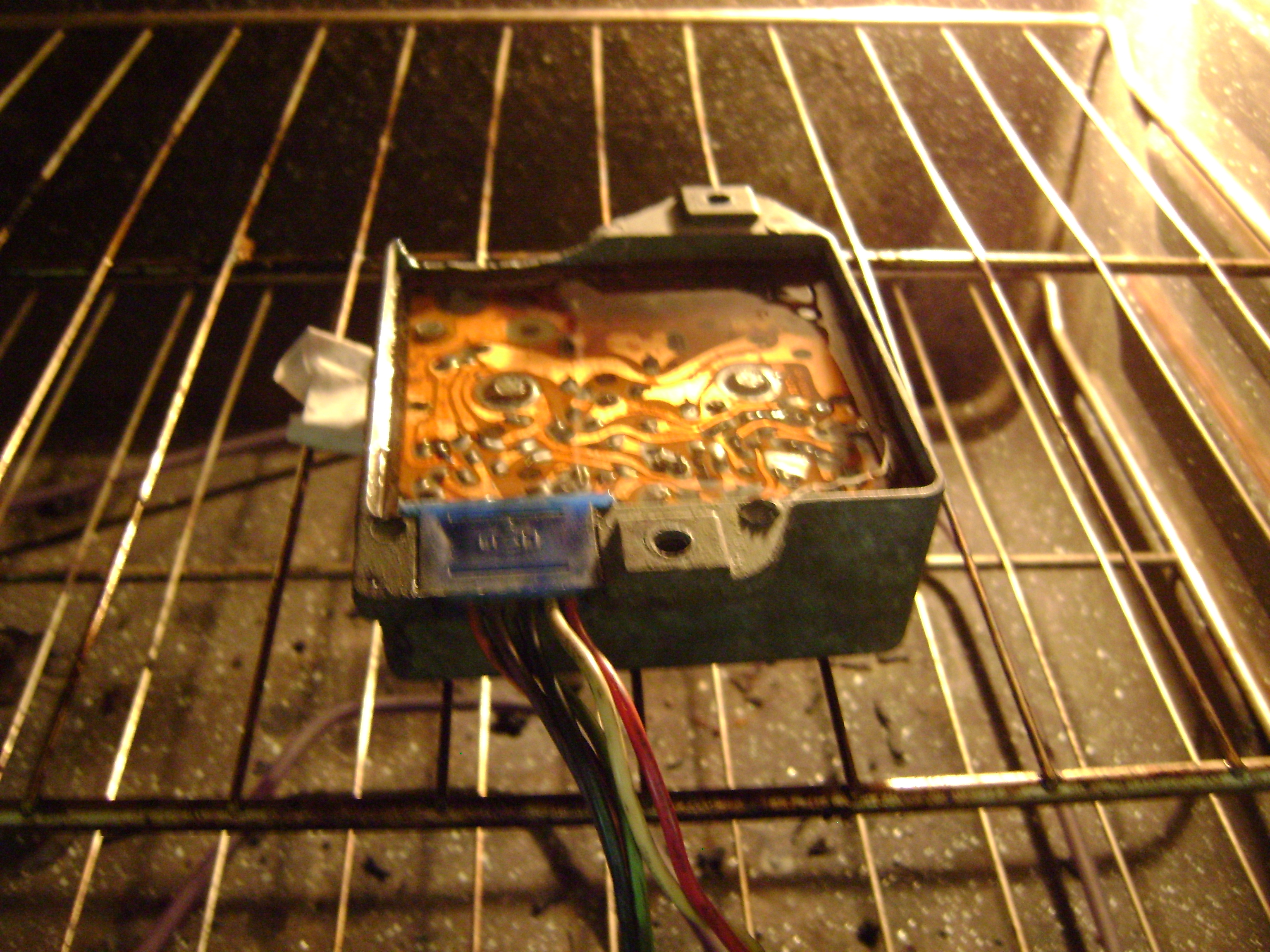

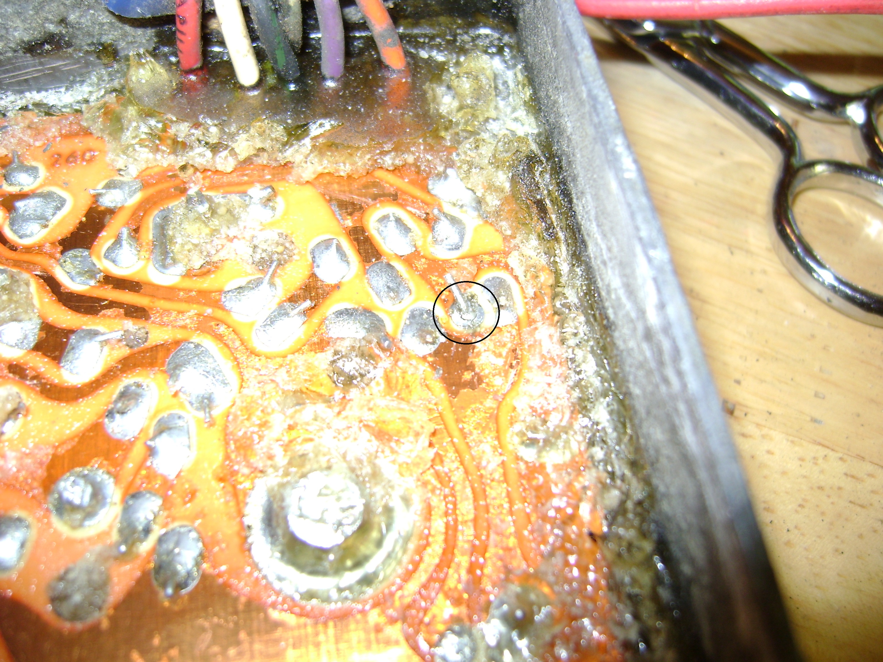

I still am going to build my own, but the old one had a cracked solder joint. So for now I have repaired it, and waiting till my potting epoxy cures.
Tomorrow will be the day of truth....
And yes, I cured my fresh epoxy in my oven, that is a good thing of being single.
It really does stink though. I'm sure my next pizza will b a real winner. ha

Yea I remember my ex comming home one evening and saw I had some harley pistons on a cookie sheet. I was warming them up so the piston pins would slide in. She threw a fit! Hee Hee Hee
I ran a test with phenol formaldehyde resin "Bakelite" in our oven. I didn't know it had dripped a little.
That night the wife made us all brownies.
That is the way to get your very own lab oven.
Always wanted to get into powder coating which involves oven curing. They recommend using an oven that will never be used for food cooking , but I don't see why you couldn't preheat parts for expansion such as flatlie46 does or cure epoxy as you are and hit the self-clean feature or maybe some oven cleaner ( which btw makes great engine degreaser) and all is well again.
I guess the powder coating gives off some chemical extract that will embed itself on to the oven walls ? So , that bad solder joint on the pc board of the module , could that just be reheated to a bright finish and good to go , providing it passes continuity and ohms check ? Just curious.
Absolutely, I cleaned it best I could, and laid the soldering iron to it.
Good as new.
Yea, the problem is, a lot of chemicals gas when heated. The stuff I ran in mine was very stinky, and a little explosive.
I blew the door off my first oven, after I almost poisoned the family. It is best to have electronic heat control, instead of contacts.
Phenolic resins main gas is alcohol. I had always pre-heated the oven, then turned it off. I only forgot once.

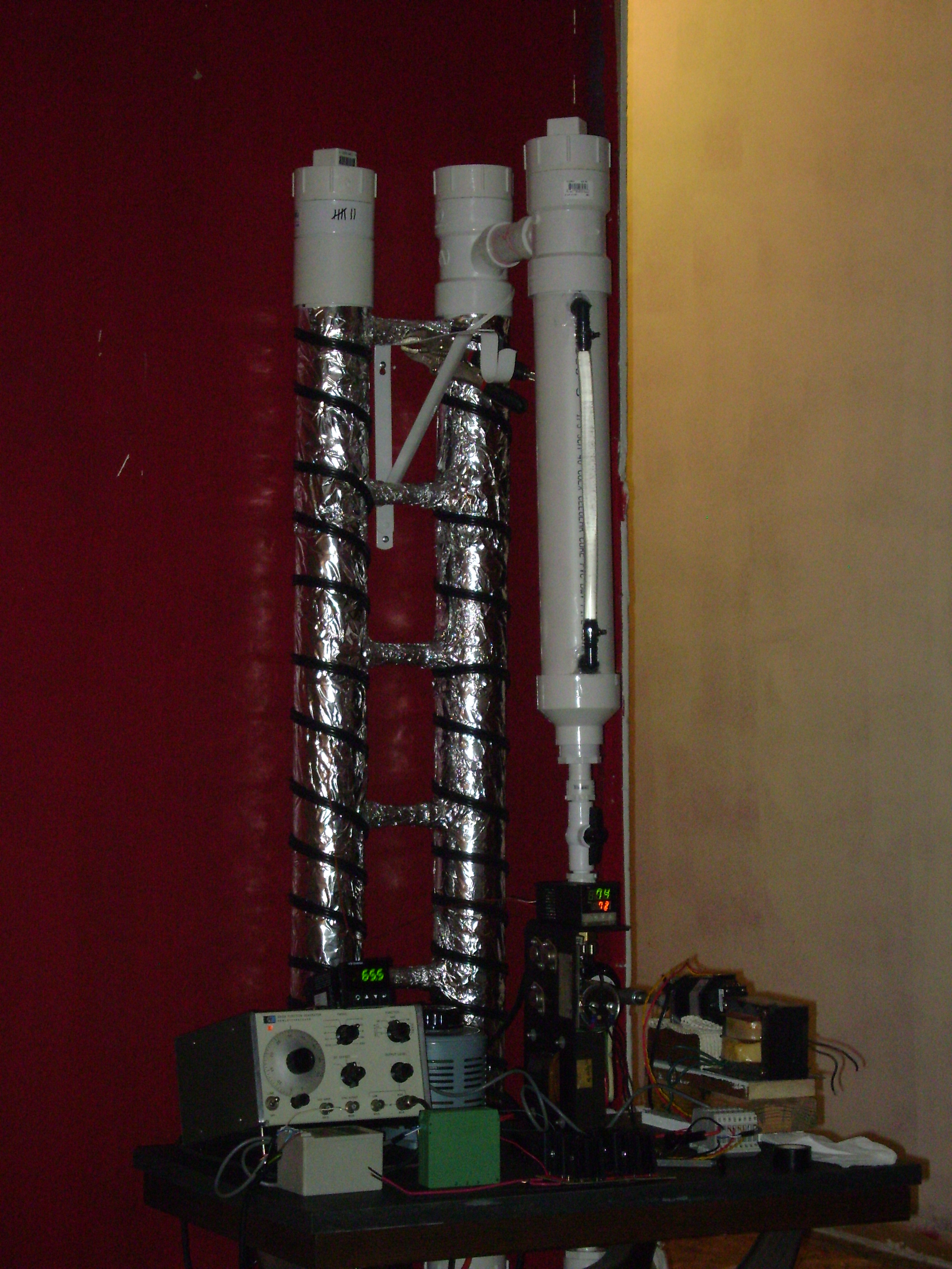

When I first moved here, I had a few neighbors come over to say howdy. This is a picture of what they saw, when I opened the door.
Most said they thought it was a bomb. I was experimenting with Nano-structure plating.
Did tell a few kids it was an atom bomb.
