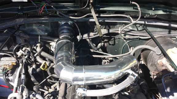

i installed a cold air intake. better throttle response....runs a bit cooler....about 1/2 MPG. You do hear the suction from inside the cab...but I haven't found it to be an issue. Install requires a few drivers and a drill with a 3" hole saw....takes about 1.5 hrs.
This one is made by Spectra.
