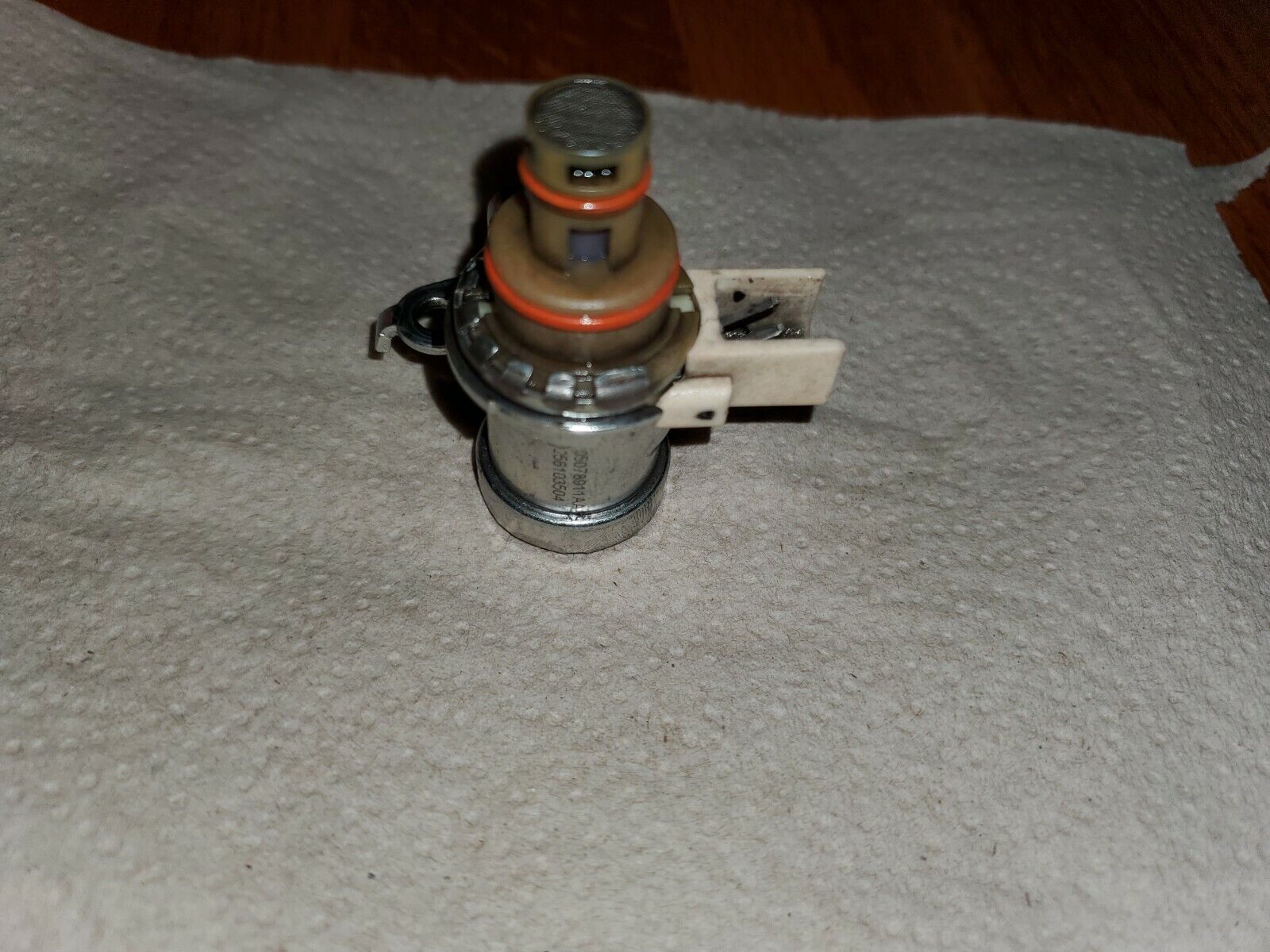

Is this what you are referring to:
Mopar Transmission Variable Force Solenoid Sensor For42RLE Automatic Transmissio | eBay
This is off a 2012 Liberty with a 42RLE transmission, so it may not be the same part that you're referring to
What your pic shows is probably the shift solenoid that goes on the transmission (from what I understand). The item I'm referring to is a cheap looking white plastic solenoid (they call a motor) that is mounted on the left side of the shifter module inside the console in the vehicle. From the posted pic you can clearly see it just to the left of the shifter module.
