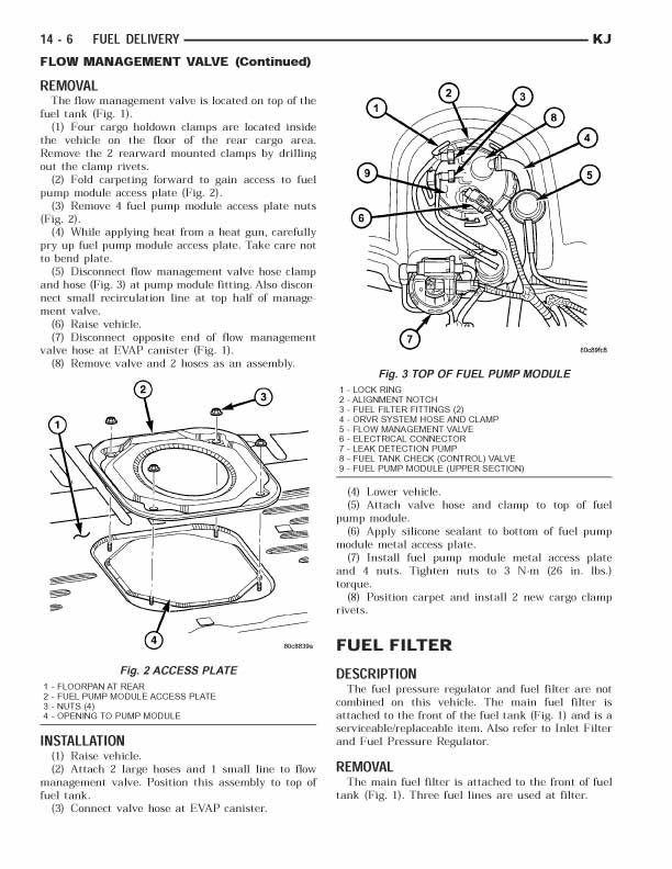

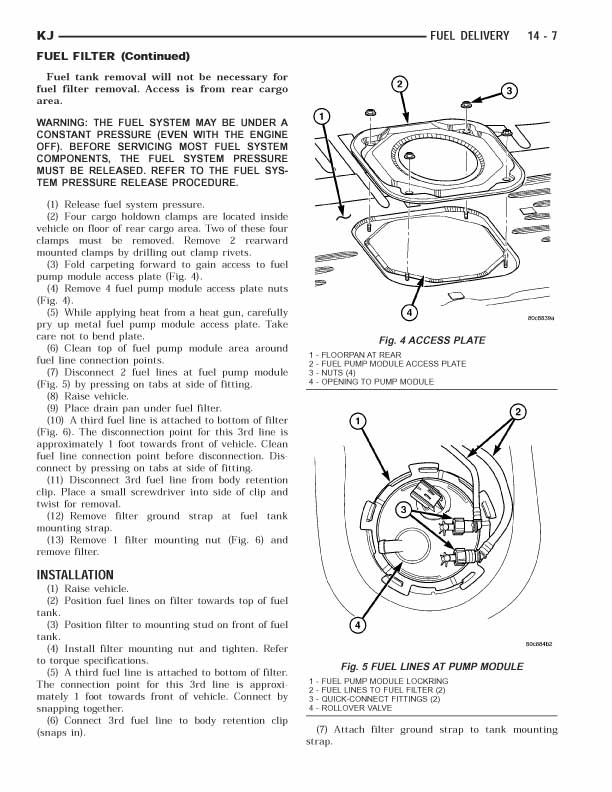

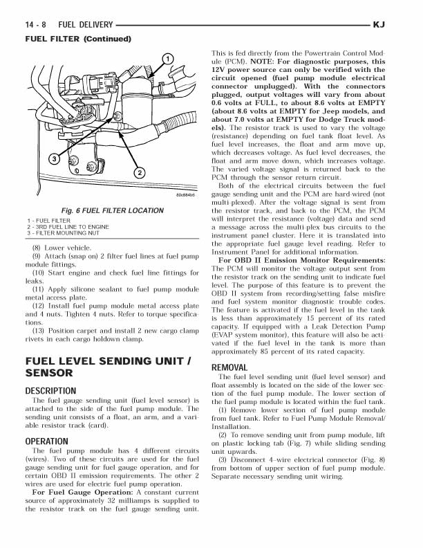

The fuel filter is supposed to be a lifetime filter, and not need replacing (although I'm not really sure how that's possible). You can change it by either dropping the gas tank down from your vehicle, or opening up an access panel in the back (this involves pulling carpet, cutting off some insulation, and drilling out some rivets).
I've never done it, but this doesn't seem too hard
