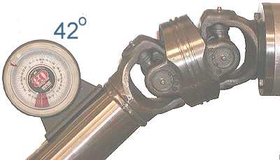

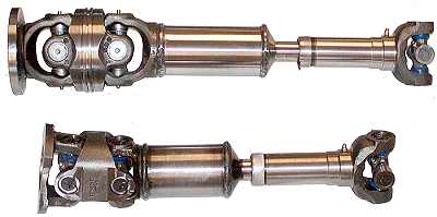

You might take a look at Tom Wood's BAMF CV Joint at:
Tom Wood's Custom Drive Shafts - Tom Woods Custom Drive Shafts Custom Driveshafts Specialist

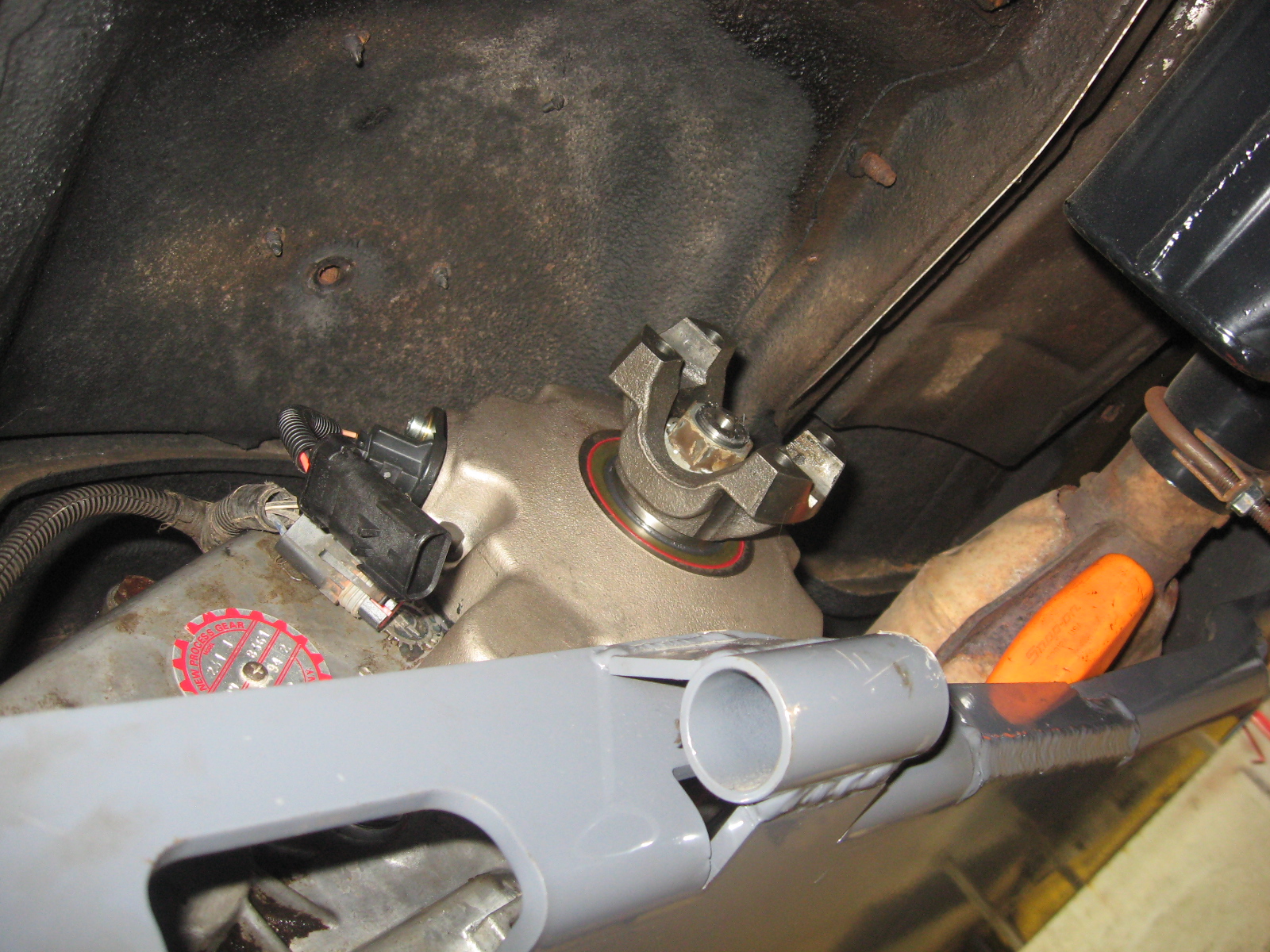

actually its not a spring over lol which is why I'm pulling my hair out..... now this BAMF shaft how is it at highway speeds ? planning on driving for 3 days to Moab :D if I get this thing done in the pic you can kind of see hoe close the t-case is to the pan and thats shimmed up 3/4 inch

The angle shouldn't be that much with only 3" springs set up SUA, have you rotated the rear axle pinion upward to where it's pointing directly at the transfer case yoke?
I run the mega-short SYE on my YJ with 1" springs and SOA, granted I have a 4banger and the stock belly skid but my angle is probably 20º or less.
