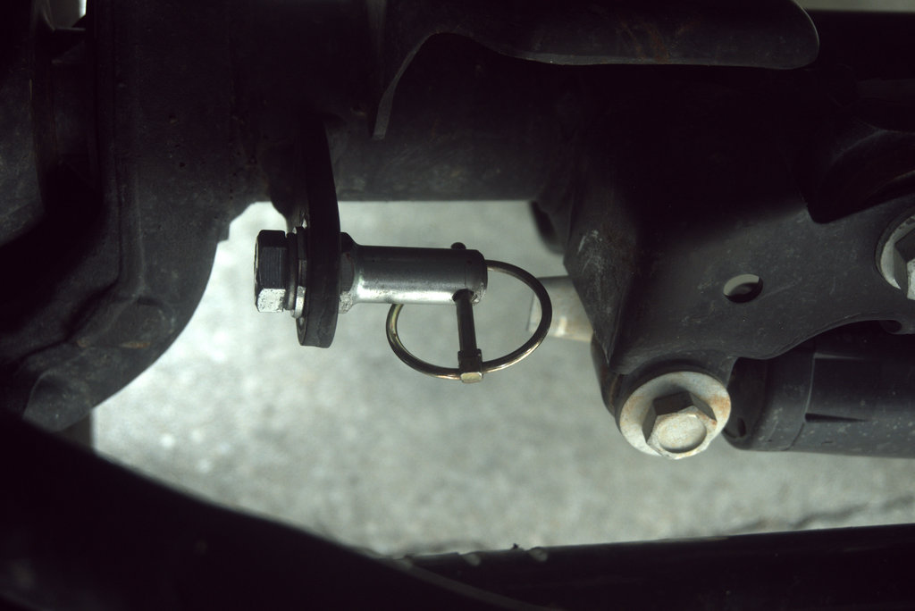

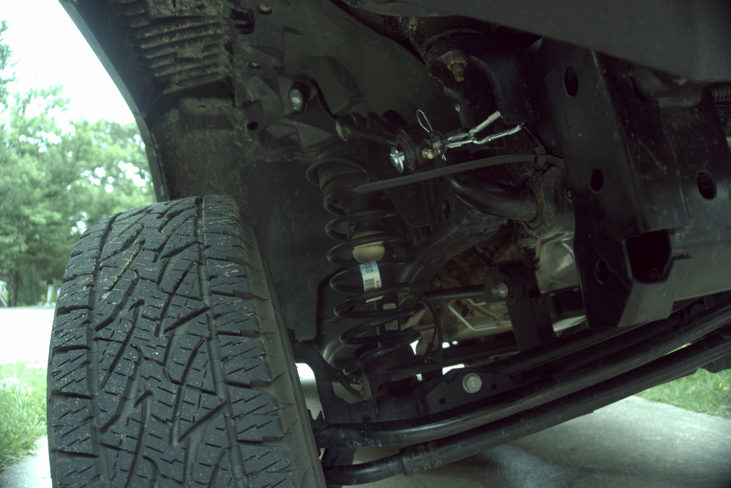

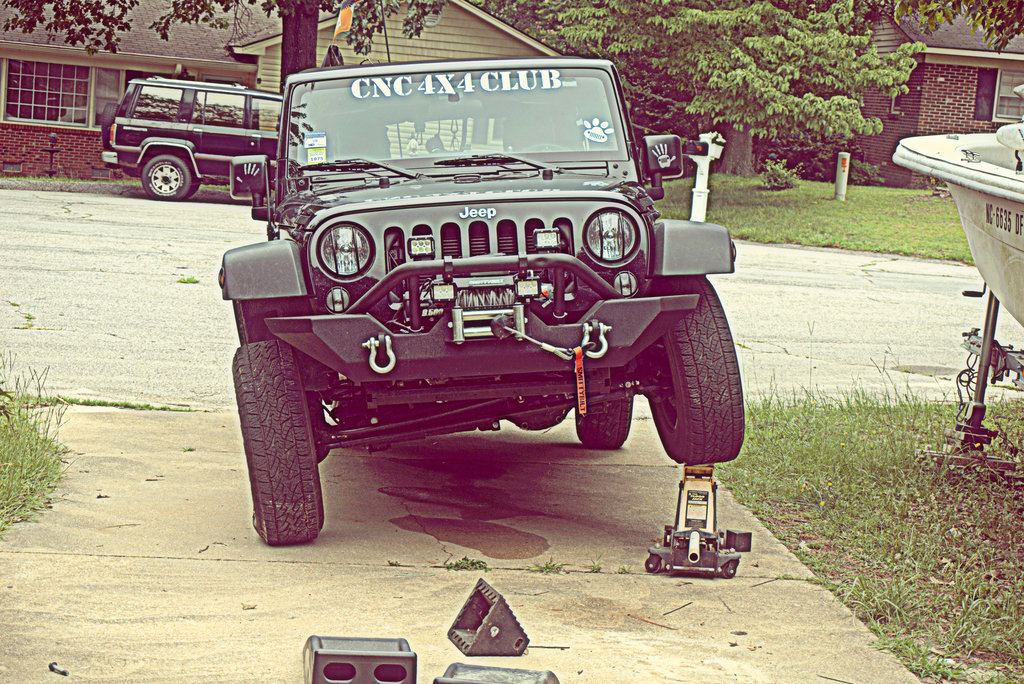

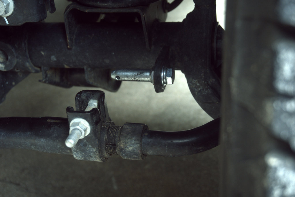

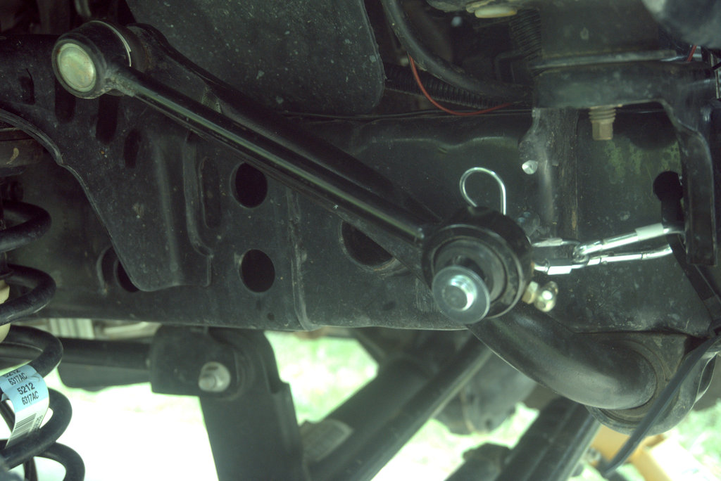

Added front disconnects. Used Rubicon Express RE1187 Gen2 Axle Bullets, Had to grind down and redrill the passenger side to fit with the steering stabilizer mount. Had to test on a jack, I live in the Sand Hill we ain't got not rocks ...lol
The last picture is the passenger's side that I ground down and redrilled.
