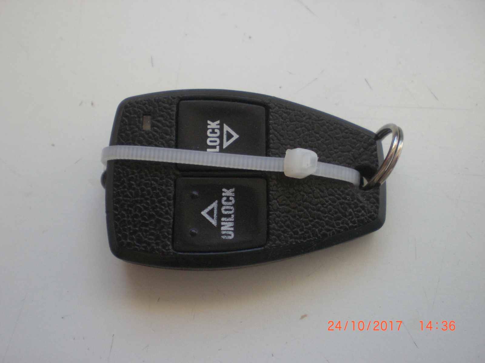

I have just resurrected a remote fob that has languished in bits in a box for ages. I have reassembled it with new batteries and the light works when I press the buttons.
So I thought it was time to try it on the car. We have two XJs and I don't know which car this fob came from.
As you might expect nothing happened.
I reprogrammed it as per the Youtube video and the light gave a double flash indicating it was done.
Still nothing happened, so I did it again with no success.

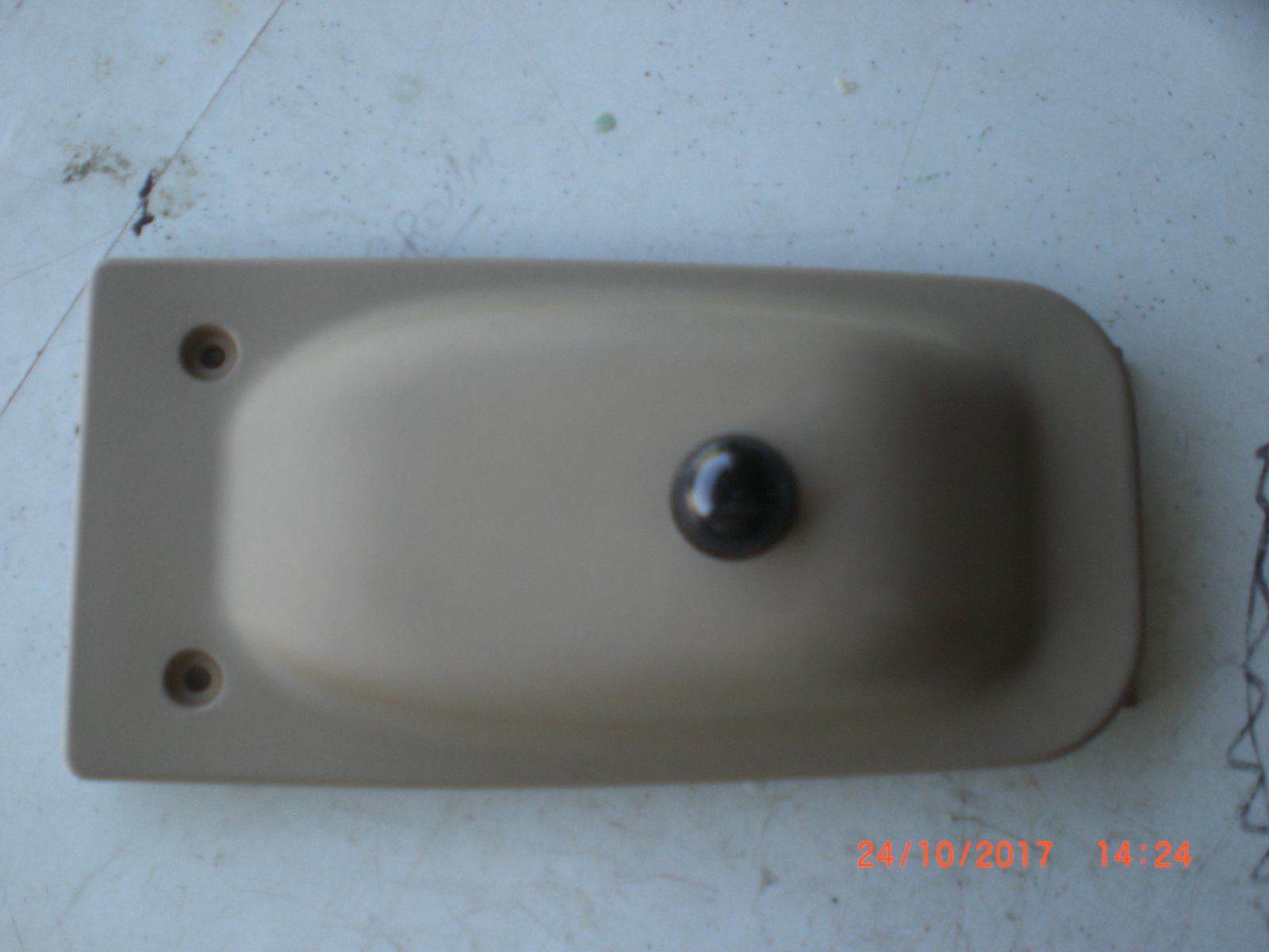

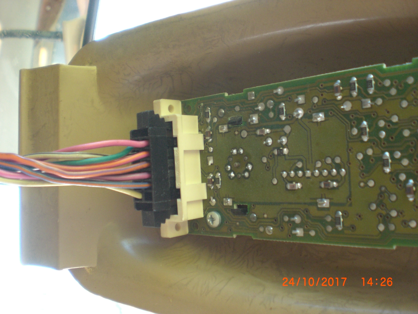

I have been back and done some checking.
The wiring diagram I have shows four wires connected to the module in he roof. When I took it down there were no less than eleven.
The four wires shown were positive and negative feed and one wire out for lock and the other unlock. Simple, I can cope with that, but not eleven and no diagram.
There is a feed, so I tried to marry up the remote again with no more success.
So I am still stuck. I think I might try to find another module and remote because I have no idea which one is faulty.
