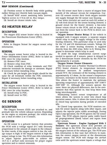

So after much sitting in my driveway after a failed Crank sensor, a leaking gas tank and rusted out skid plate for the gas tank, I got the ugly monster running ok. But I'm do for a NY inspection and I am getting codes related to the 02 sensors heaters. It's on all four 02 sensors and it is on the heaters side( Sorry cleared codes and didn't grab numbers). Any circuit or fuse carrying this power supply for the heaters? Thanks.
