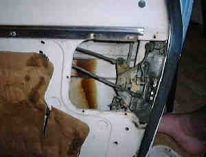

Having removed the door fabric you will need to remove the metal plate with several screws to get access to the door lock components

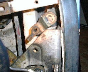

Once you have everything off, you need to find the bar that connects the lock to the latch assembly

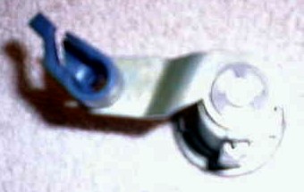

Now you need to slide off the C-clamp that is on the lock, this will allow you to pull the lock out of the outside of the door. This clamp is pretty hard to see, it's tucked back in there pretty good.

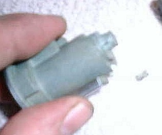

You will need to use pliers and break off the little piece of metal on the new lock (remember, this is a Ford lock). This should allow you to put the small door clip back on the lock, with the C-clip, then place it back in the door.
