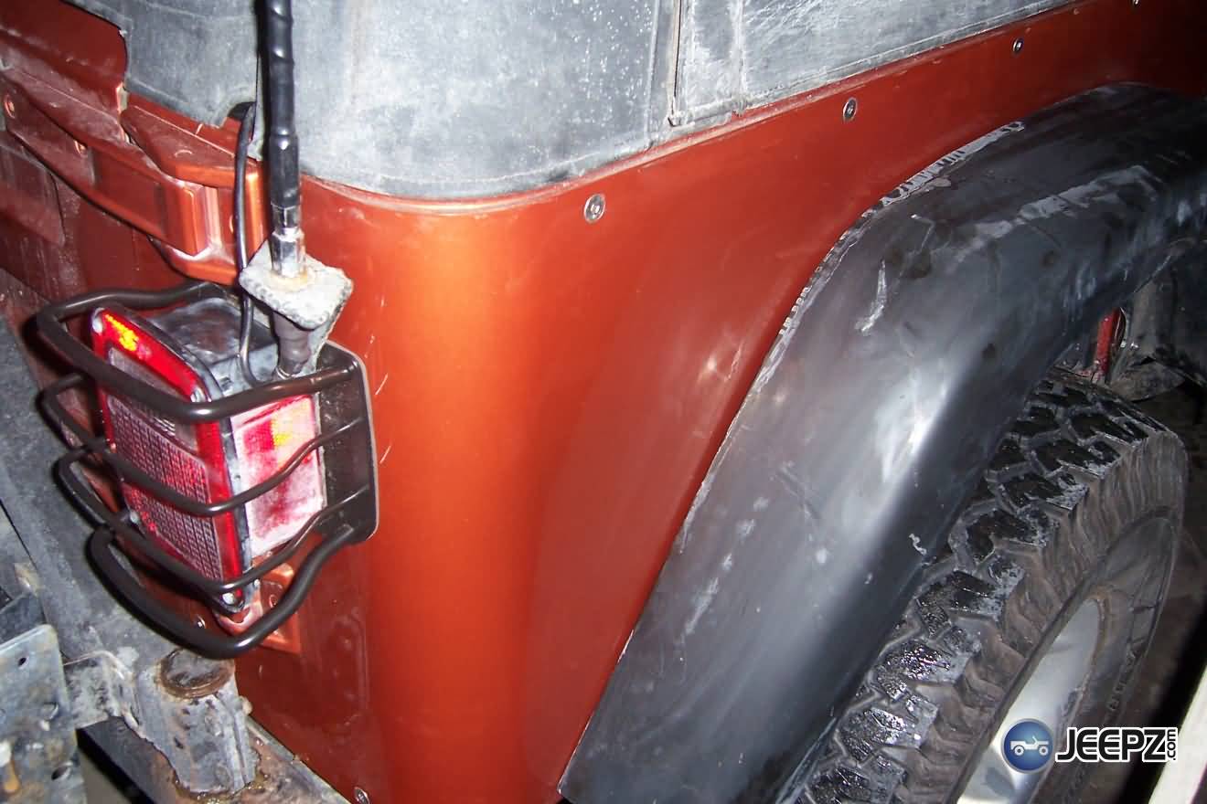

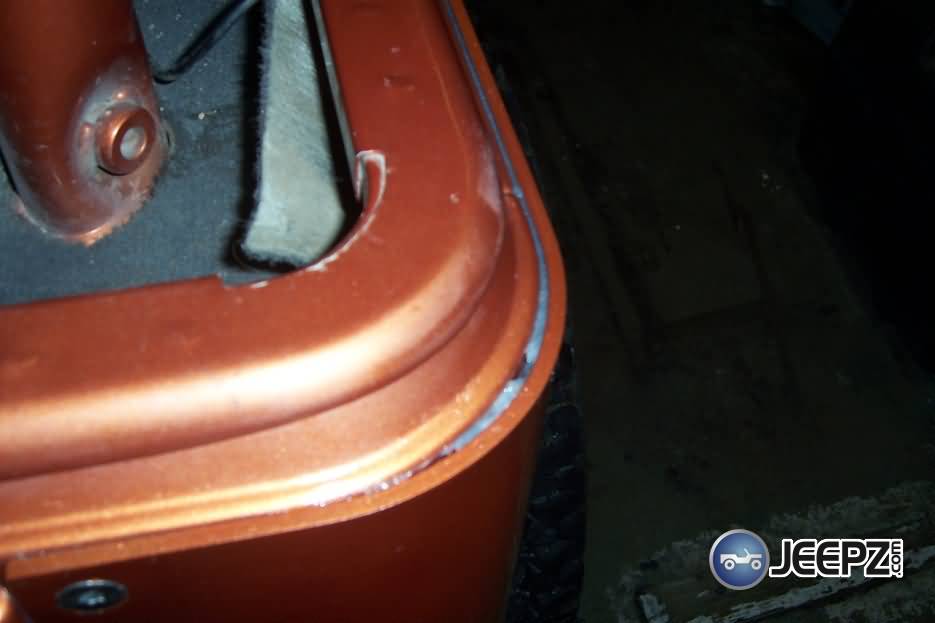

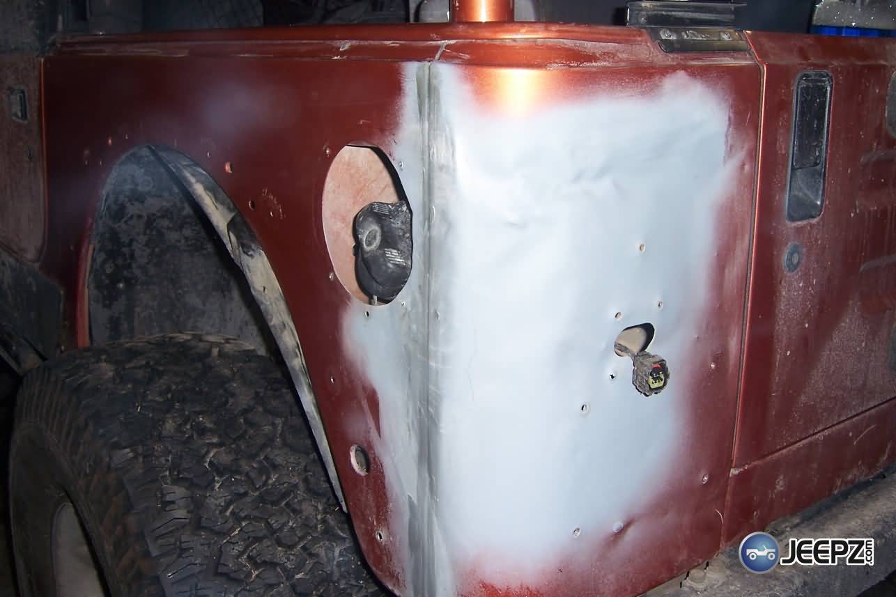

Step 1 - Repair damage and pull out the dents
If you are installing these on an undamaged Jeep, you'll want to make sure that the body is clean under the corner guards. In my case, I had a competent body works man pull the corner and re-establish the tail-gate gap I test fitted only one side panel. The instructions said to do both but after fitting the one side, and seeing the exhalant fit I for-gone the removal of the fender flare and tail light to test fir the right side.

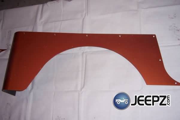

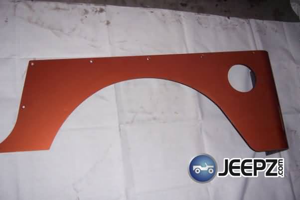

Step 2 - Paint corner guards
Then I had both of the panels professionally painted to match the unique 2001 color of my jeep. If your thinking of having them painted the same color of your jeep I would recommend that you do a full install of both panels and your fender flares before you have them painted. Since it was full winter I didn’t want to drive around with holes in my jeep for several weeks. On hind sight I think I should have done it.

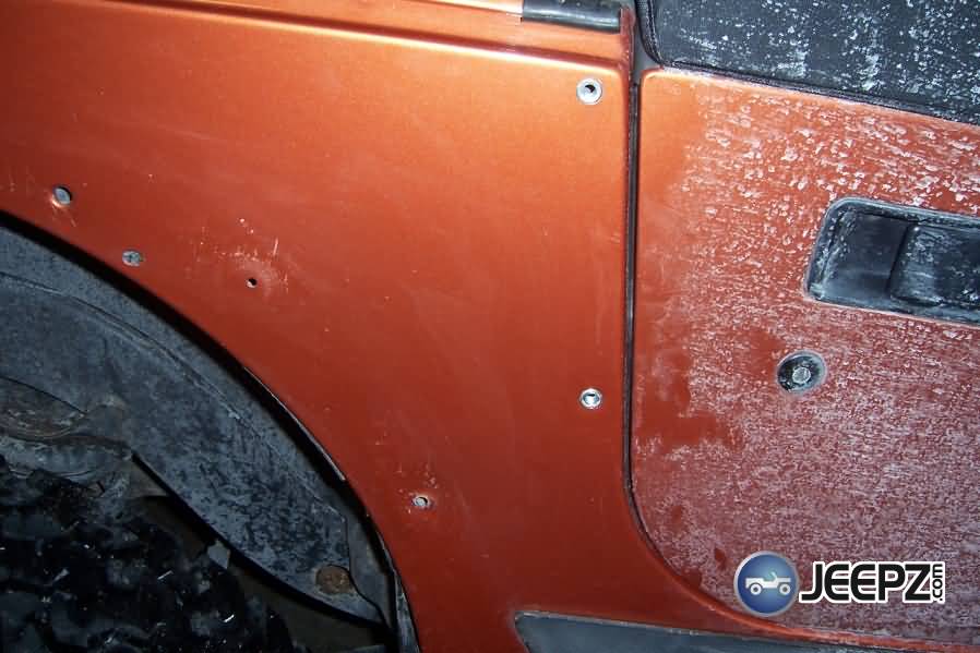

Step 3 - Strip the Jeep
Following the instructions, we stripped the hardware and fender flares off both sides of the jeep, and then did a thorough cleaning of the side panels with alcohol.
We also stripped all of the fender flare fastener hardware as well since we were going to drill and tap the panel itself later on to hold the fender flares.

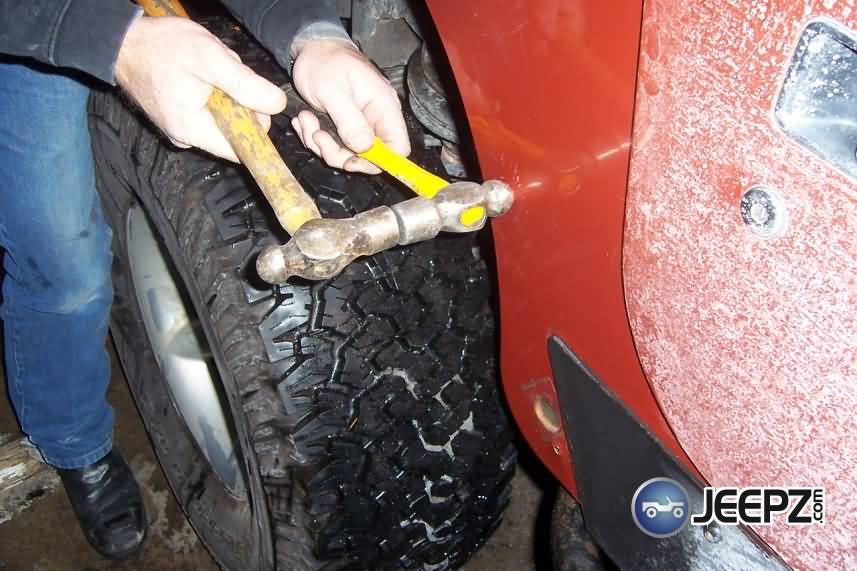

Step 4 - Flatten holes
Using two ball peen hammers we flattened the holes from the original hardware.

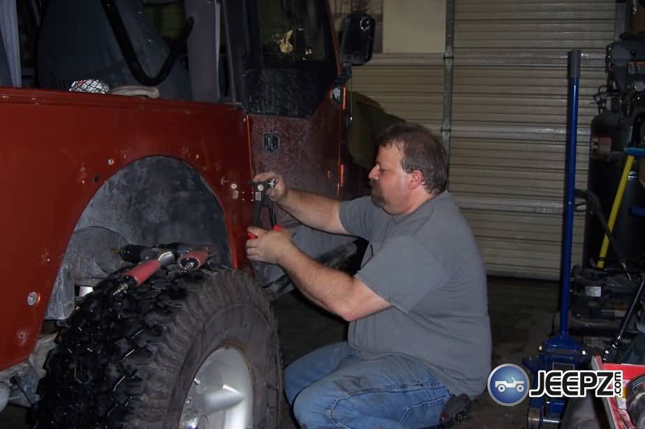

Step 5 - Drilling the tub
Then we set the first panel holding the panel on with carpet covered blocks and ‘C’ clamps and marked the first two holes.
Then using a ‘center drill’ then a ½ drill we drilled both locations.
If you don’t have access to a center drill , using a center punch or a smaller pilot drill will help you drill exactly where you marked. This is critical to get the first locations as close to center as possible since this will dictate if you will have any gap in the rear.
Once you drill the ½ holes don’t deburr them since the burr’s will help hold the two nut-certs you will install next.
Gen-Right provided a bolt and nut combination needed to install the nut-certs, we had a nut-cert gun so we used it.

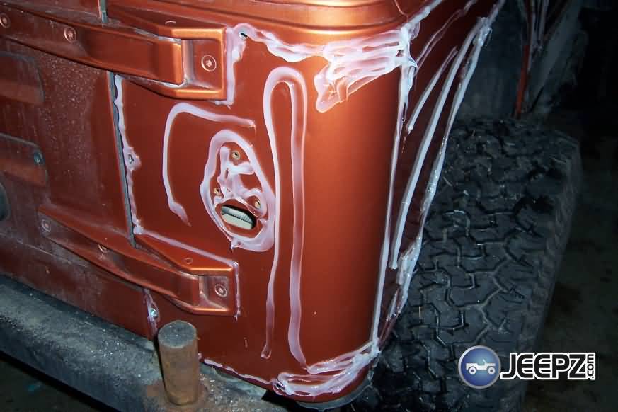

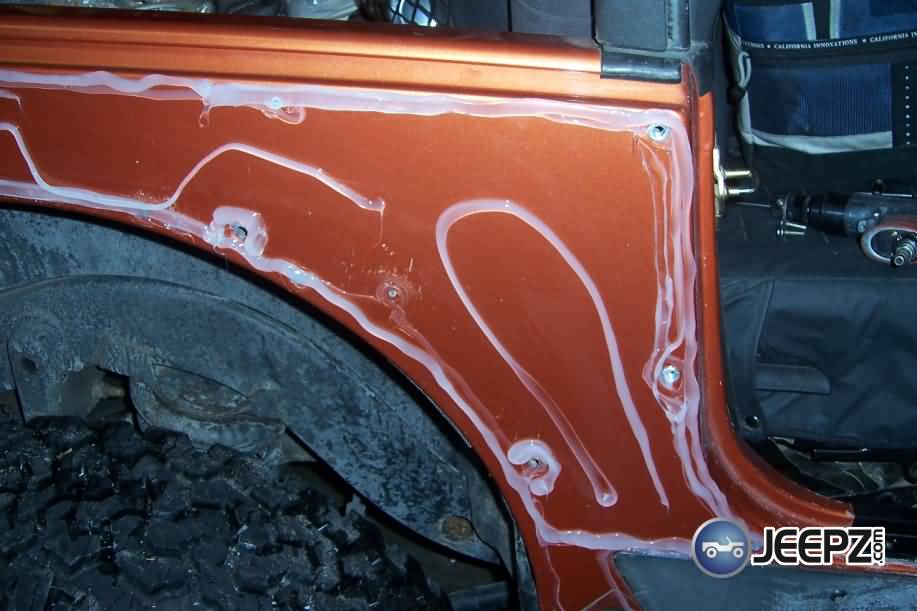

Step 7 - Cleanup an apply silicon
After one more test fitting we went down the line drilling each location, then loosely bolting them in to move the clamps. You do this till you get to the back of the jeep where you’re going to have to put in one more nut-cert, drilling and fitting from the front allows you to make sure of your final alignment on the rear of the jeep.
Once you have it all drilled , we deburred the smaller holes with a chamfer tool both sides and touched them up with several coats of primer sprayed onto a ‘Q-tip’ to reach inside the holes.
Then we applied a hole tube of clear silicon sealant (more than we needed) around every surface to seal the Gen-Right panel to the jeep making sure to cover all the openings around the tail light holes.

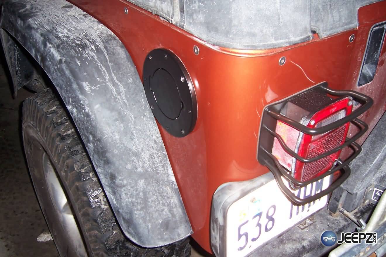

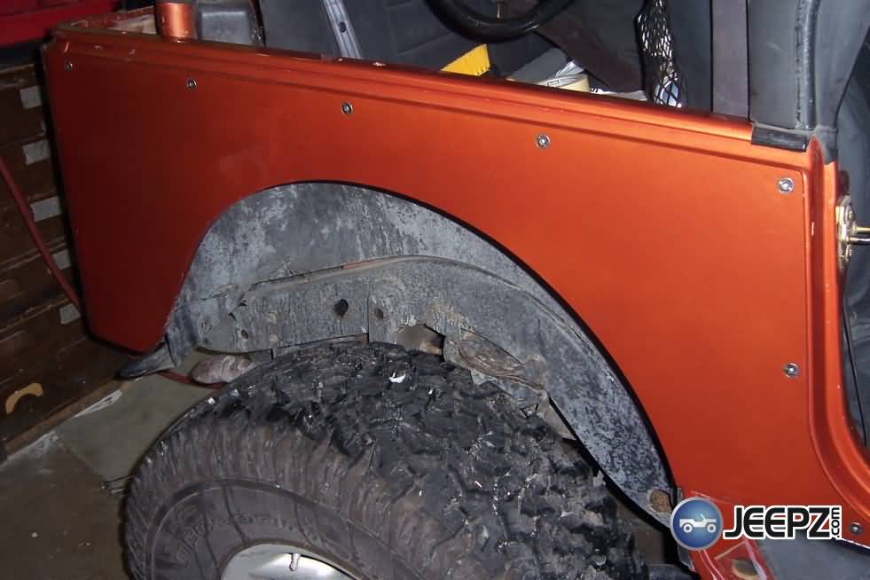

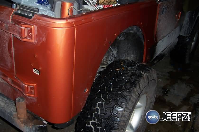

Step 8 - Reinstall the corner guards and bolt back up
Then reinstalled the hardware tightening them in the same order we drilled them so the panels will fit exactly.

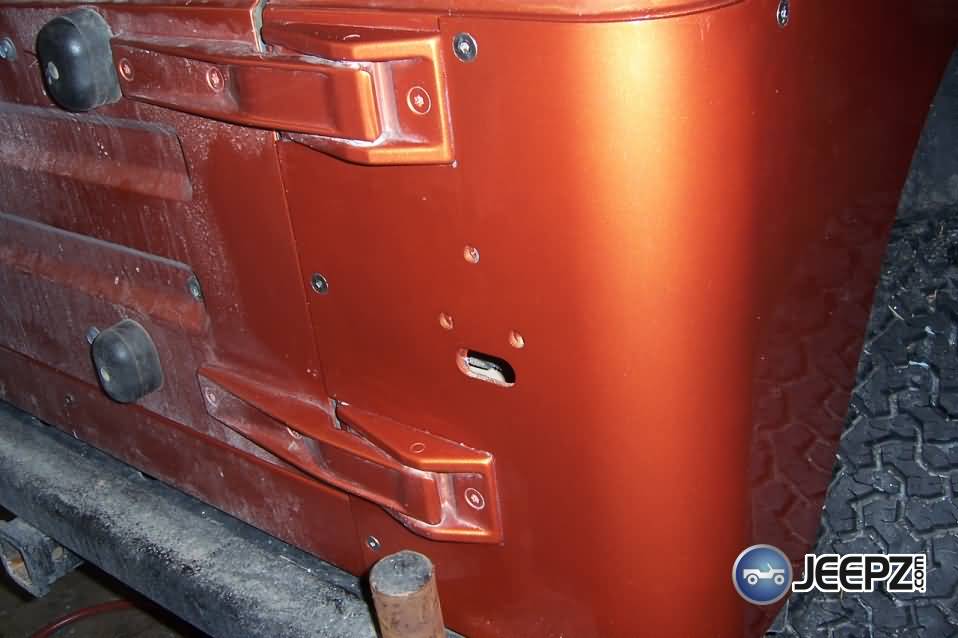

Corner Guard Fitting
Notice the great fit of the panel and the door hinges, this was something we worried about since we didn’t test fit the panels earlier before we had them painted.
This is why the instruction said to, if Gen-Right didn’t make a quality product we would have been sanding on painted panels and had to touch them up ruining a fine paint job.
If we had test fitted them I think we could have pulled the gap at the upper radius a little tighter.

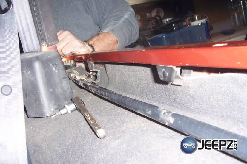

Electricial concerns
The first panel took us over three hours due to the fact it was drilling into my jeep for the first time.
The second side took us considerably less time since we had the theory down, the only thing you need to do beyond what you all ready done is to make sure you pull the rear electrical tube (holding the rear wiring) out away from the tub so you don’t drill into it.

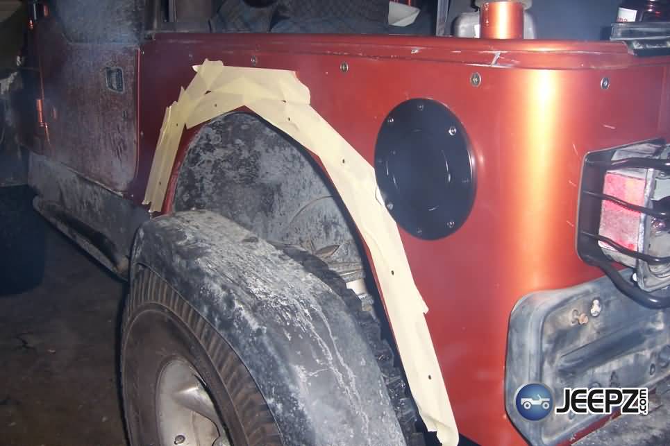

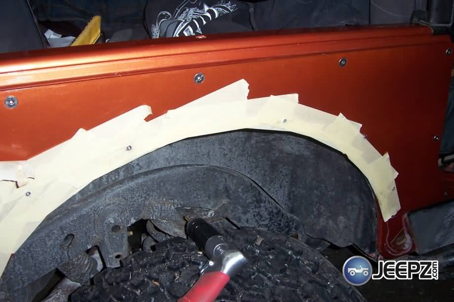

Step 9 - Reinstalling the fender flares
Next we masked off the fender well and clamped the fender flare in place.
Then we drilled and tapped for a ¼-20 screw.
We also attached the tail lights and license plate holder bracket in the same fashion.
