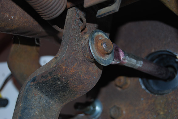

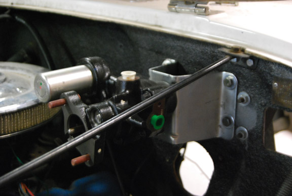

[FONT=&quot]Align the new unit against the firewall with the hydroboost reservoir to the top. Measure the distance to your brake pedal and mark new holes for the unit. (It helps to have another person help you with this.) I needed to cut out about 2” (if I remember correctly) of the plunge rod and weld the ring end back onto the unit.
[/FONT] [FONT=&quot]The plunge rod; cut, re-welded, and installed.[/FONT]
[FONT=&quot]
[/FONT]
Be sure the plunge rod is long enough to keep the pedal extended.

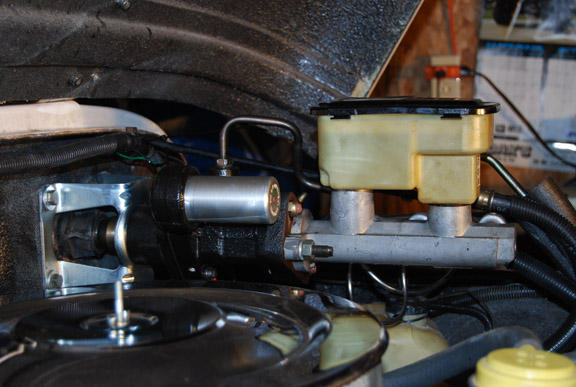

Drill the holes in the firewall and mount the Hydroboost unit.

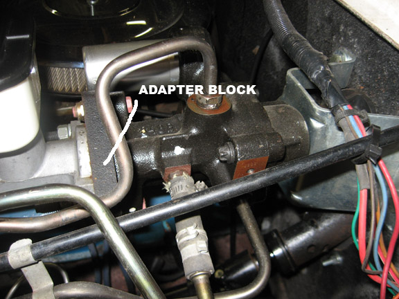

I needed to place an adapter block between the hydroboost and the master cylinder as the unit had mounting holes at 30 degrees and the master cylinder has holes horizontal. (Again, get a COMPLETE unit so you have everything you need)
Attach the master cylinder and reservoir.
[FONT=&quot]Attach the brake lines.[/FONT]
  • Adapter block.psd
    Adapter block.psd
[FONT=&quot]I needed to place an adapter block between the hydroboost and the master cylinder [/FONT]
  • Adapter block.psd
    Adapter block.psd

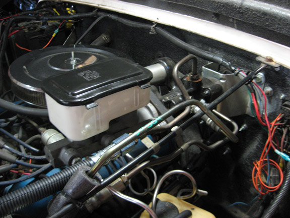

Attach the hoses. (A power line from p.s. pump to hydro unit; power line from hydro unit to steering box; return line from steering box and hydro unit (tee them together) to the p.s. pump) I used my stock p.s. pump and steering box from my old AMC 360.

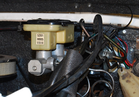

The biggest hangup in my install was the reservoir. I got my unit all together and tried to shut the hood, but the reservoir was too tall. I cut a ¾” piece out of it and glue the two pieces together to make it shorter. All three times that I epoxied, super-glued, etc the plastic together, the brake fluid dissolved the glue. So, again to the internet I went to find a smaller (in height) reservoir. My choice was a PBR Brake Master Cylinder (part # W0133-1621626; Available from Auto Parts Deal or Auto Parts Warehouse).
New PBR reservoir installed. The hood now closes.

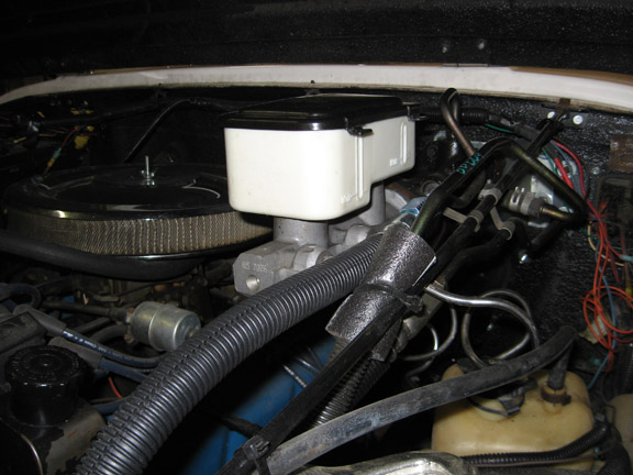

This is a pic of the final installation:
