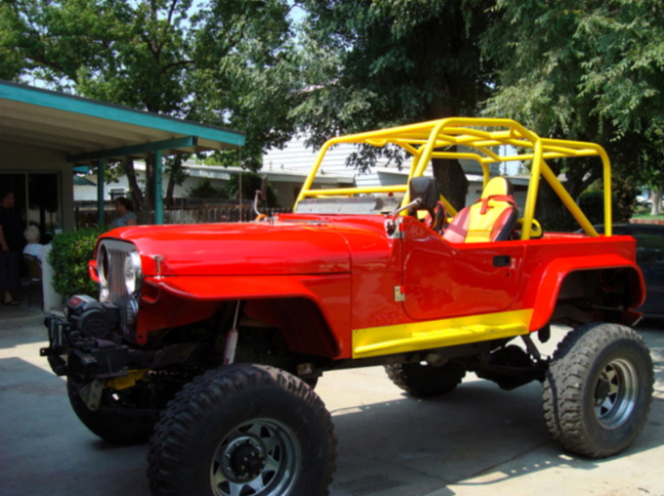

Been working on my Jeeps 2nd rebuild for almost 2 years now(working on it a little at a time).
Got it almost ready to hit the trails again.

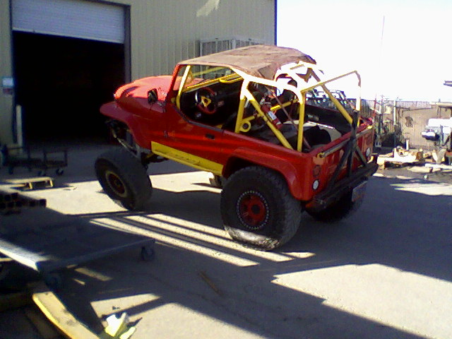

Here are a few updated pics of my POS.

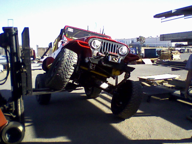

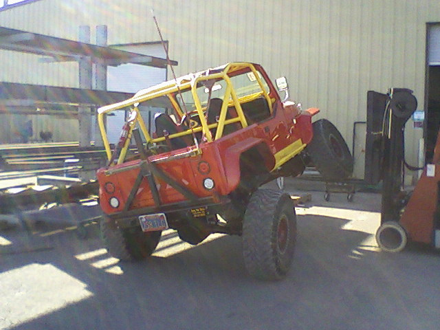

I took it to work and did the forklift flex test to check things out.
Front DS rubs on the exhaust,rear DS is to steep of an angle,CV went out in 200 miles.
Still got some bugs to work out but getting there.
