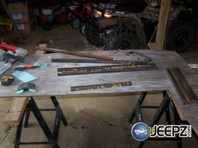

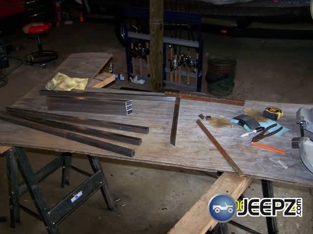

Piecing together the rack

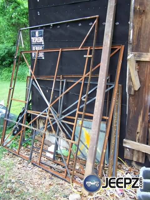

A buddy of mine gave me some steel of various sizes that he didn't need. The majority of it went to a trailer I built for my 4 wheeler. I used part of the rest for a Rock Rack.
The 1" tubing came in handy and was just what I needed to start building.

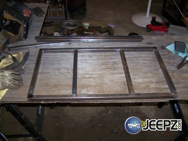

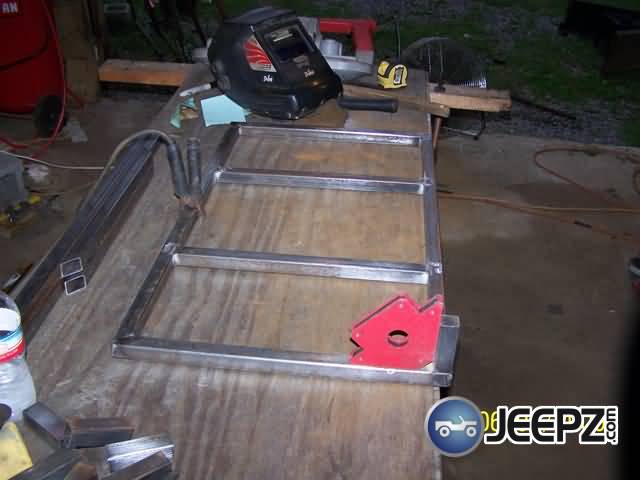

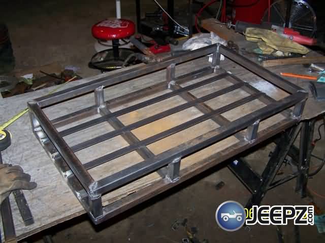

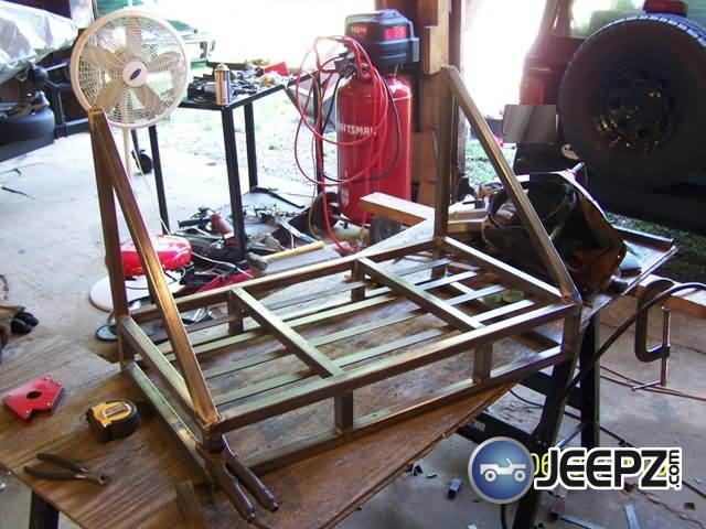

Laying out the new rack
I cut some peices for the dimensions I wanted and built the bottom frame. I made the center braces to where they would lay flat on top of my spare tire. Then cut out 3" long supports for the upper part of the rack. and started welding them in.

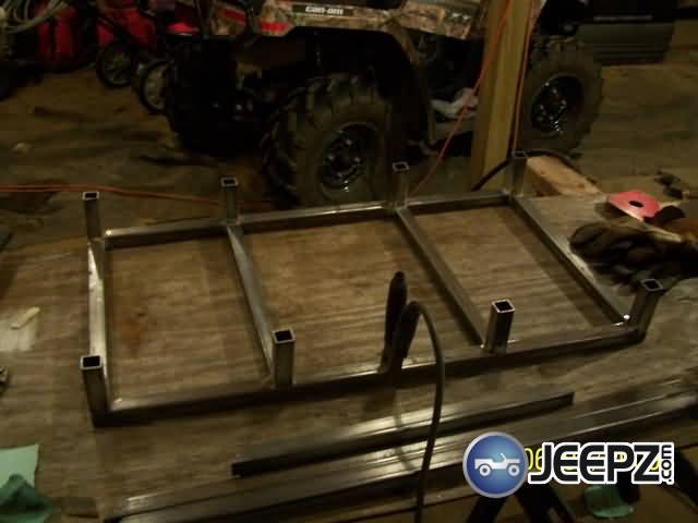

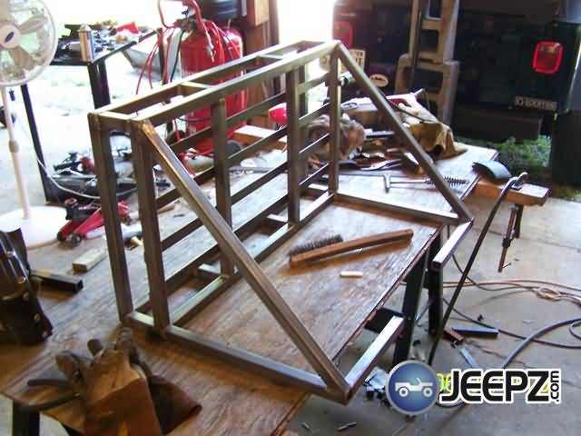

Rock Rack is coming together
After I had the main frame, I used some of the 1" flat steel to make a bottom. I then built my supports and layed out the mounting arms.

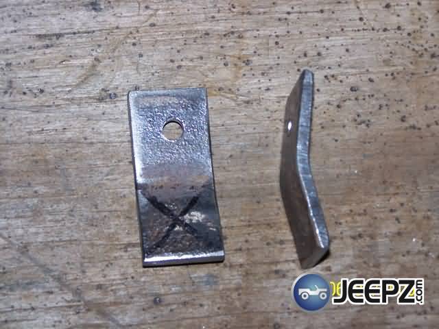

Rock Rack mounting tabs
I had a small peice of flat plate that I used to cut out tabs, Bend, and drill holes for mounting points.

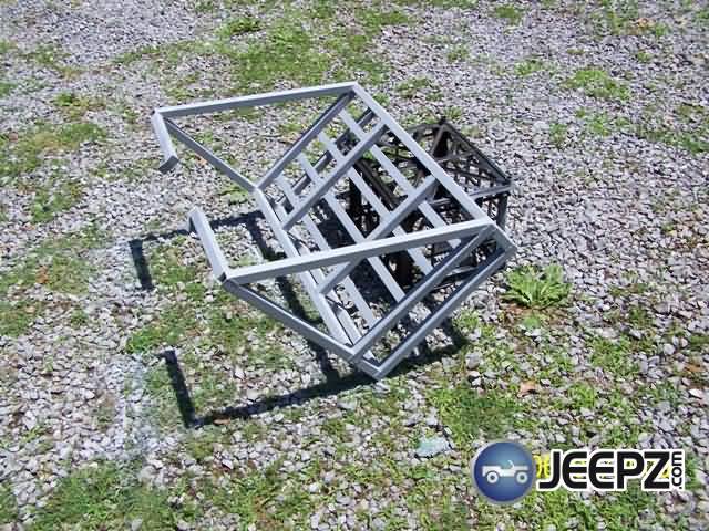

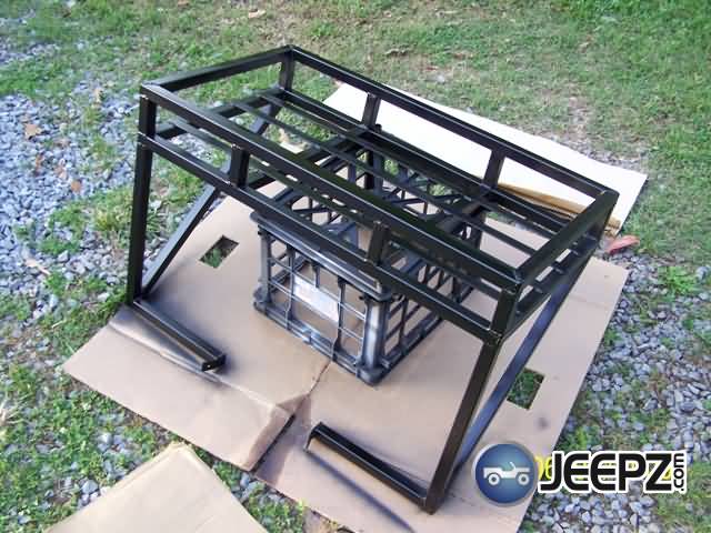

Painting the rack
I welded the tabs onto the ends of the mounting arms, primed with several coats and then rattle canned black. All in all, I thought it turned out pretty good considering It didn't cost me anything and I made it myself.

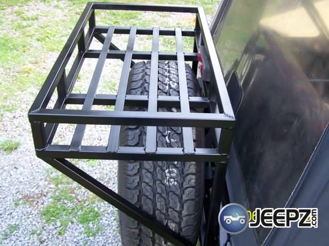

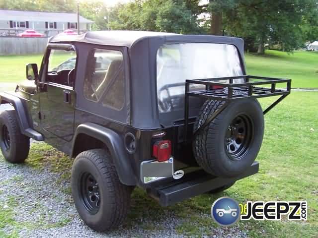

Finished Jeep Rock Rack
And the finished product

Where did you attach it to? It seems that there's only two mounting points/tabs.
Does the spare tire carry any of the weight? In other words what keeps it from tipping back?
Thanks Guys!
I attatched it to the main tire carrier which holds part of the weight and yes, it lays flat along the top of the spare for strength and support too. One of the main reasons I made the mounting tabs in behind the spare is to help detour theives. You would have to get the spare off, then get in there and try to get the bolts loose inside the tire carrier.

So the whole thing opens with the tailgate, That's not a bad idea!
I already have a hitch mounted rack like you see on the road, with three ice chests on it. Only I made my own years ago & it can haul a complete small block mopar engine. I moved my spare mount from the T-gate down to it. Still have room for a cooler on each side of the spare, & three bolts hold the tire mount to the rack if i need the whole rack for something.
I'm interested in follow up.
The concern that I have is pretty simple - the rear door hinges can carry only so much and that's also an added stress on the lock mechanism. How are they doing so far? I can see how it can be easily done with custom bumper application where weight of the tire is relocated onto the bumper but the case where both of them are hanging on the door kind of makes me wonder how long for.
