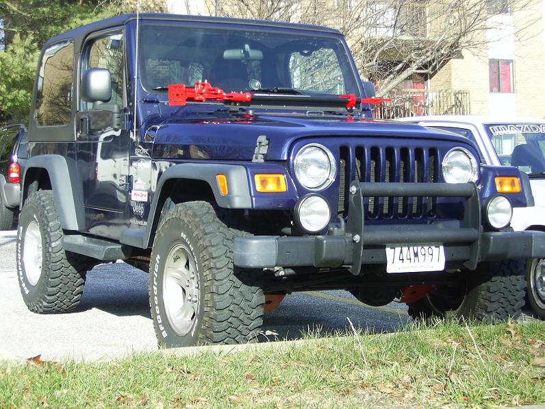

I got a Hi Lift jack and a Tough Stuff hood rack for Christmas, and I was just wondering if it would be ok to leave the jack mounted on the hood. I'm concerned about rain/snow rusting or otherwise damaging the jack. Are there any precautions I should take, or will the jack be ok out in the elements?

So is the red powder coat that it came in not good enough?
Edit: Now includes picture!

You never mentioned it being powder coated from the factory and I didn't know it was.
I do know that I build a small line of truck accessories and I have a local powder coater do all of my steel for me and some of them have been out since last March in the 5th wet-est year in history for our area and no rust.
now if you chip powder coat, if you don't touch it up, rust will start.
I had my hi-lift on the front of my bumper and rock chips were bad and I had to touch it up every year.
as long as moisture stays away from bare steel, you'll be fine.
If you jack is factory powder coated, I wouldn't worry about it:D
in a few years you might have to do some touch up, until then....don't sweat it;)

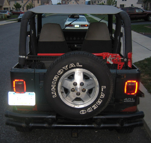

If you're overly concerned with rust and exposure to the elements, you could buy a black plastic case to put your Hi-Lift jack into. Quadratec.com sells them, as do other suppliers. I don't know if a case will fit your hood rack, but it's worth looking into.

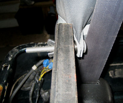

My farm jack (not the Hi-Lift brand, but same design and function) is mounted to my rear uprights of the roll/sports cage. Total price for the parts was around $10. Plus, the soft top and hard top fit over the mounted jack, protecting it from the elements (when a top is on, of course).

can you explain how you mounted that. i got a 48" for christmas, and this is exactly what i was looking for.

I've got mine mounted like dandoc's, and it has always worked when needed. The majority of jacks I see mounted on the outside generally fail when needed most. Mount it inside if you want reliability from your hilift.

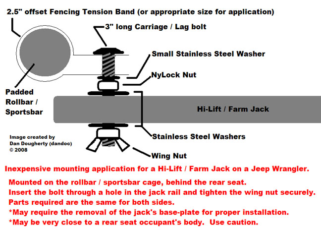

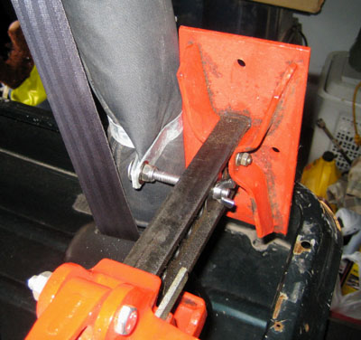

I can't remember where I read about this inexpensive method of mounting a farm jack, but it certainly works! Your local "we've got-it-all" hardware store should have the parts necessary for the job.
Note the limited available space around the edge of the base-plate and the inside lip of the Jeep tub. To avoid potentially tearing a soft top, and to ensure you can remove the jack with a hard top installed, I suggest removing the base-plate and storing it elsewhere in your jeep. Enjoy! :-)

Did mine with ubolts and wingnuts, but same idea. Mine is out, used, and put away while others are still working on getting their jack out.

awesome, i have been looking at all the possibilities of where to put it, and this is exactly what i was looking for. thanks
