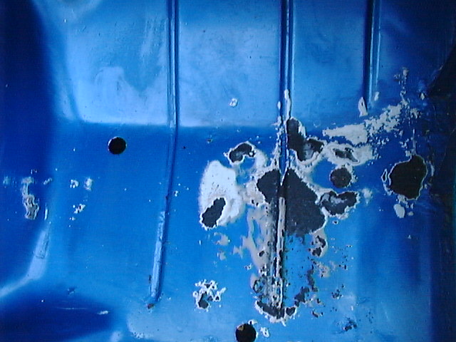

Step 1 - sand the floorboards
This project is pretty straight forward, first sand down your floor pan well., removing any rust or other major bumps.

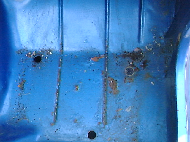

Step 2 - clean
Once sanded, you'll need to wash and carefully clean the floorpans, so there is no dust or grease. Herculiner won't stick well to a dirty or dusty surface

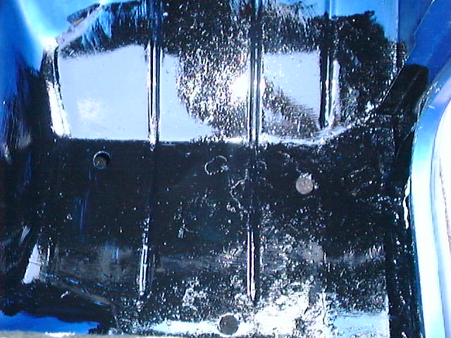

Step 3 - protect
I chose to give the area a coat of POR 15, a to keep the rust from coming back. I cant' say enough good things about POR 15. Having used it for years, it's the best rust stopper on the market.

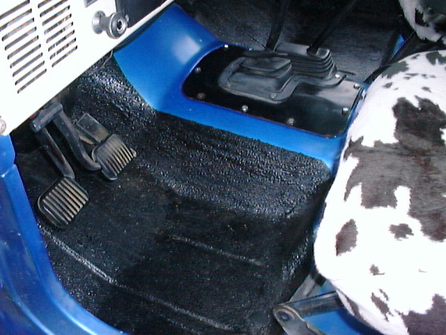

Step 4 - roll on the Herculiner
Finally roll on the Herculiner, give it a couple hours to dry, and put the second coat on. Really nothing to it!
