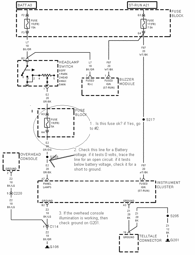

The instrument cluster lights on my 96 Cherokee do not work. I pulled the cluster, checked all of the 8 bulbs, checked to make sure the harness and plug were tight, and also checked the fuses but still get no lights when I turn on the headlights.
The dome light works when turned on but no lights when I turn the rheostat in the switch.
Any suggestions on what next to diagnose and fix would be appreciated.

Here's the wiring diagram with instructions. see what you come up with.
