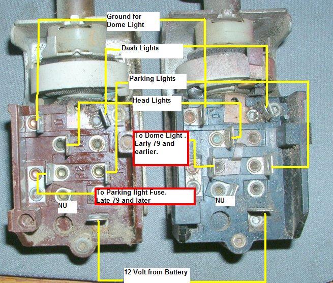

Here's a diagram of a CJ switch

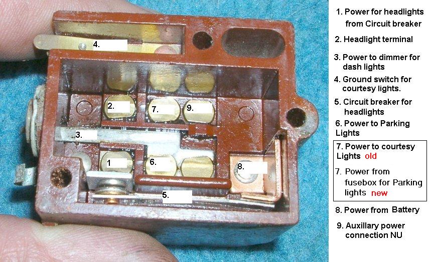

Here's kind of a neat one. These pics are compliments of John Strenk.He puts a lot of work into them

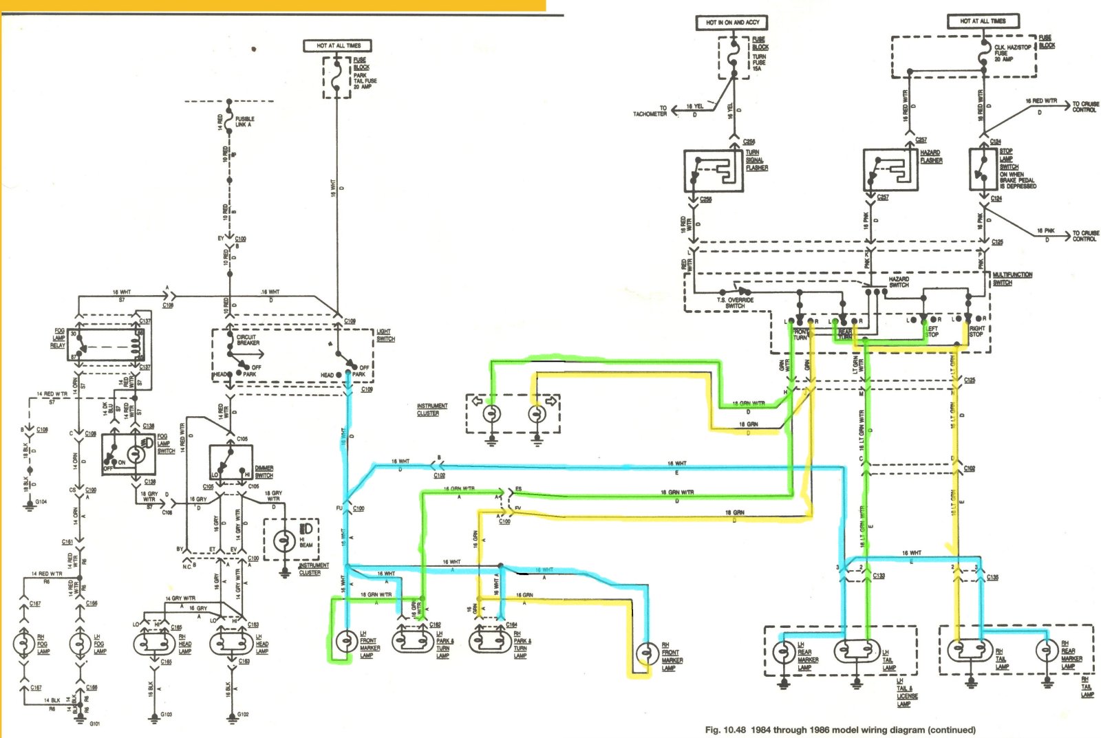

Here's a better print for 84
