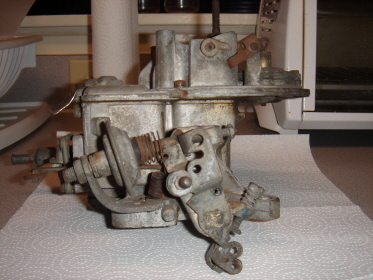

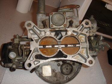

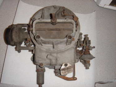

Today I went looking for a replacement motorcraft carb and after shopping around for a while I found one and bought it. The guy told me it came off a 68 ford V8, the venturi reads 123 or atleast I think its the venturi. Its going to go on a 4.2 89YJ and I know u guys recomend a 108 venturi, Is this going to hurt performance? should I change something? The carb seems to be in very good condition and moves freely, There is a broken little steel connector that helps open the air trap door, Is this carb gonna work fine???

It outta work ok, but with 1.23 venturi you're gonna be running rich unless you've modded your engine. You might get away with it like it is, you might try rejetting it, and worst case scenario you might not get it tuned and have to try to find a 1.08 or a 1.14. Click on my username and "find all posts" and you'll see some recent posts that will include links for doing the swap. Good luck.
That's about right as far as price goes. Put the carb on and see if you can get it running first. Check what you have now and if it's running rich you know you need to get 3 sizes that are all smaller than your current size. Mine's got 47's so I'd probably get 43,45,46. One of those should work and doing it that way will allow me a little more room to work with when trying different sizes. If you take the top off of your carb (6 phillips screws) you'll see the bowl (has a float in it). Take the float out (after looking at how it's mounted so you'll be able to put it back together) and the jets are screwed into the bottom of the bowl. They have a number stamped on them. Get the carb going and if you're running rich go smaller than you currently have. You don't want to go too small so go down in small increments. You might check with that seller and see if he'll sell you more than 3 sizes and give you a price break if your stock set of jets doesn't end up working. To answer your question, I'm not really sure. I know people have used the 1.21 and it's worked ok so you SHOULD be ok. Rejetting will decrease the fuel flow to some degree but it's not going to greatly change the amount of fuel you're getting.
