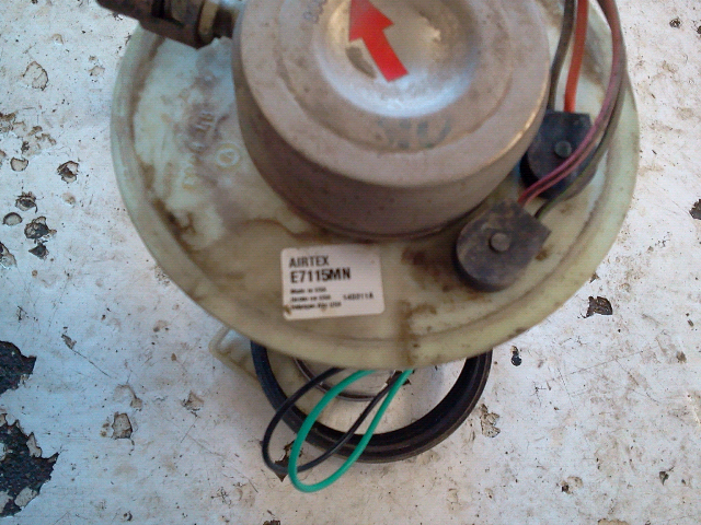

Final post on a lengthy problem...its not the fuel investors...but the fuel pump...in back posts some of you said fuel pump so pat yourself on the back.lol...the pump was only putting out about 23psi. The pump that was in there was only about 3-4 years old...the mechanic said he has seen alot of them go bad and basically they are a piece of crap. So here is a pic of it so maybe you can avoid it in the future.

Good news...got my jeep back and its amazing how much better it runs...new fuel pump and 4 new injectors. Its throttle response is what it should be, shifts when it should and starts up right away. Thanx for everyones help in getting this fixed.
