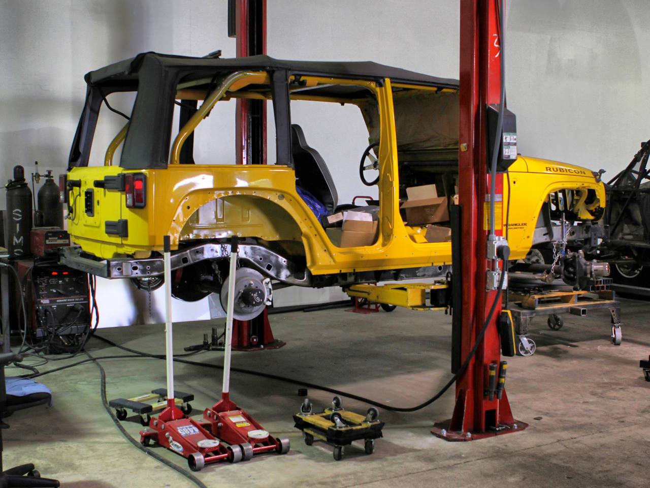

GenRight completely guts a Yellow JK for MAJOR overhaul!
GenRight Off Road

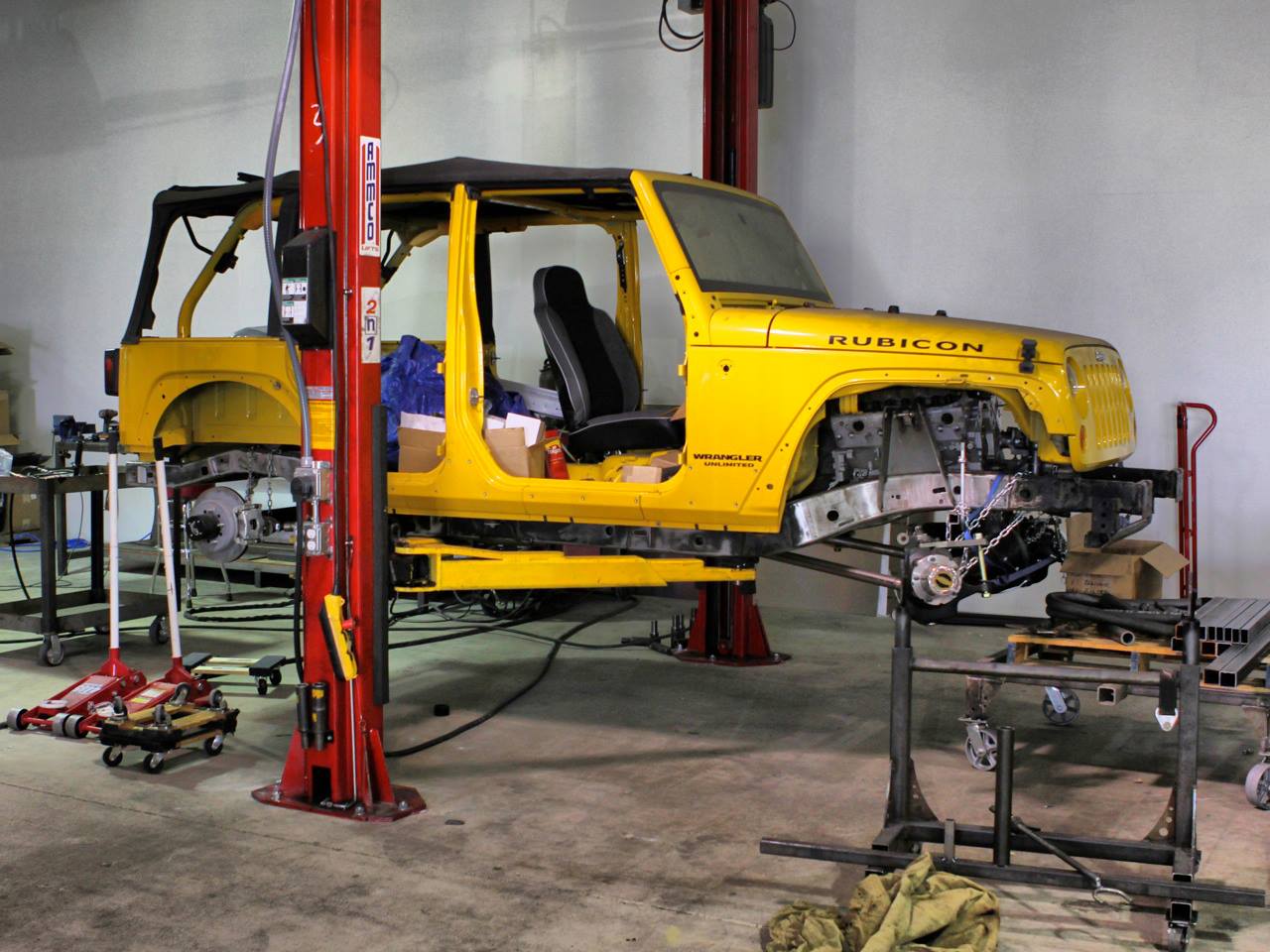

GenRight is setting out to build the best JK the off-road industry has ever seen!!

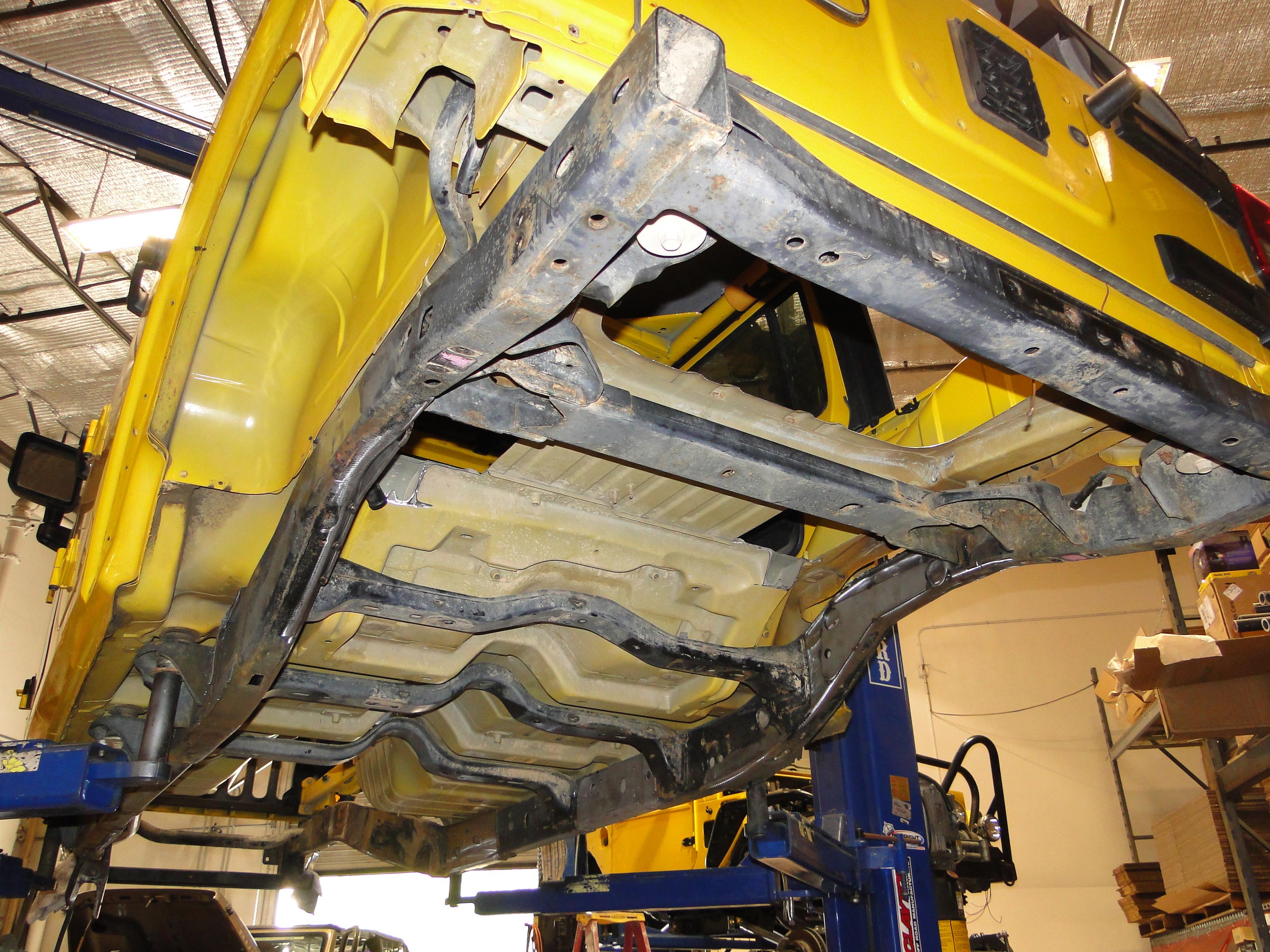

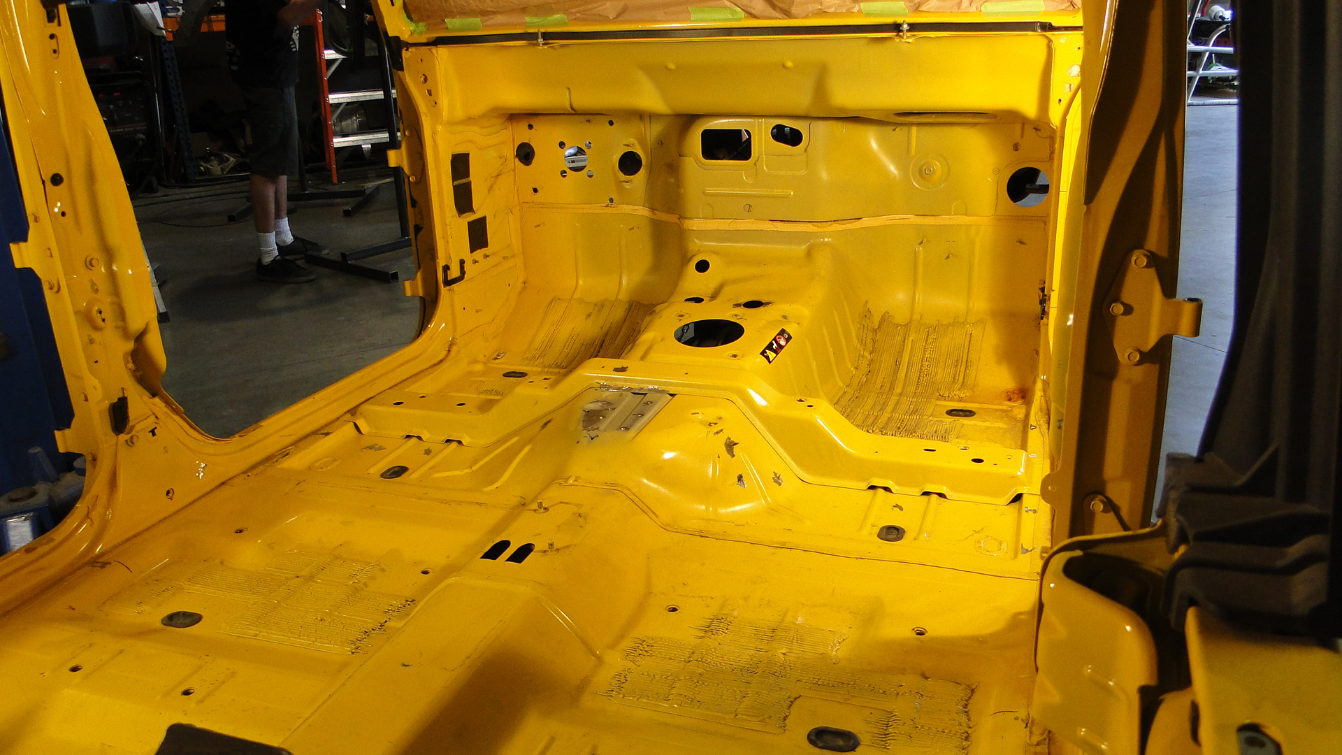

The team completely gutted a 2008 Jeep JK Rubicon!!!
- No dash!
- No engine!
- No wiring!
- Nothing factory of any kind (except for the tub and frame)!
What's the plan?!
- Hand built & soup'd up 625HP Chevy LS3 V* engine with a TCI built 4L80 transmission
- Atlas transfer case
- Currie Rock Jock 60 axles

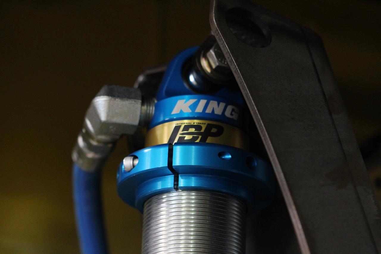

- Our GenRight Elite double triangulated 4 Link suspension system with King 2.5" IBP shocks
- 40" Goodyear MT/R' on Race line beadlock wheels

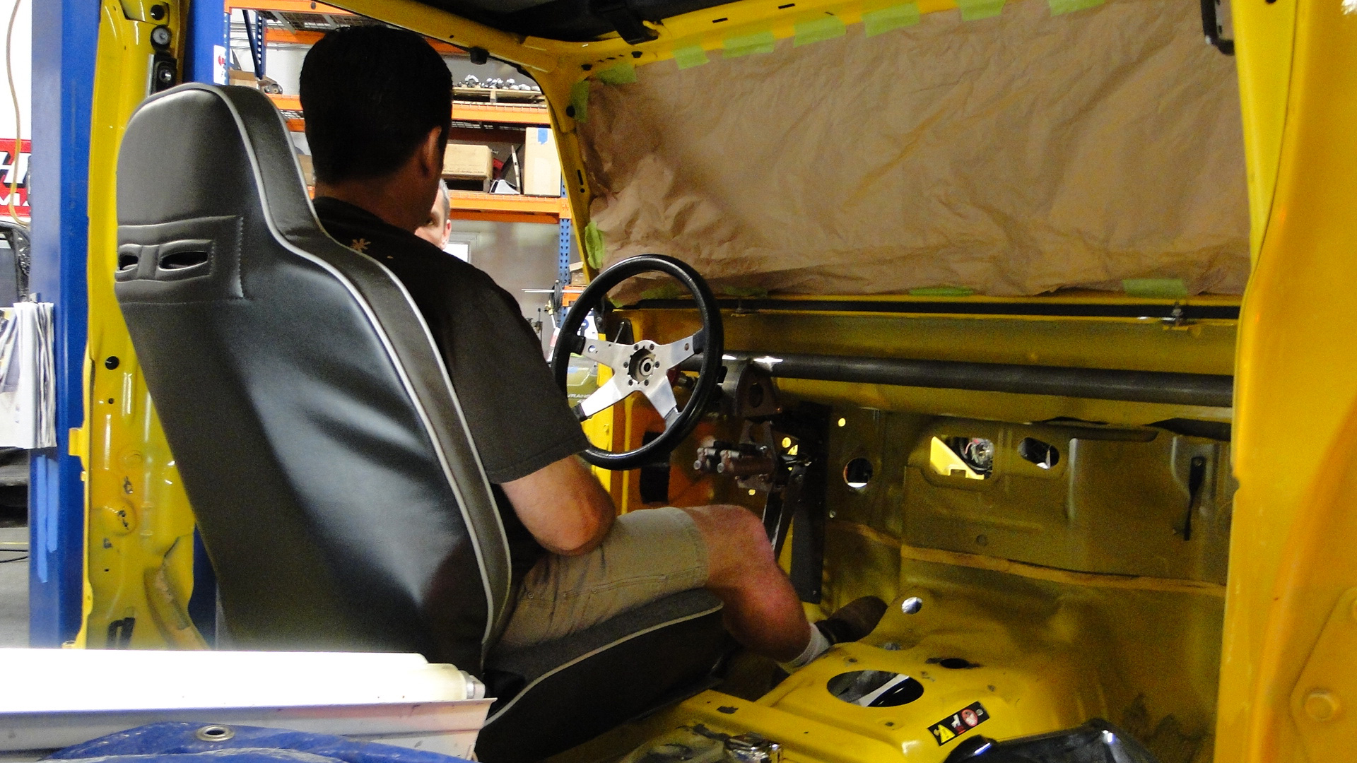

It will have a completely custom built interior:
- Aluminum dash
- RacePak digital readout
- 8" Lowrance GPS
- Race radio, etc.
- (4) PRP bucket seats
- A custom GenRight roll cage
- and much more.....

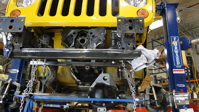

a few teaser pics:

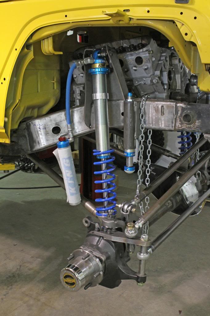

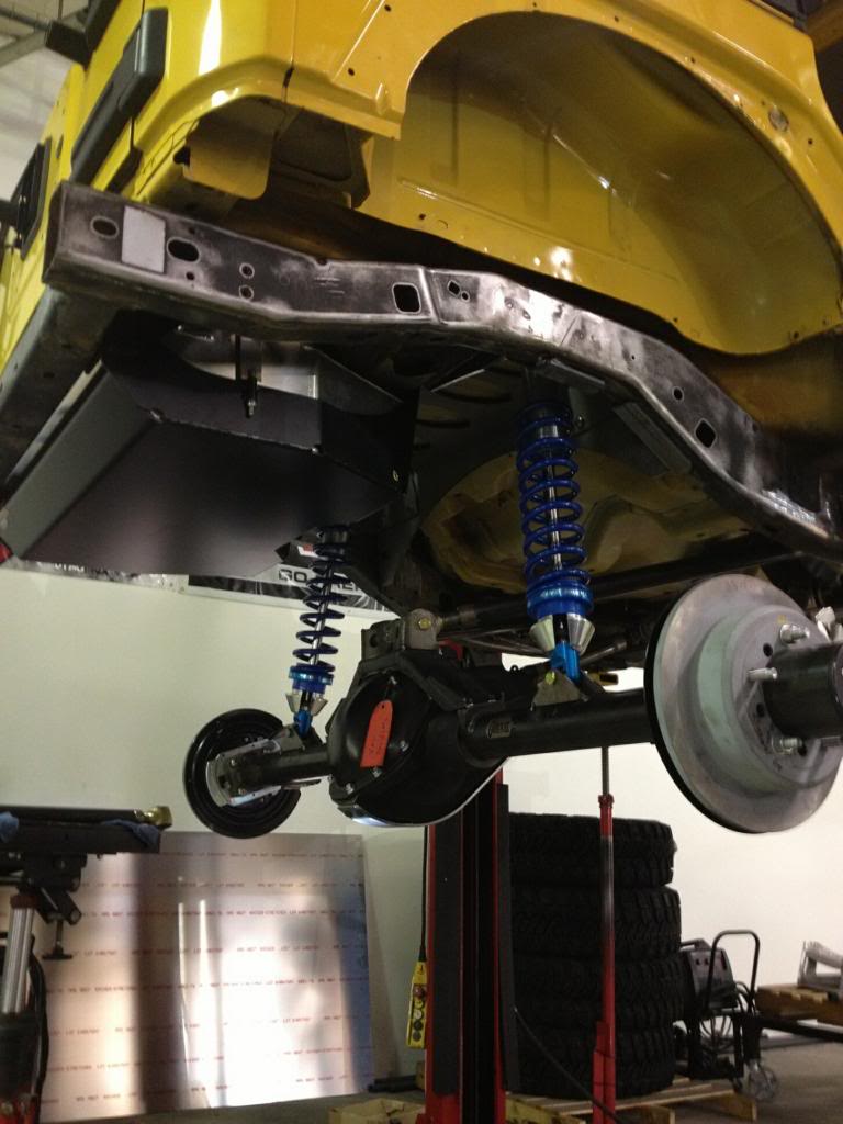

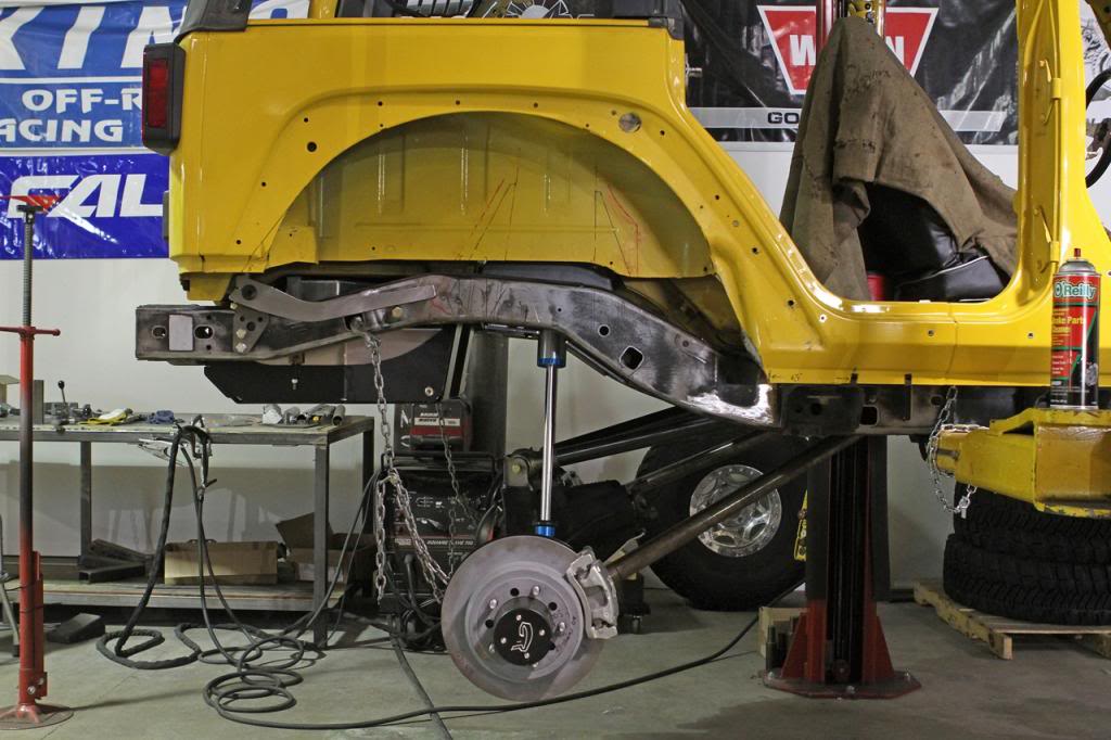

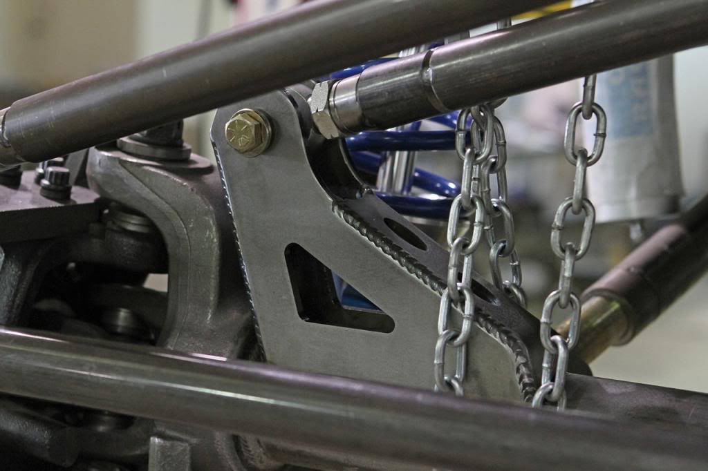

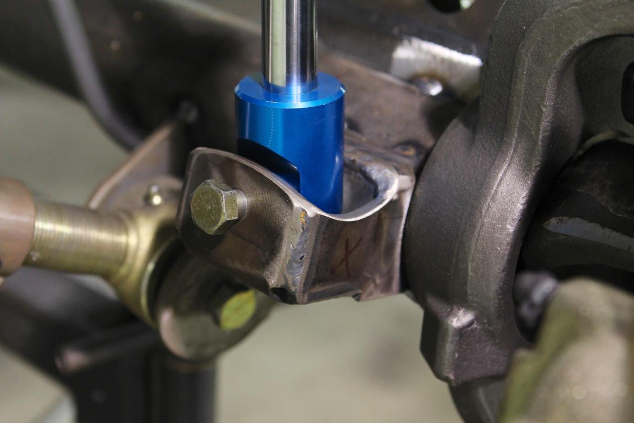

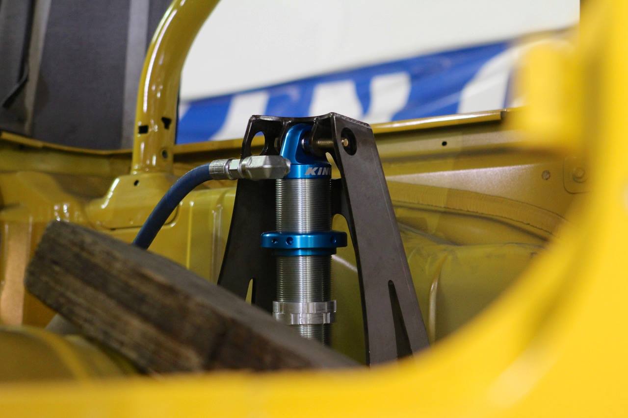

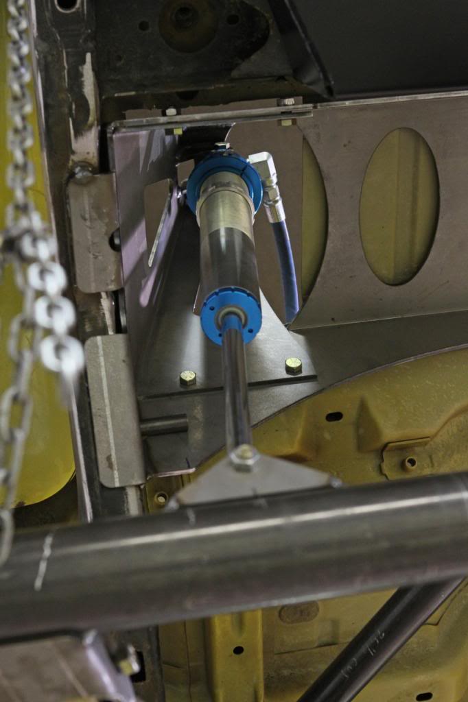

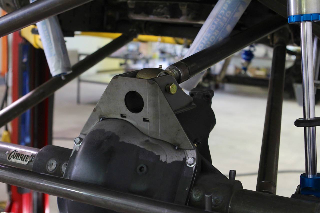

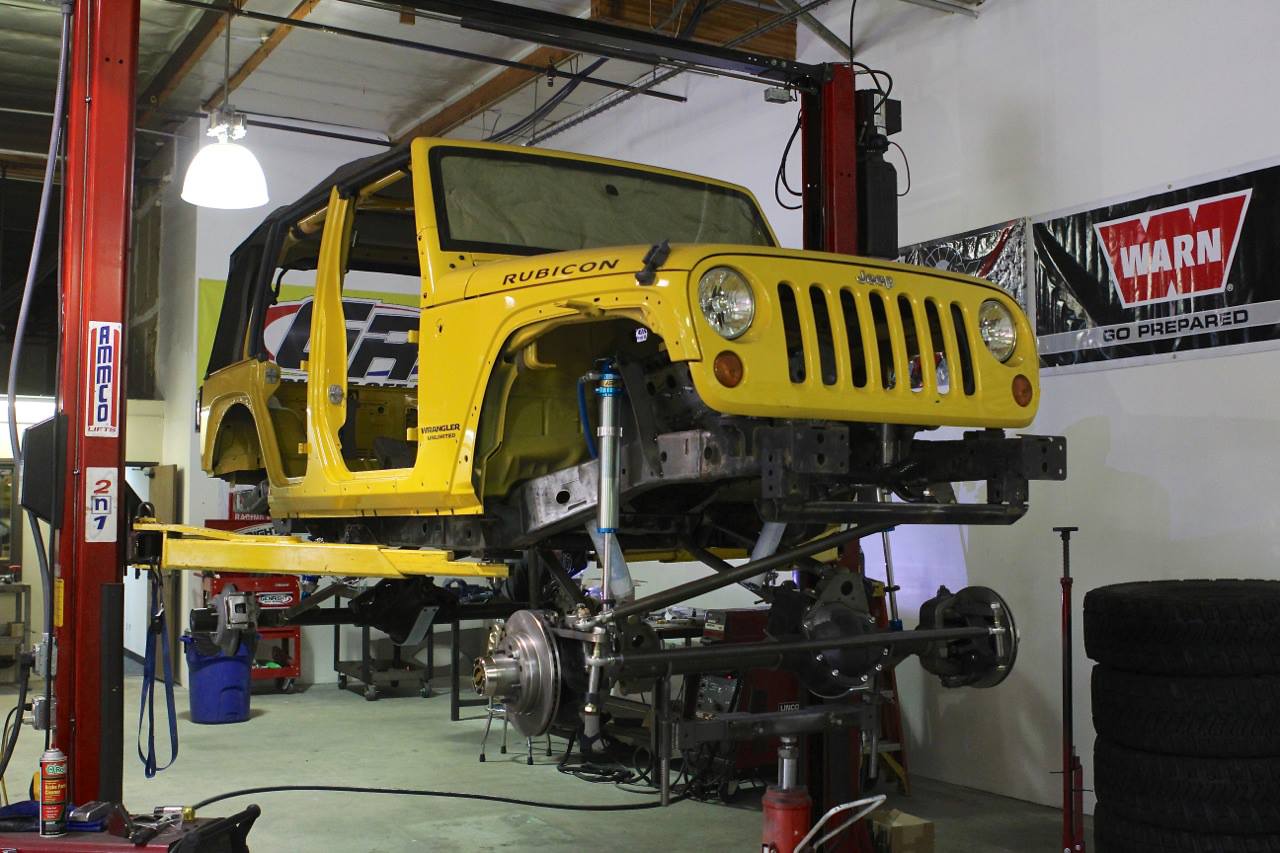

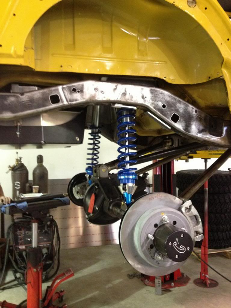

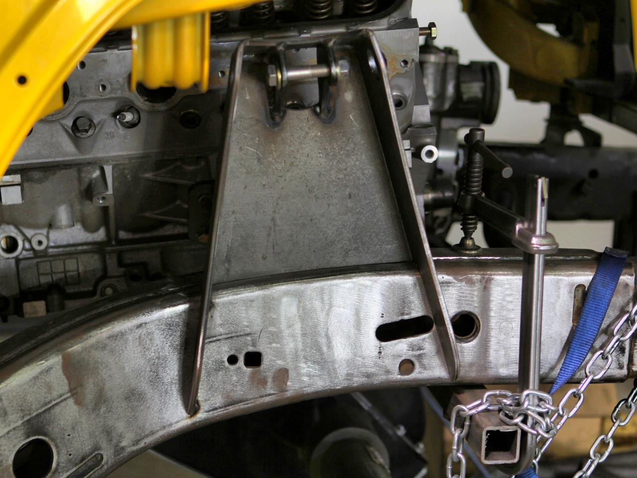

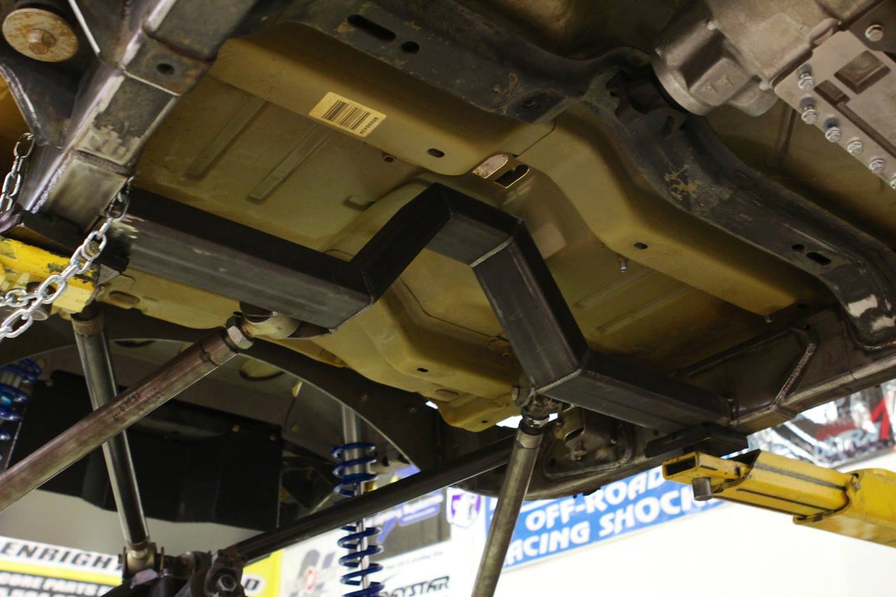

Axles are in place, rear suspension is almost done, front suspension is in the works, JK gas tank and skid are in place, and the "test fit engine is out with the overhauled engine in place! Here are a couple suspension teaser pictures:
And the build continues! :D

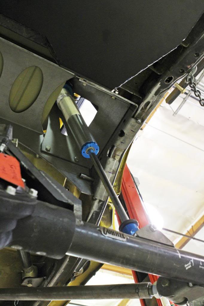

And a couple more
