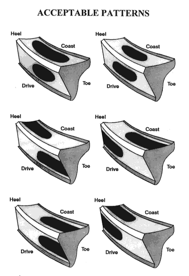

Would this help?

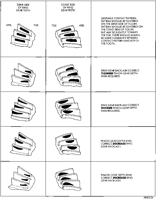

Well, I already have one, or 10. I'll use that for an example, though.
My drive wear is the top left pic. Then for my coast side, it looks similar to the third down, to the right.
I'll mess with my backlash today and see if I get anywhere...
Ok gentlemen. It looks like I have hope. Steelheadz, http://www.ringpinion.com/Content/Book/Reading_and_Adjusting_Ring_and_Pinion_Tooth_Patterns.pdf this could be very helpful for when you get into your axles.
It turns out that for used gears, you are supposed to get a nice pattern based on the coast side which is used less so an accurate setting can be made. Also, there are a variety of acceptable patterns. Take a look!
