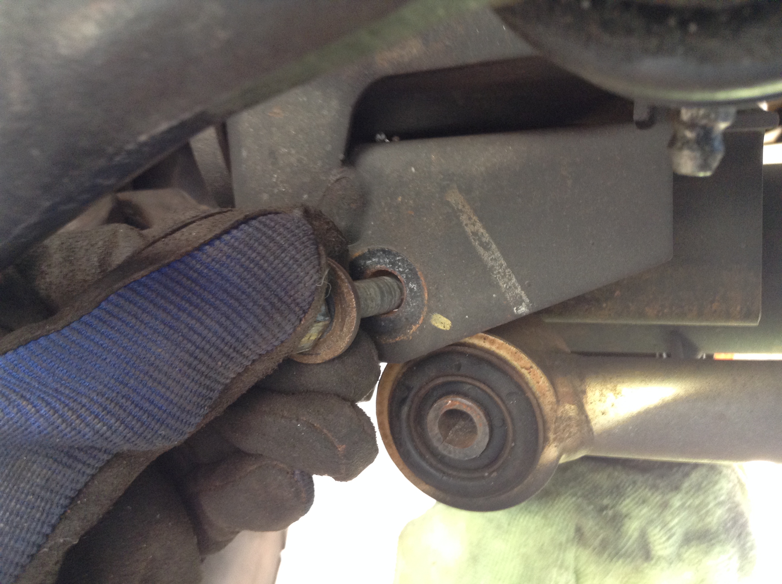

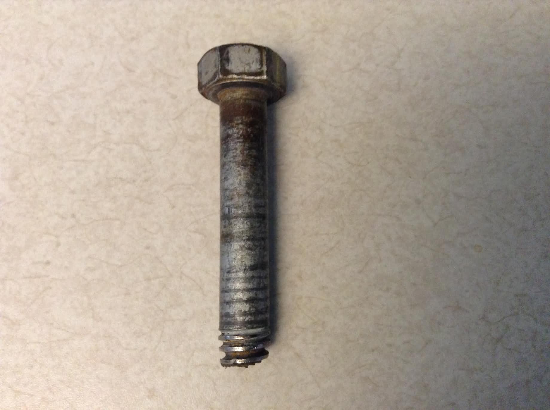

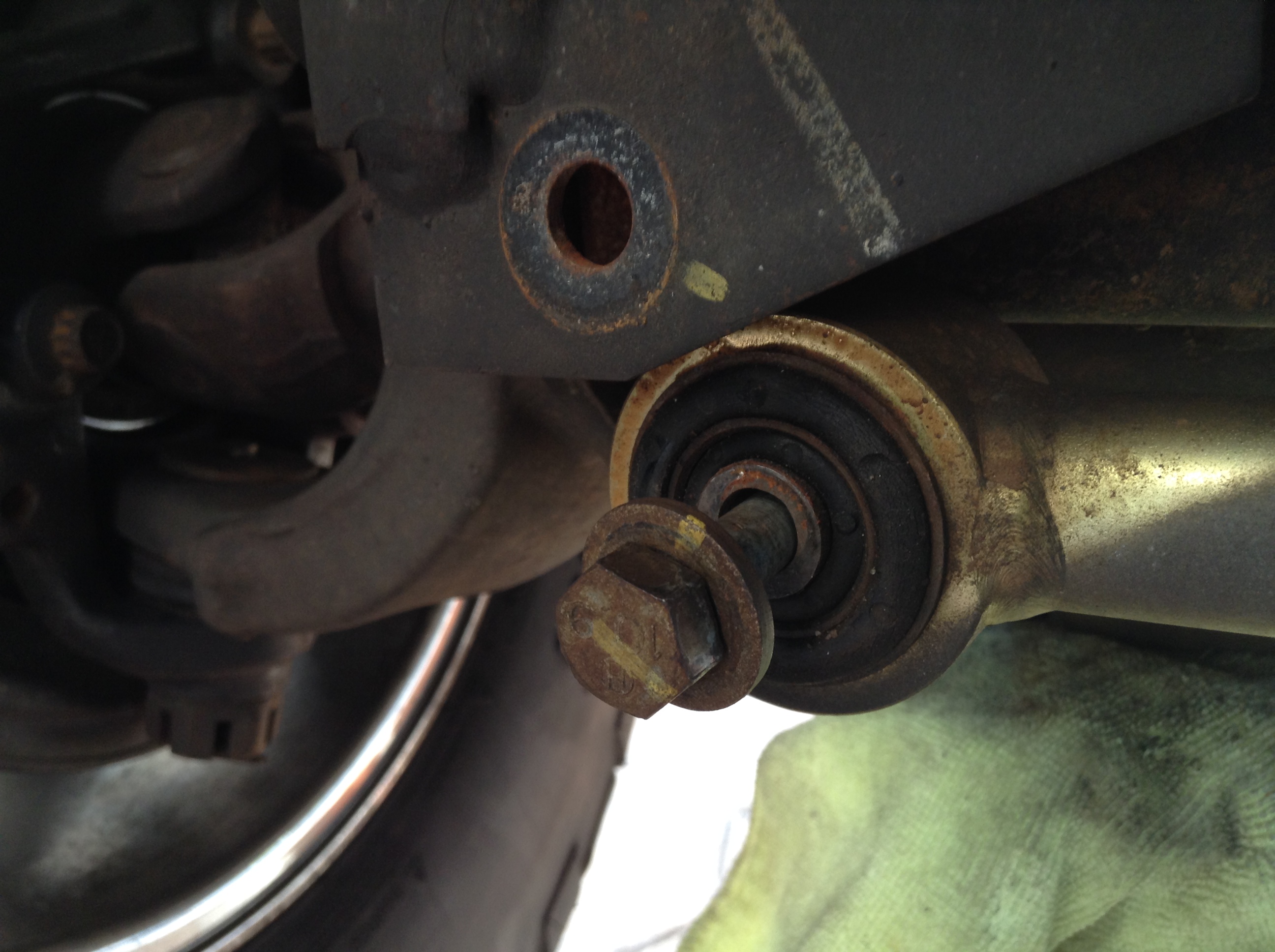

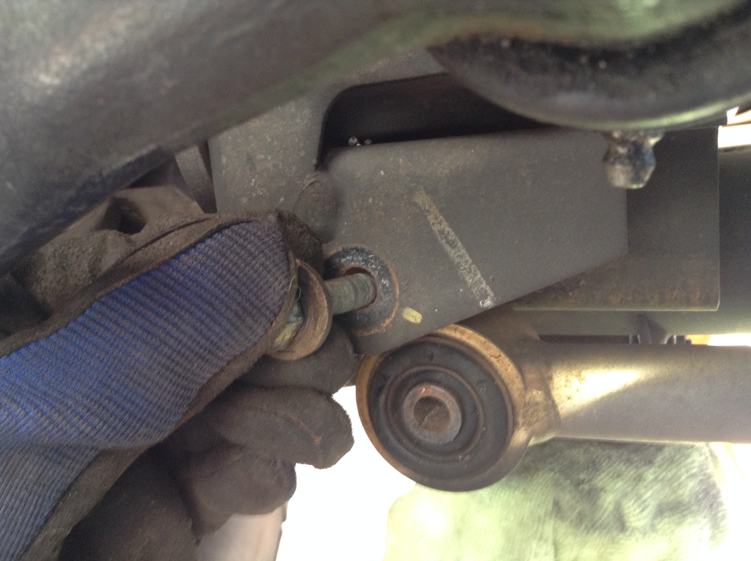

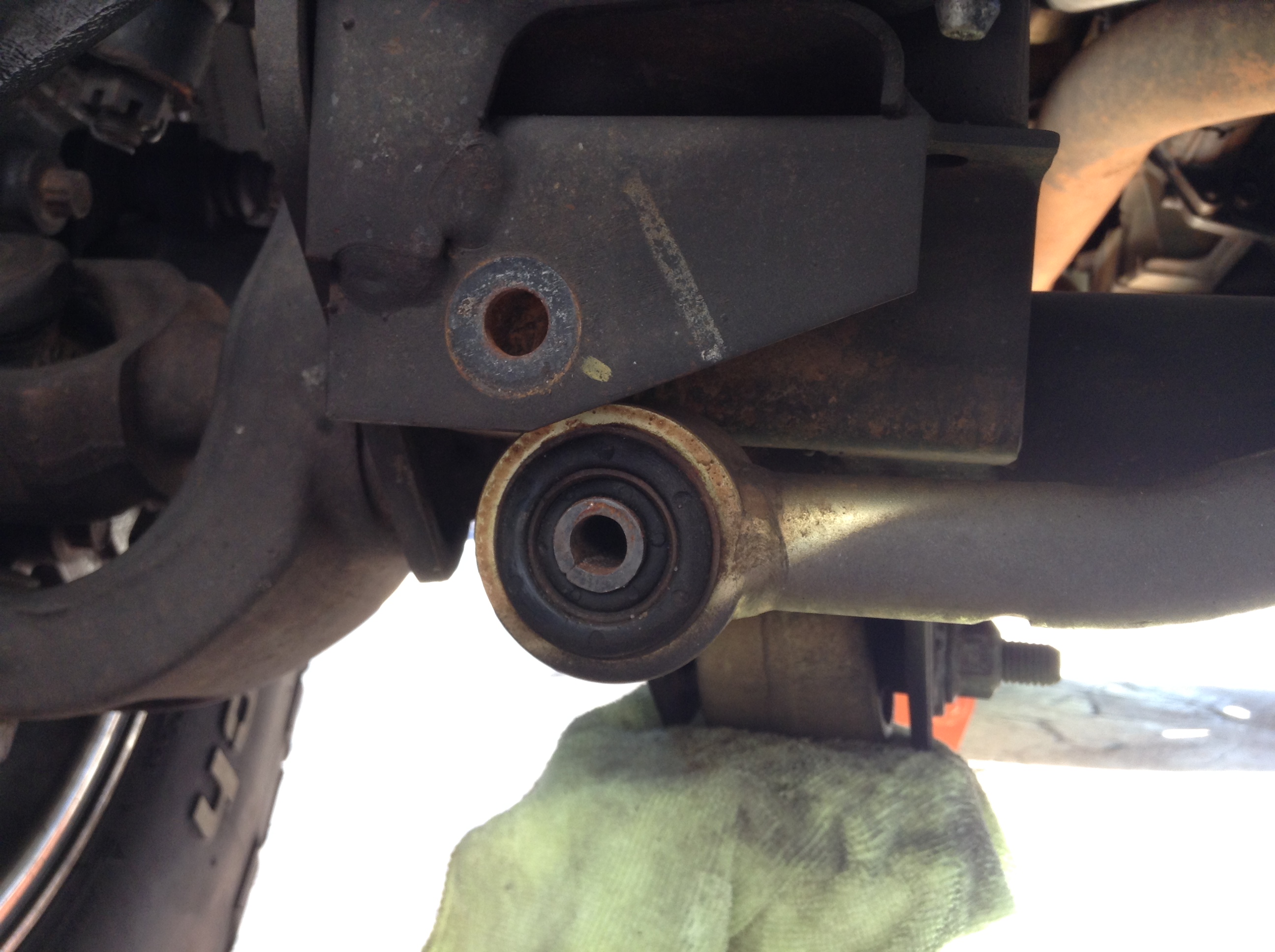

Does this look like too much play to you guys? The stock bolt seems to have plenty of wiggle room in the front trackbar bracket. I ask because I broke the bolt and had to order a new one.

Thanks for checking yours out. I think my TJ is different - it uses a 10mm bolt (with a hardness / grade of 10.9) from the factory. I heard that the later TJs switched over to metric bolts for the trackbar. It's a strange bolt though, because the threads are larger than the shaft.

I've got a JKS trackbar, and the sleeve in it is a bit smaller than the axle bracket holes, but not by much.

I got it put back together using a standard 10mm bolt (instead of the factory thinner version) - the fit was much better! A standard bolt with the slightly larger shoulder filled the hole and had much less play.

YES! That is not right. I took the new track bar bushing down the local TruV hardware and fit the largest bolt I could. As the stock bolt was small for both the axel and bushing. If from there if the bolt is still too small for the axel I suggest buying some large washers that are tight to the bolt and welding them to the axel. There are many threads out there suggesting of using a larger dial bolt and welding in washers when the holes get wallowed out.

What I did on our JKs is since the bolt holes in the bracket are 9/16. I drilled the bushings in the track arm to 9/16 also.
Was it hard to drill the sleeve / bushing? I've read that they are often hardened steel and can be difficult to drill.

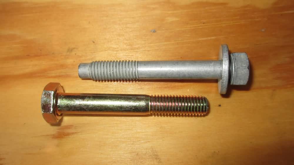

I ended up getting a new 10mm from Fastenal (they had to order it). It is similar to the stock bolt (I bought one of those to compare), except that it has a larger shoulder.
Here are the two bolts - the silver is the stock Jeep bold with threads larger than the body, and the gold is a normal 10mm bolt.
