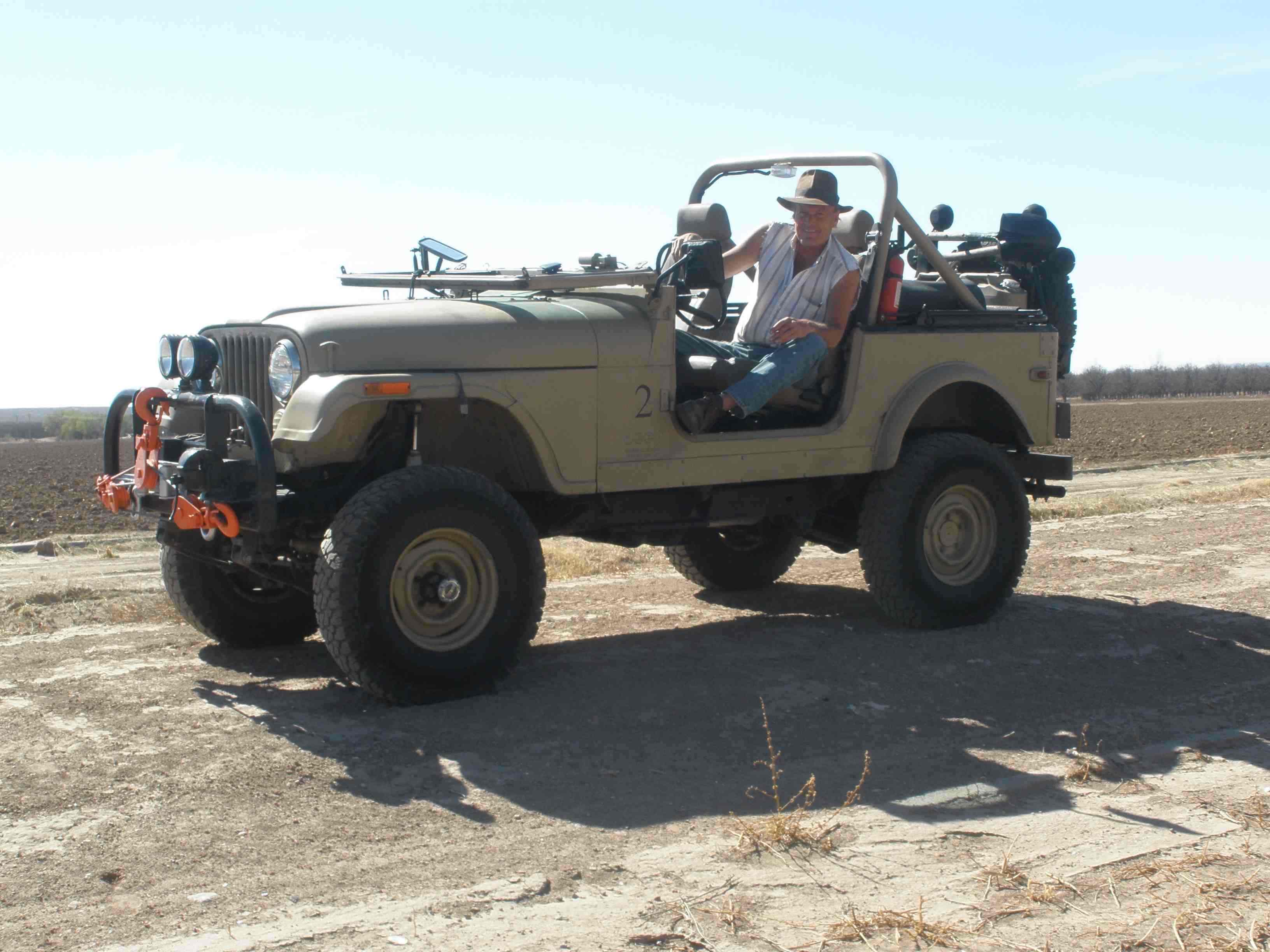

Hi everyone,
I'm Robert and been away awhile here on the forum, as I had been in the northwest, and down south in SA and overseas. I am back now in Las Cruces, NM for the last 2 years. Got a mail from an admin to say hello so wanted to drop in and the site looks great-- lots of new posters and Jeeps. Love it.
Here is my Jeep, a 1983 CJ7, I've had for 20 years, rebuilt from a total, and has 1,187,520 miles on its 5th IL 6 engine. Been a Grand and Disturbing adventure. Indeed. This is my 46th year of Jeeps and have had 26 of them over the years. VEX here is the latest. For overseas shipping weight for lading with VEX is 5989 lbs. with all the metal glued on it so I don't pull it apart, but it sure rides nice. Hope all is well here and everyone is doing good.
Thank you,
Robert

Hello and thank you,
VEX is used for pleasure and my work--thus, all of the above. I am a contract field Archaeologist-Artist for NASA. VEX has been in 123 of the world's 195 countries to date, thus, the mileage. I've had it 20 years, restored from a total. It is my 26th Jeep since my first in 1968, a 1944 MB.
List To Date:
1. Welded frame inside rails with 1" thick plating the height of frame, on inside frame rails.
2. Welded-bolted 2x4 Schedule 80 tubing across front and rear for base bumpers.
3. Added 1" plate in cantilever fashion to both ends of bumpers, back to frame rails.
4. Welded 3/8" thick metal trays for winch mountings.
5. Gusseted same at 5 points under bumper plate mounts.
6. Added 9" vice to right hand bumper end on its own plate mount.
7. Added 2-12,000 MM winches.
8. Replaced winch line with 1/2" cable.
9. Added winch line at 150' rather than 90' as offered by manufacturer.
10. Added 3-60 ton snatch blocks. (carried on line on Jeep front)
11. Added 2 JD 1000 amp batteries
12. Wired entire Jeep for heavy elect. with 2/0 welding cable
13. Added 200 amp alternator
14 Added 2 Aux. batteries for running APUs.
15. Added 110v, 220v, 440v, inverters.
16. Added 110v Block-tank heater.
17. Added 2- 1000 watt aircraft lights to front.
18. Added 4- 800 watt aircraft lights to rear.
19. Added Canon Stereo.
20. Added 800 watt amp.
21. Added 4-6x9 mid ranges.
22. Added 2-5" tweeters.
23. Added interior lighting.
24. Added gauges for oil, fluids, TC temps, T temps, electrical.
25. Added compass, temp, altimeter.
26. Added new Bestop Top.
27. Added new hood, fenders, tailgate.
28. Added new Bestop, bikini top.
29. Replaced windshield frame and glass.
30. Added Bestop center console.
31. Added Bestop high back bucket seats.
32. Added Added indoor-outdoor carpeting.
33. Added T-18 w. mil. spec 7.71 1 st gear.
34. Added 4:1 in Dana 300 TC.
35. Added front and rear 1 ton DLs from F-350, w/CV joints in each at TC.
36. Added twin Dana 60s, F and R (being refurbed at this writing)
37. Added JK sway bar disconnects
38. Added JKS 44" shocks front, 40" rear
39. 14" extended shock tower mounts with 3/8" thick steel plating to frame
40. JKS steel braided extended brake lines
41. Revolver Shackles front and rear
42. Confer shackles for backup, F and R
43. Superior Solid axles in AMC 20, when used
44. Welded and trussed AMC 20 when used.
45. ARB Air lockers, front and rear.
46. 2/0 home made jumper cables.
47. Manual Aux. throttle.
48. 4" Tuff Country Lift.
49. 2" body lift.
50. New high cap. radiator.
51. New window washer hardware, gauge, pump and electrical.
52. 3- 6' 40 ton throw chains.
53. 2-40' 40 ton tow chains.
54. 2-double bit axes.
55. 1- single bit axe.
56. 1- military 36" shovel.
57. 1- complete tool box with sockets, 3 sizes drives, and all other tools.
58. 1- complete electrical box and spares.
59. 2- 18 oz. commercial fire extinguishers.
60. 1- set of 1 ton truck chains.
61. 1- 870 Remington 12 gauge, 3" magnum shotgun, w/ 8 shot magazine extension.
62. 1- .308 Galil
63. 1- .45 Colt auto
64. 2- Mil. 5 gallon gas cans (8 total, 4 more in trailer).
65. Custom built tire and can carrier, swing out.
66. 1- 1 ton mil. pintel hook, rear, for trailer.
67. 5th, 258 IL 6 cylinder engine. (S and S engines)
68. RV Cam.
69. 390 Holley CFM 4 barrel carb.
70. Clifford intake.
71. Clifford steel valve cover.
72. Custom battery trays.
73. Custom TRW solenoid.
74. Custom porcelin ballist resistor.
75. HD Timkin coil.
76. 4 automotive solenoids for all heavy duty Electrical APUs.
77. Points and condenser ignition, no SSI (computer)
78. Tires are 9.50x33 All Traction Radials
You may see more data on VEX and what it does for me here:
Behold Jeep Forum VEX
The heft of VEX is because 4 7s back, I pulled literally apart and swore I've never do another stupid deal like that again. Too, It has pulled out a 66,000 lb concrete truck, stuck, with no errors.
Behold Jeep Forum Winches
Thank you for your comments and questions.
Robert

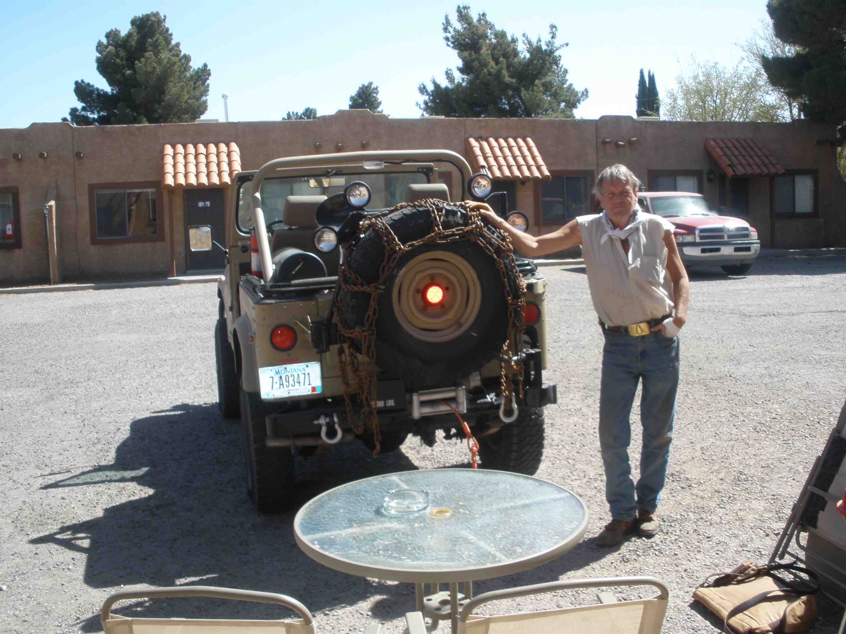

Great response and thank you. Answers below;
The two main batteries are generally Optima or CAT (Caterpillar), 2 of them, at 1000 amp each. They are powered by a 200 amp alternator for fire trucks, emergency vehicles, etc. The two Aux., are mounted in another tray I built for them in the floor of VEX, rear, right hand side.
Shown, my two 650 amp Delco Batteries for now as the Optimas are in the aux. hook up.
200 Amp John Deere Alternator. I either use JD or CAT. JD this time around-CAT is better, in my opinion.
All electrical in VEX is wired with 2/0 welding cable, NO automotive anywhere, other than the stereo and amp and speakers. All other is just too light, flimsy and will fail in the far reaches of creation.
(There is no diagnostic center-tow facility in The Gobi Desert!)
Both batteries and the 2 aux. batteries charge all the time and are ran through two starter solenoids. And the two aux. run through an inverter as VEX is set up for use as a Stationary Engine, in that through the intverter it is set up for 110v, 220v, 440v and 660v (welders). You can see the inverter plug sticking out of VEX's hood on the fender on the right hand side.
For speed, Audrey and I have a vid of me in VEX, in 2nd gear low range, and he is running off by himself with the front ARB engaged, which allows the Jeep to go in a perfectly straight line, and I am walking off to the side along with him. I do this a lot in the field, as I get tired of riding so, he goes and I walk along or nearby and rock on to the music and see the country side. He behaves, fortunately, unsupervised going along by himself.......
The T-18, two of them I got at the time, for free for hauling them away in 1992 from a wrecking yard, were from a military Deuce and a Half, and the 2-1/2 ton Army rigs are a great source for our Jeeps. They are the only ones I learned later that have the 6.61 or 7.71 first gears. I did not know this when I got them. The scrapper guy just wanted them hauled away.
The suspension is set up with Revolver Shackles, 4" Tuff Country Lift, extended shock towers by 12", 44" Nitro Shocks, and so, VEX has nearly 4 feet of wheel travel, front and rear, which is needed in so much of the world where it finds itself. Yes, I have manual disconnect sway bar links from J and S. I also have JS 4 foot long steel braided brake lines.
Shock towers of 12" plate, 3/8" thick and brace
1" steel plate, lining frame.

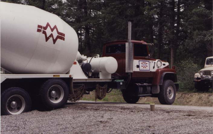

And VEX pulling out a 66,000 pound loaded concrete truck, below:
Data on same and winching for those that need information on this:
66,000 lb. Concrete Truck Pullout With VEX
Thanks and hope this helps,
Robert
