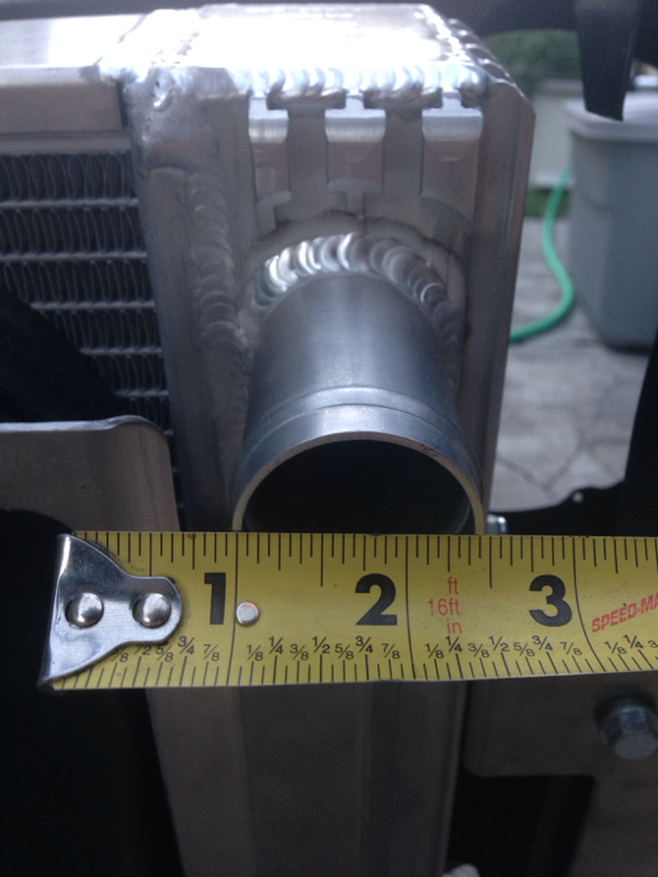

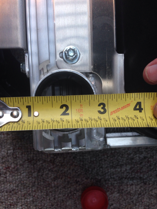

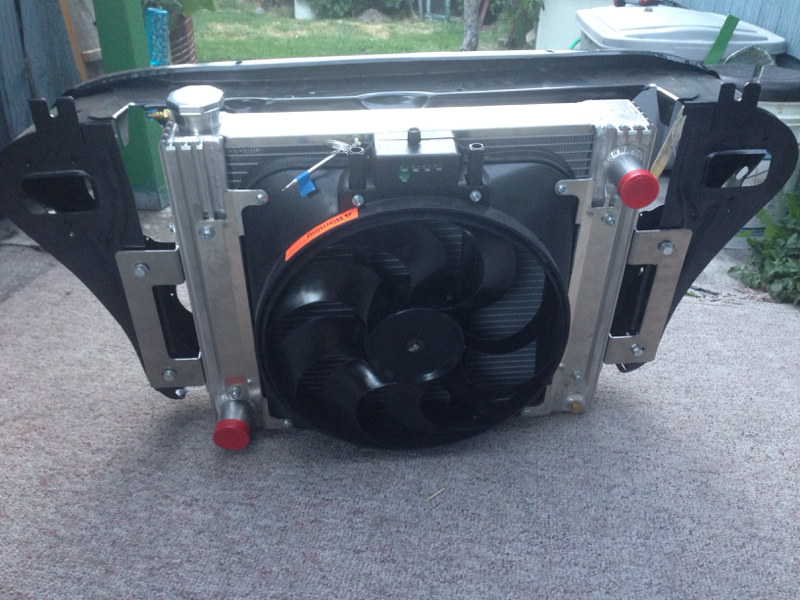

I need some advice , I'm looking for a radiator hose for my 304 cj7 that will fit on a flex lite radiator , I'm pretty sure the original radiator hose in the jeep now is 2" but on the flex lite radiator the top inlet is a 1" 1/2 and the bottom let was 1" 3/4
any thoughts, thanks !

I looked on flexolites website and just about every radiator on there for jeep cj is 1 1/2" inlet and 1 3/4 outlet, even if you have a ford or chevy conversion. It show stock size from 72-86 cj 1 1/2 and 1 3/4" I think you have the correct one.
