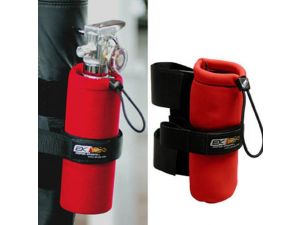

How you mount it depends on the size of the extinguisher. A lot of extinguishers come with their own mounts and you can either screw them on the roll bar or use heavy tie-straps. Small diameter extinguishers can be mounted in pouches with Velcro straps.

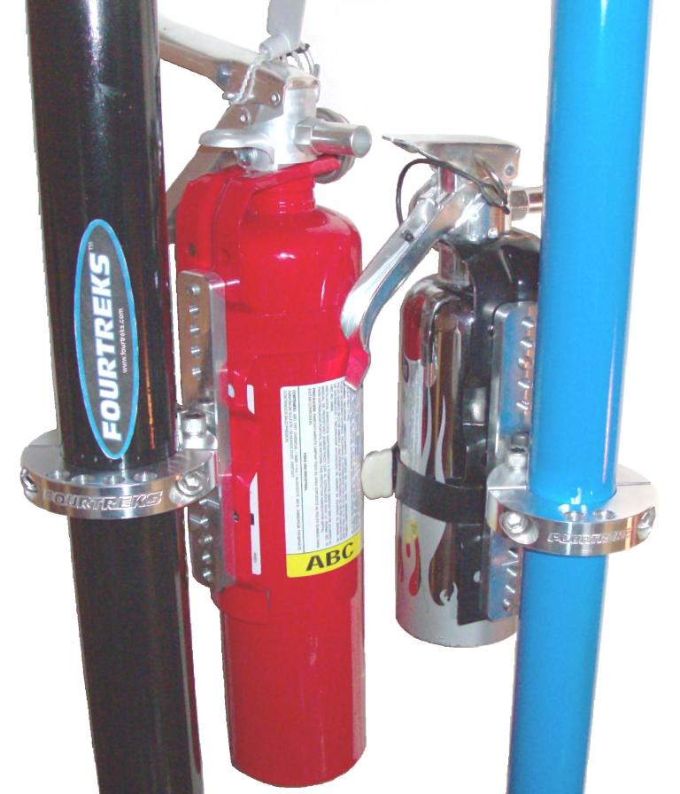

You can get fancier with these billet aluminum modular mounts from Fourtreks @ Modular Fire Extinguisher Mount

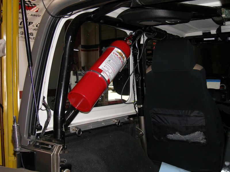

Or for containment of an engine fire you can mount an full or semi automatic fire suppression system like the one in my rig which is a 10# Coldfire unit with dual discharge nozzles under the hood...
