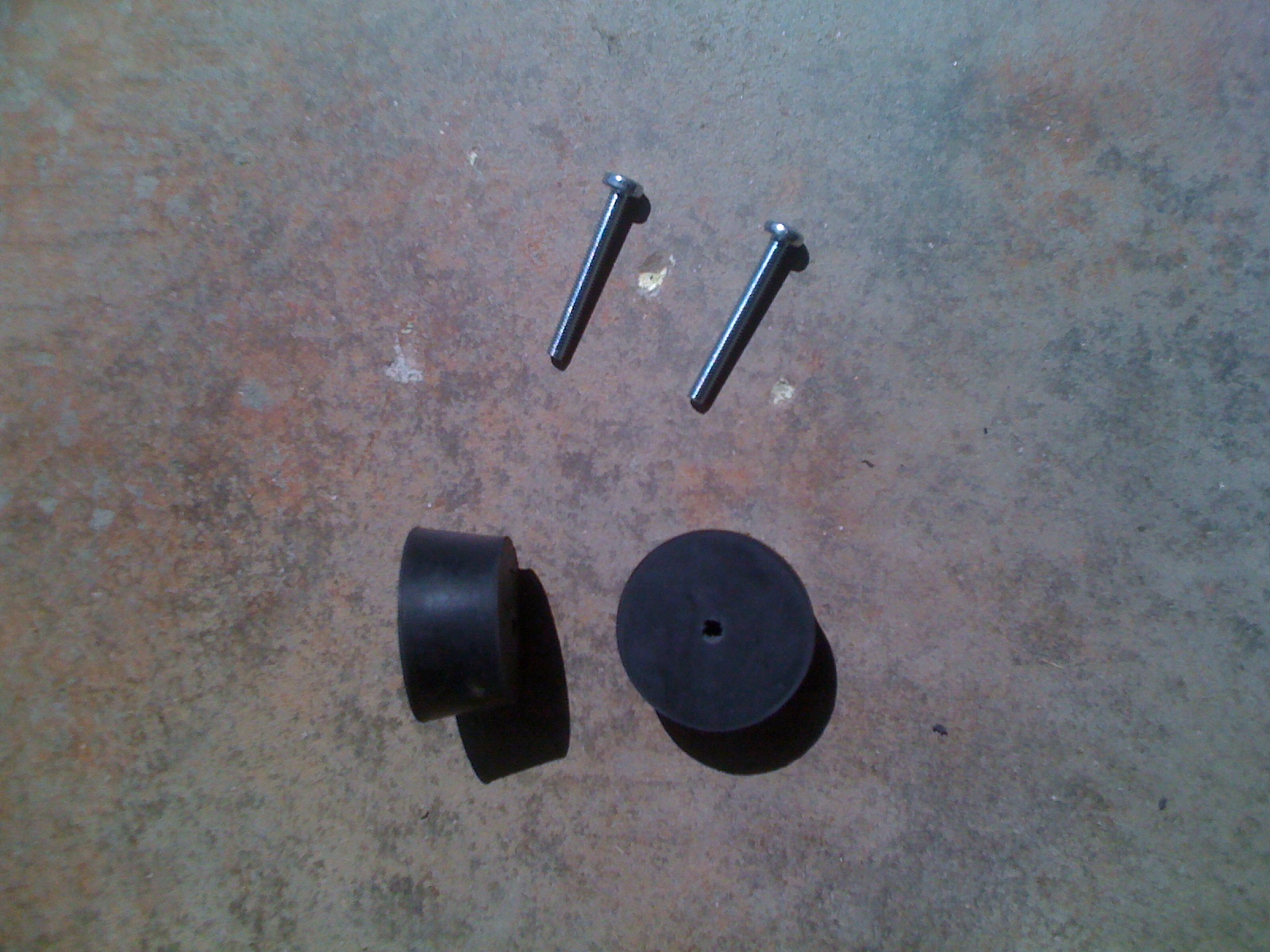

I did find some solid rubber stoppers at the local Ace hardware store in the fasteners aisle...think I'm going to use those under the stock bump stops. Plan to drill holes, test the fit and cut as needed, then get longer screws to secure it all. It won't look perfect, but should do the job.

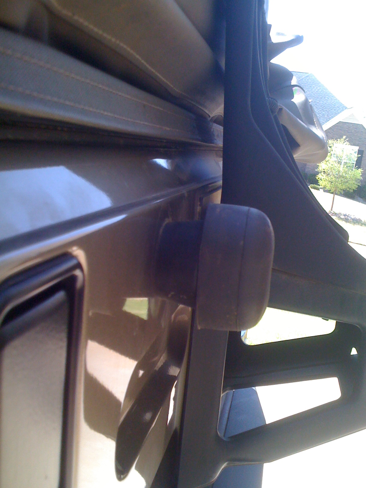

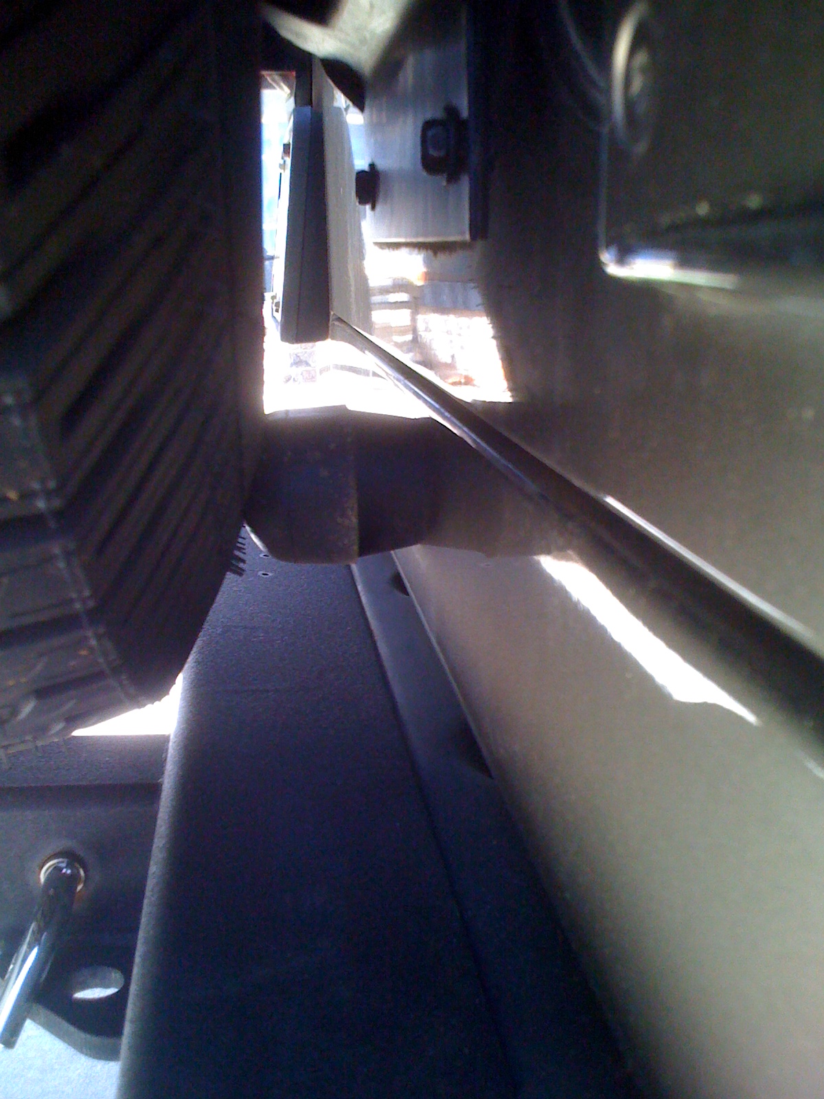

Here's what I ended up doing:
Bought 2" X 1.5" rubber stoppers from the hardware store (3), and longer screws (2") with a matching thread pattern. Drilled holes through the stoppers, then mounted the stock rubber on top of them. Parts were around $12. Quick, cheap, and easy. See photos attached.

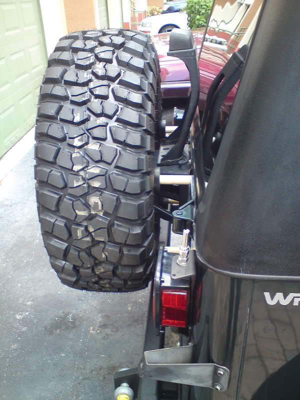

I used ABS plastic on mine, as I needed to extend quite a bit (had to put in a spacer to clear the rear bumper). Here's how it looks like (ABS also comes in black, but I could not find it):
Wow...you did have to extend quite a ways. Would've take 2 or 3 stoppers to make that distance.
If you aren't happy with the PVC color, can't you spray paint them black? Krylon makes a plastic paint.
Yeah, I COULD paint them... If I were not so lazy, at least! I was going to hit them with the rattle can liner black, but never did get around to it. Now I'm kind of used to them.
