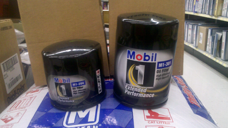

I changed my oil yesterday, and went to get another Mobile 1 204 filter (the one recommended by the book at Advance Auto Parts) when I remembered reading about the Mobile 1 301 filter. The 301 is said to be the same as the 204, just longer, and should allow you to hold alittle more oil.
So, is having a slightly larger filter and more oil a good thing, or does this just give a larger target to tree limbs, or things that could damage the filter?
picture of both filters

Thats quiet a bit bigger.... I dont know but Im going to ask out Compressor Engineer tomorrow and see what he says on it.... Got me thinking now.

I run a larger filter on our Motorhome, it's got an 8.1L GM V8 in it. Theoretically, the larger filter provides more filter material for longer life (won't clog as quickly) and the higher volume of oil should allow the oil to run cooler, thus lengthening it's useful life. The filter I use on our Motorhome holds a full quart!
I hadn't considered a larger filter in the Jeep, but it appears there's ample room with low risk of being snagged, so I certainly can't see any harm in doing it...
I am the manager at a quick lube and we use recommended filter sizes although. .at the beginning of last yr pennzoil(which is the quick lube I work at) company switched from wat they call a pz34 on most chrysler engines to a pz019 such is skinnier but longer .. both have the same threads so when we see a 34 we now put a 19 on it because they no longer make the 34 but test showed they hold the same amount of oil. Now here's what most people don't know. .at a pennzoil meeting earlier this yr a n engineer told us after so long when the filter reaches max dirt capacity there is a valve inside the filter that doesn't allow oil to flow thru the filter so people that go longer than let's say 5000 miles on an oil change whether its syn or coventinal there just circulating dirty oil. So id say a bigger filter will help some get longer oil changes but not much.

Is bigger always better? While we might convince ourselves that's the case, it may not always be the case.
Sure, a bigger filter holds more oil, providing better cooling and the oil circulates less often. But a down side is slightly longer warm ups that may impact gas mileage and optimum oil flow.
My gut feeling on this one is that oil change frequency and oil change technique (Cold Vs Warm) is more important that filter size. The larger filter probably costs more too, and yeah, having the big one hang down into vulnerable territory could have its own costs too.
I change my oil after every really dusty and dirty hard trip, otherwise, just a bit sooner than recommended by Jeep based on mileage and time, and I used good oil. Using that approach I have never had an oil related engine problem, including gas powered engines that have gone over 200,000 miles.
