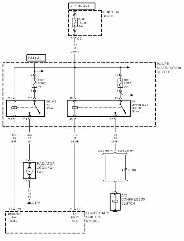

my electric fan will not cut on. i have changed the relay in the pdc and it still will not cut on i can use a jumper wire on the relay and it will start. any idea on where to look for a short at
Welcome to Jeepz.. What model Jeep do you have that has this issue?

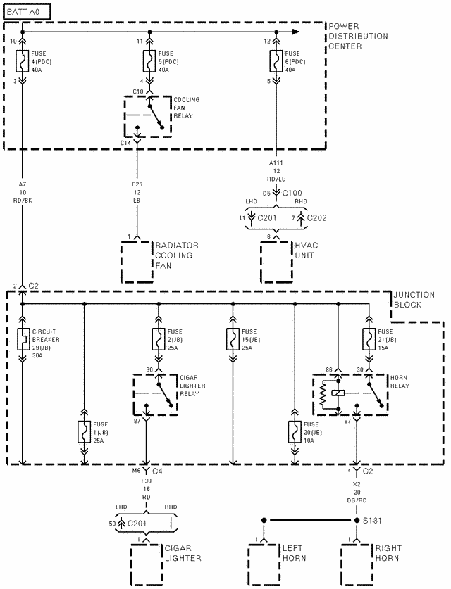

Wiggle the harness to the PDC and see if the fan kicks on intermittently. Here's a couple of wiring Diagrams. Looking at the Schematic diagram, it looks like the internal ground to the PDC could be at fault but this would have to be verified by you. From what you said, by installing a jumper wire on the relay plug on the PDC turns on the fan, means that the relay is not energizing. There is also a Fusible link that runs from the relay to the alternator circuit, make sure thats good along with the 40 amp fuse in the PDC..

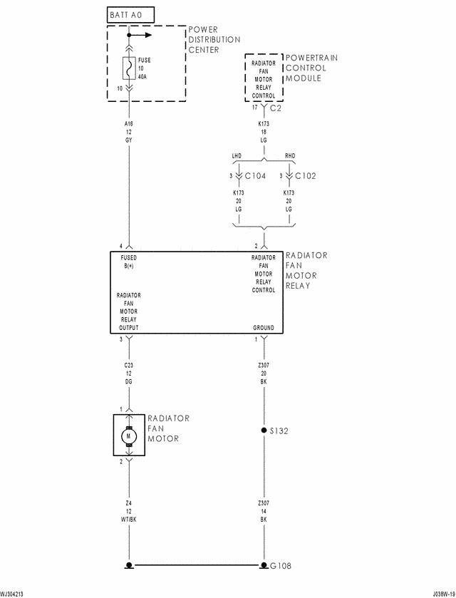

Ok so i have a 03 grand cherokee inline 6. i have a simular problem. i went on a trip about 2 1/2 hrs and i get off the interstate and once i do the temp gauge goes to about 230. i quick made it to a parking garage and parked it. when i was ready to leave i made it about 60 miles before i got to my parents house. I figured it was the fan motor. It wasnt. the fuse is good and when i turn the AC on i can hear a click like the fan trying to turn on but it doesnt. i am thinking relay and i am looking for more advice.
Is my wiring diagram the same as the one above?

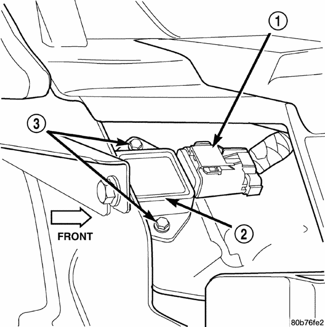

Nope, the GC's relay is located under the passenger headlamp and housing. the best way to service the relay is to remove the passenger headlamp then cut a square access hole to reveal the relay. There are 2 screws holding the relay to the body. Remove the screws then carefully retrieve the relay and disconnect the electrical connector. dont let the connector go back in the hole until you plug in the new relay. Before you install the new relay, apply a small amount of dielectric grease on the bottom of the relay. Most often the relay is all needed to fix the inop radiator fan but sometimes the fan module is also inop.Heres a diagram for your GC.

so there is a fuse inside the truck? is that right? Otherwise i am leaning towards the relay. does that sound about right to you? i have replaced the fan motor and the fuse under the hood was good but i didnt know there was a fuse in the truck.
No, there is no other fuse exept the one on the PDC, 40 amp, fuse # 10. Using the schematic diagram, with the relay still connected, run a jumper from the gray wire to the dark green wire using a large paperclip. DO NOT use your finger to hold the jumper, instead use a small plier. (Dont ask why) . With the engine running and A/C on and jumper in place, the fan should turn on.

The other way to replace the relay would be to remove the grill and front Facia/ bumper assembly. Disconnect the negative battery terminal and wait 15 mins. before proceeding.The hole cutting is a lot easier and will only be a one time deal. This will make it easier to service in the future. After you remove the passenger headlamp, there will be a slit on the plastic. Place a light on the underside of the plastic so you can see the placement of the relay. This will give you an idea where to cut the hole. You can either use a hole saw or a cutting wheel to make this access hole. This hole will NOT be visible when the headlamp is reinstalled later so dont worry too much. Avoid extending the cutting tool too far past the thickness of the plastic to avoid cutting into something underneath by accident.

ok so i just took the relay out. I cant seem to find a way to get to the wires without stripping them a bit so i can jump them. I have attached a volt meter to the relay and there is no conduction between any of the four prongs regardless of configuration. I also tried grounding it and checking with the volt meter.
Does this mean it doesnt work or am i wasteing my time?
Key on, engine off. Check for battery voltage from the gray wire and ground. If there's no voltage found, check the #10 fuse on the PDC. If the fuse is good, but still no voltage, the problem will be in the PDC. IF there is battery voltage from the gray wire and ground, from the back of the relay connector , backprobe a jumper between the gray and the DARK green. do not remove the relay as you do this test, otherwise , the fan module will loose its path to ground. IF the fan still did not turn on and you have voltage on the gray wire and ground, with the jumper still in place, Tap the radiator fan and see if the fan intermittently kicks on. If so, you have 2 problems, Relay and Fan module. I've seen it happen but rarely.
Ok i just want to say. I am back in bussiness. It was the relay and i am glad to say it wasnt that hard of a job to do. to ease my own issues i even siliconed the plastic right back in its place. cost me 40 bucks for the relay and .45 cents for a screw that i lost when i went to put it back in. thanks steelheadz
