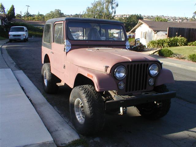

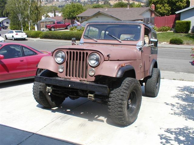

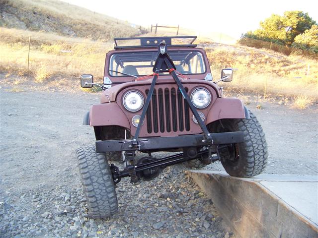

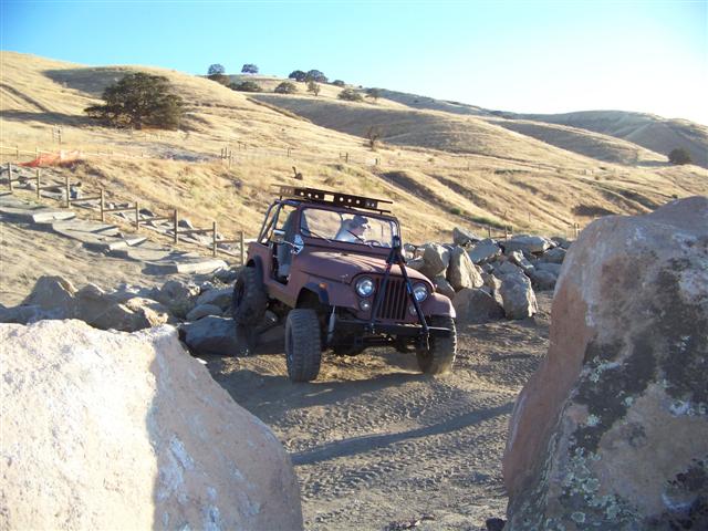

Nice to see someone responded, I do have a couple pics, sadly the camera that I took all the original pictures with died. I do have the tires sticking out about 4 inches front and rear, but the rear are 33X15.5 swampers, on 10" wheels. The fronts that size were barely rubbing on the tie-rod end, and they were a little bald, so I left my fronts as they were. one pic is before everything, one is after the initial axle swap, and the others are after the Good fabricator had his hands on it for a week, the rack on top of the cage is removable, part of the fab work, the cage too. He also re-worked the front end a LOT! more lift, moved the axle forward 2 inches, got the caster right by cutting welds and rolling the inner knuckles back, 7degrees where I had -3 degrees. check it out. Frank
I didn't think I'd like the tires sticking out, but I do, and it takes side hill stuff better. Very stable. The front tie-rod is all custom 1-ton rod ends, and 1 3/4 ton rod end, on the drag link. He(the fabricator) also did the 4inch angle iron rails on the side of the body, I rode them a couple times during the Rubicon run.
the guy who did this is named Phil, his place is Sillyfab in Sacramento, CA. He makes some really cool stuff.
Looks good Frank. I'd love to do the dana 44's too but they definitely stick out. Think I may keep my AMC 20 weld the tubes and truss it and shorten a wagoneer 44. Thanks for posting the pics
tom
