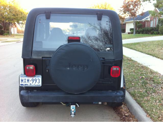

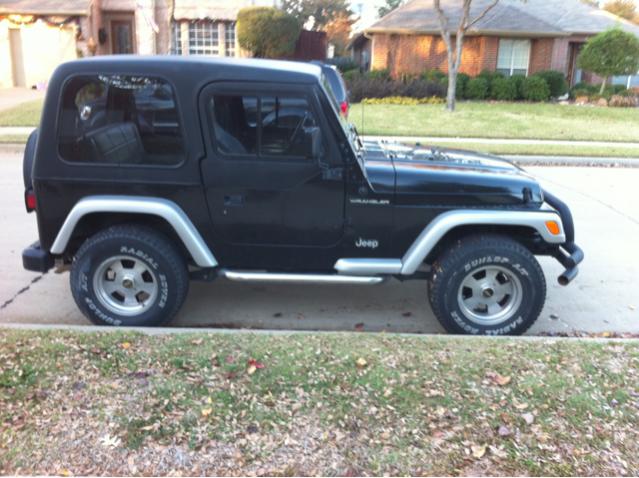

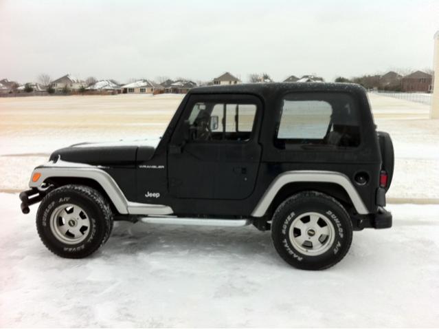

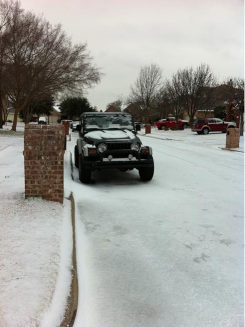

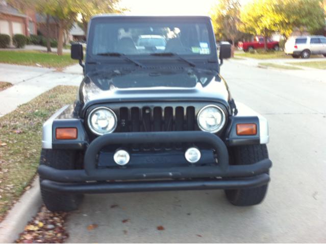

I'll be putting up lots of pictures as I go, however the updates will probably be far spaced! Wish me luck!
Current pictures of the jeep.
