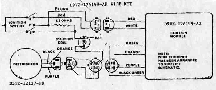

Wire dilemma number one. Ok from the stock ignition module the plug has a red wire with a white stripe. This has been cut and spliced with two wires. A red factory wire running to the bulkhead connector and going into the cockpit. the other wire spliced on there goes to the positive side of the coil I believe that the factory red wire to the bulkhead connector goes to the key switch. This is where the Ford red wire goes. does the positive side of the coil also go here. It is almost how the Jeep is wired now.
Now on the starter solenoid there is a light blue wire that goes up the same harness and inside the cockpit. I believe this is not the way the factory wiring went. Through the bulkhead yes but not directly to the solenoid.
So what I have left on the Ford wiring side is the positive coil, the red to the key switch and the wire to the solenoid. Any guesses.
My guess would be the coil + and the jeep red wire to the bulkhead connector go to my ford ignition module red wire. The blue stock wiring to the starter relay stays where it is. So I have one wire, the white one that is supposed to get to the starter switch; In the diagram its the two wire plug. Would I take the blue stock wire to the starter solenoid, cut it and splice it so two wires come from it. one to the white ford wire and the blue jeep starter solenoid wire. Or is there another wire in the stock wiring from the key I can wire to the white wire.

on my stock wiring harness I have a yellow wire from The BHC (bulk head connector) that is cut. I have a black with white stripe wire that goes to nothing.
One other wire that does not look right is a brown wire that is going to the two prong connector on the alternator, yellow wire.

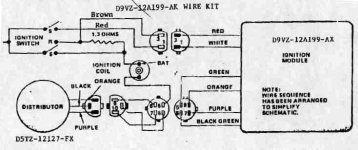

Just guessing on this. I have a 3 lug starter solenoid. Two big ones for the battery/ starter wires and one small one for the wire from the ignition switch If I replace it with a 4 lug, I think I have a place to connect the wire from the ford module.

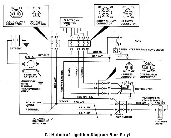

Jim , see if this diagram matches as far as color codes with the existing wiring on your jeep . I must continue this as soon as I can . If the color wires match and It seems that your jeeps wiring harness has the has the same connections , let me know if this works . You said your starter relay is only three lug which throws it off a bit , but I want to figure out if you need a four lug or will ignition wires meant for charging ignition coil during cranking will go through the dura spark module and not through the starter relay. We must find out exactly what wires the module has and where every one is supposed to go so we know which starter relay you need , three or four lug. I believe this is where we should start , from the module. I believe that is the key. The module will determine what is wired to the ignition switch , starter relay and so forth . Of course we want to be sure the module is correct for your jeep , but personally they all look alike on diagrams . But yes , we want to be sure. Hoping to be back Saturday afternoon to post , hoping that this diagram will help and bring good news for you . Will be back to hitting the books (diagrams ) then . My 1980 CJ diagrams will have to be read with a fine tooth comb but I would like to know if any wires match , any not on jeep but on diagram , any on jeep but not on diagram , trying to determine what's different and what's the same. Hope this works. This has me very curious. Will be back afternoon New York time. Post all you would like , helps me to search better in terms of colors and connections . Most interesting to me is the colors on ignition module but ignition coil and starter relay as well . Also distributor and extension harness from distributor to module.
That's closer than the one I posted. The only thing different is the color wire going to the coil off the 4 wire plug and that is probably because I have the ford harness. Mine does not show the wire to the electric choke. Very close indeed. I have to run in to town to pick up the distributer adapter. I'll get a solenoid for the 81 year model.
I compared ignition modules from 77 (which is installed) to the 81 module. If the 81 was installed the wiring would be there. Could not find one for the 4 cyl that was originally installed to see what it may have had.

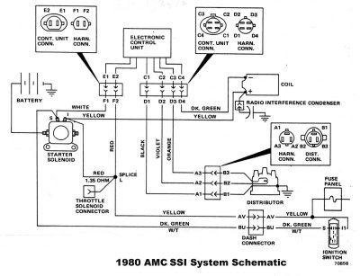

Was able to take a break for a moment , may be the last break I get before completion today , helping a friend move some items . Found this diagram and hoping it will also serve better . I cannot see if it differentiates 4cyl. from 6cyl. but I am hoping it will further match your existing wiring and hoping as well that all diagrams in your possession to date will help the project in so far as find the difference between what is currently on the jeep as opposed to what is actually needed for correct operation for the 258. Hope this helps Jim , sorry there is so much confusion . Greg
Thanks Greg, everything you sent my way has been a huge help. I think I have it licked now. Just need the new 4 post solenoid. Every schematic I have seen proves I need one.
