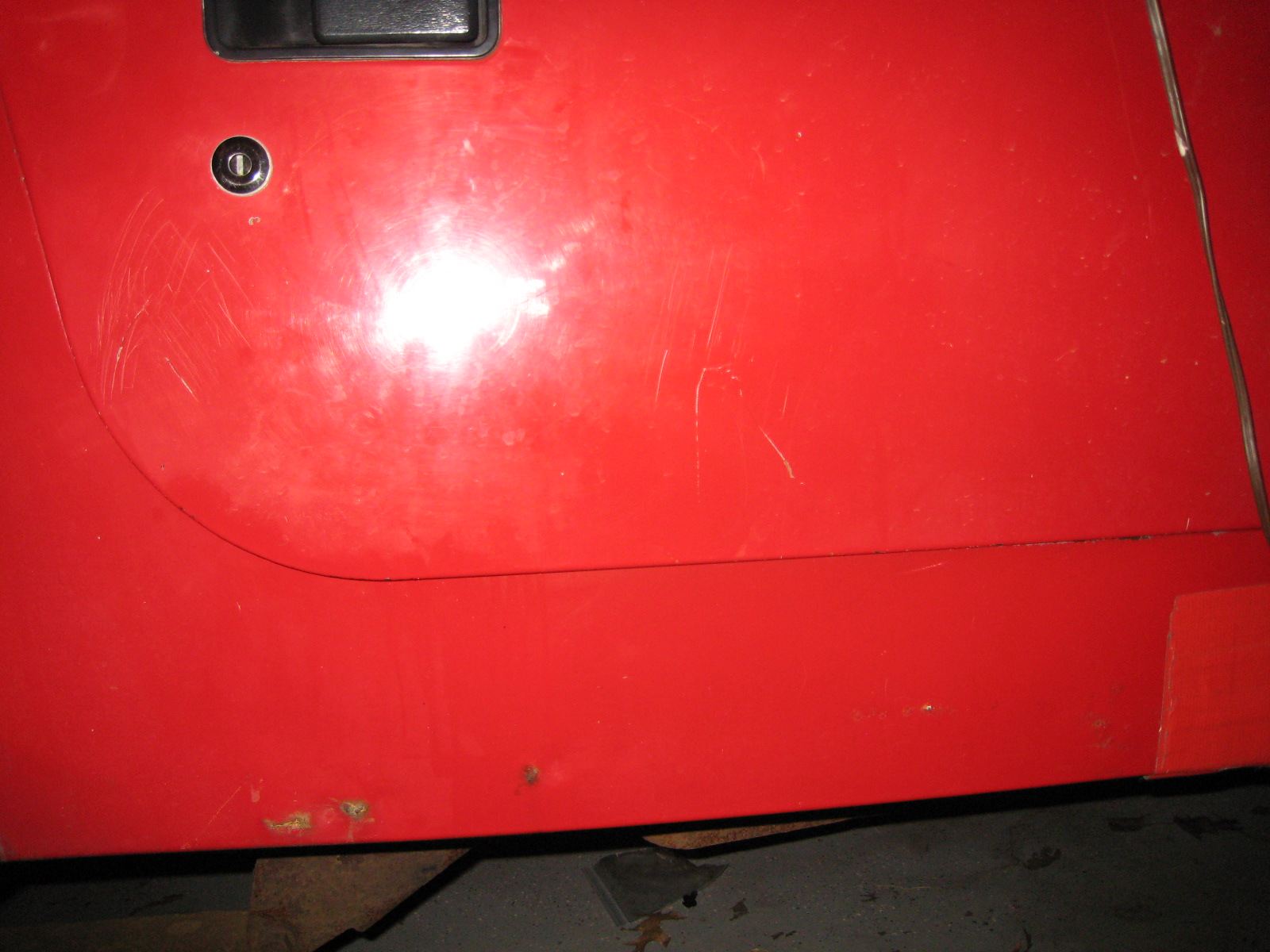

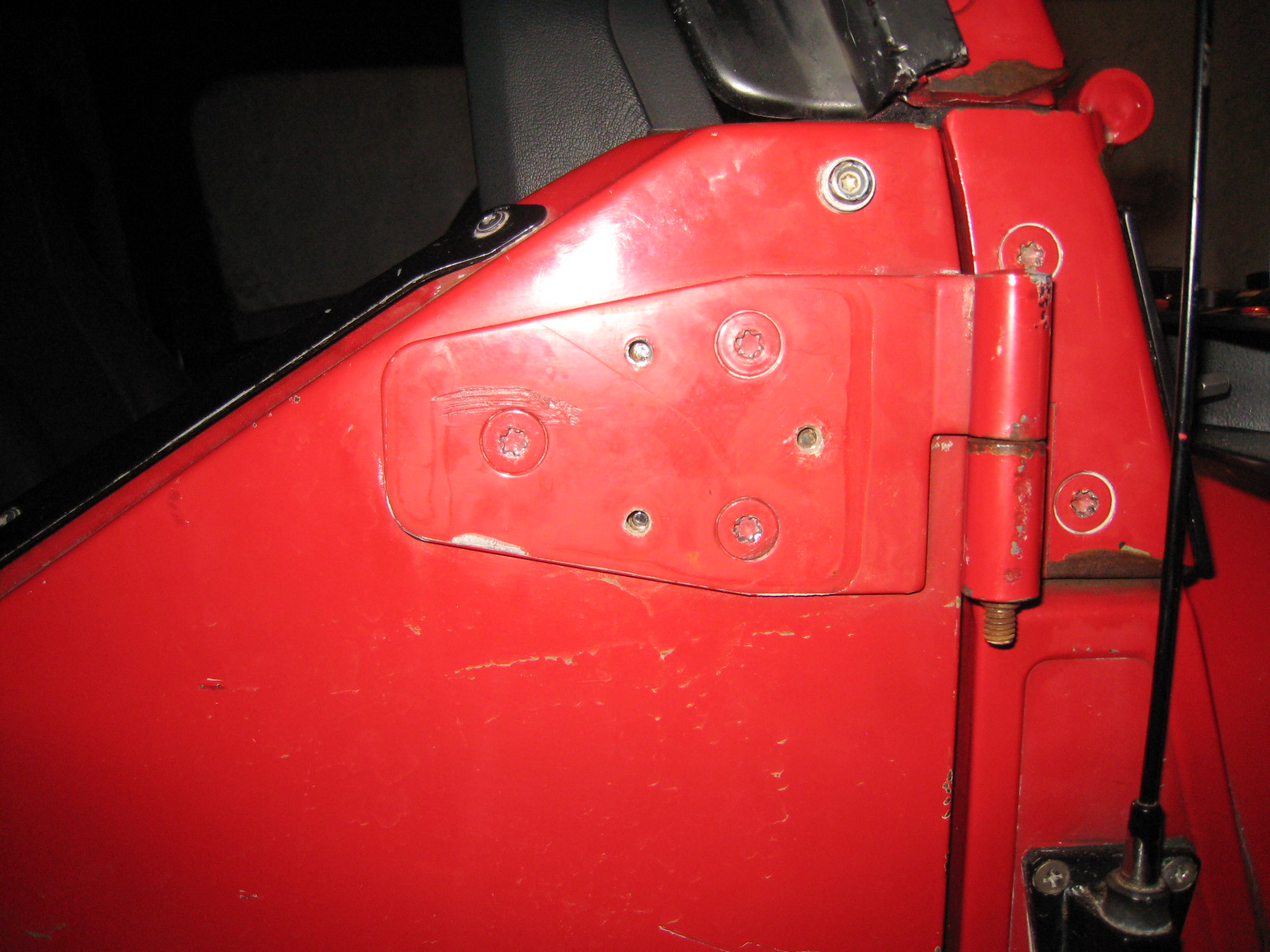

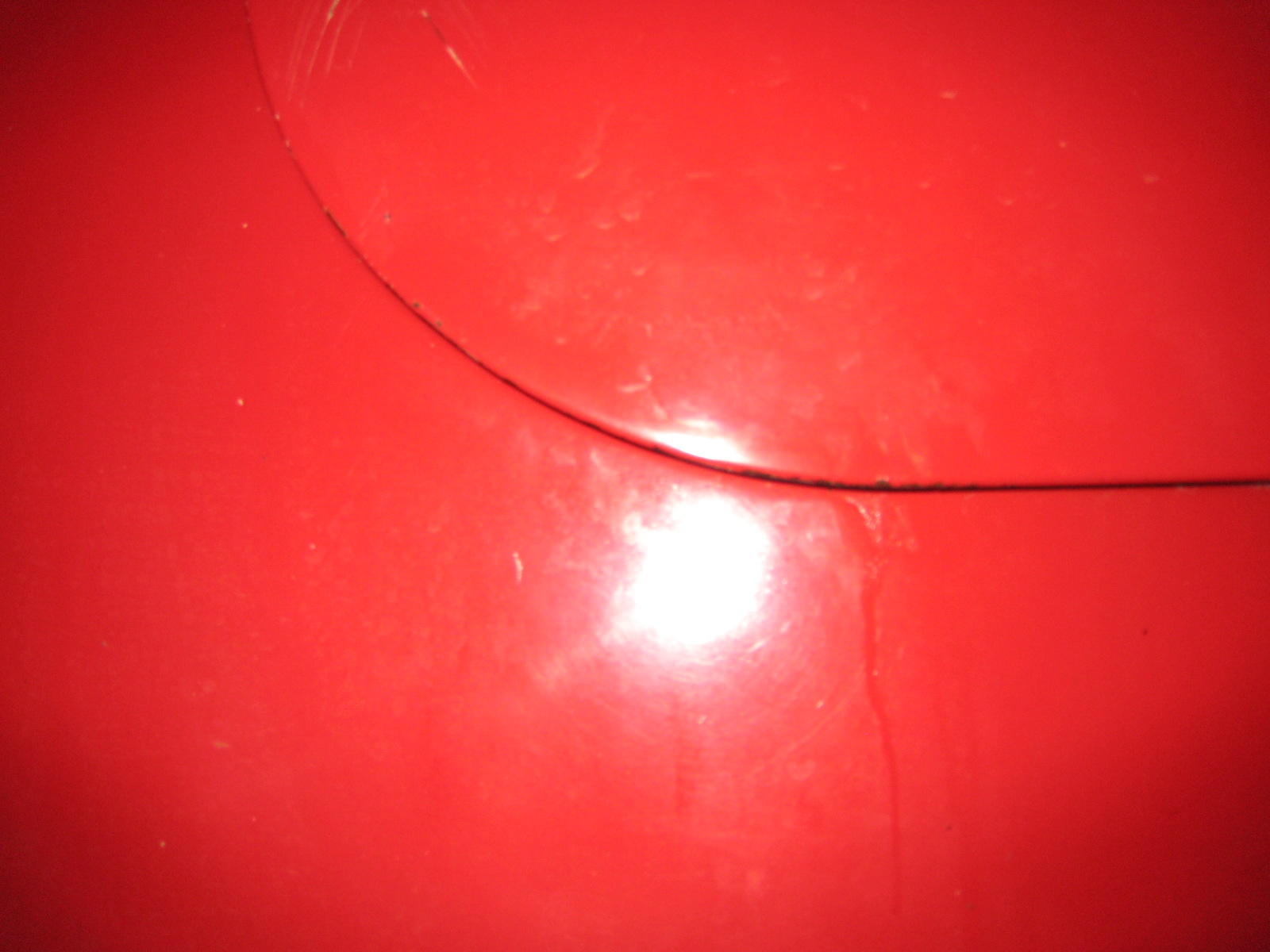

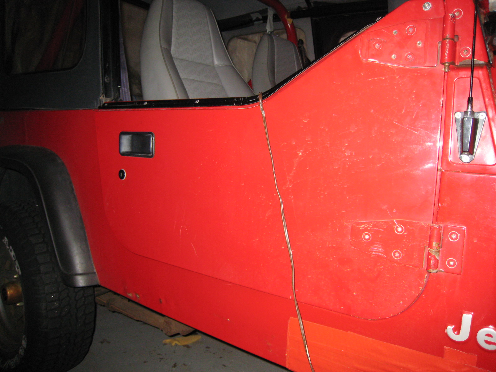

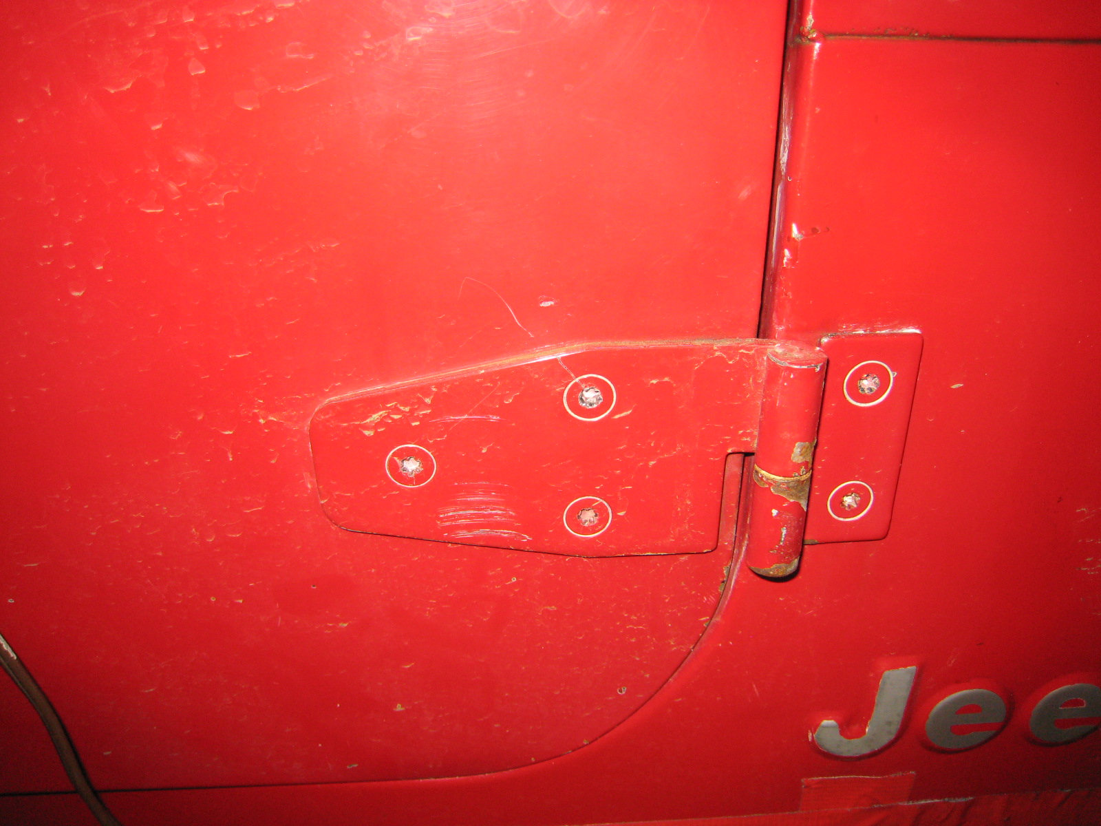

Pictures.....

I'd loosen the screws on the bottom hinge, then pull up on the door, and try to close it, then tighten down.
I'm guessing that the top hinge moved when you were putting the mirror mounts on, and now you have to line everything up again.
What Terry said
adjust your hinges by loosening them, lines the door up and tighen the hines. I would suggest loosening both top and bottom thought. It appears your bottom needs to be moved rearward and the top needs to be moved foward.
Tighten the nut down on your hinges, remove the striker bolt, have someone hold the door in perfect alignment and retighten your hinges. Also, you may have damaged the bushing inside the hinge, if you can wiggle the door up and down with all the bolts tight you should replace your hinges and start over.
