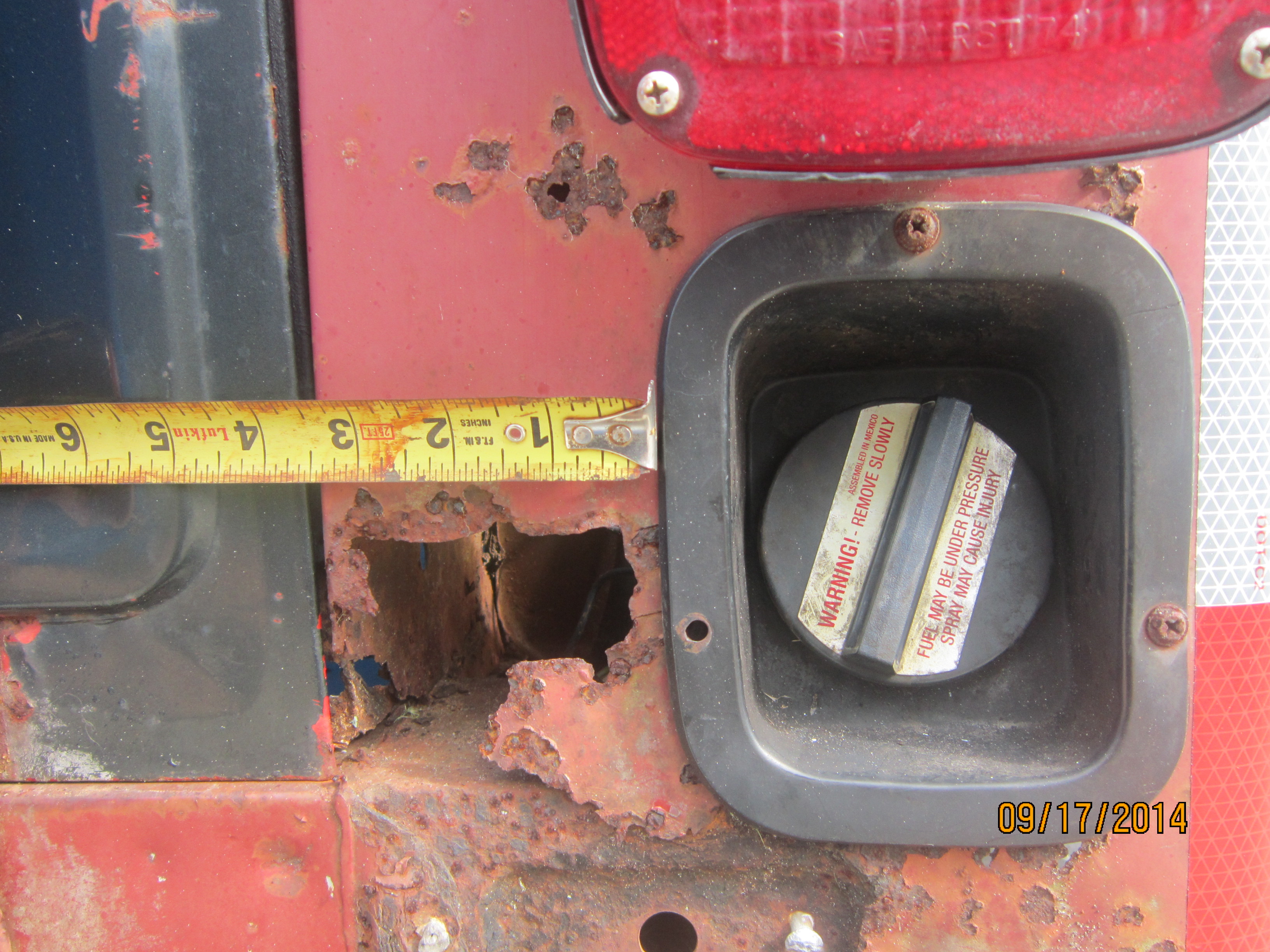

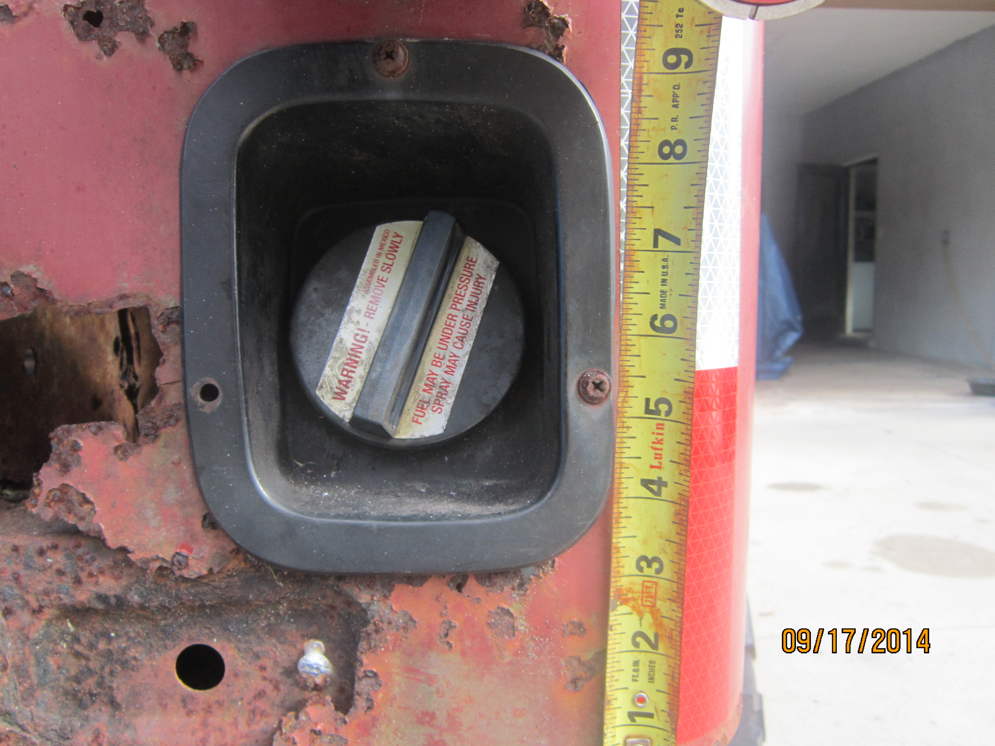

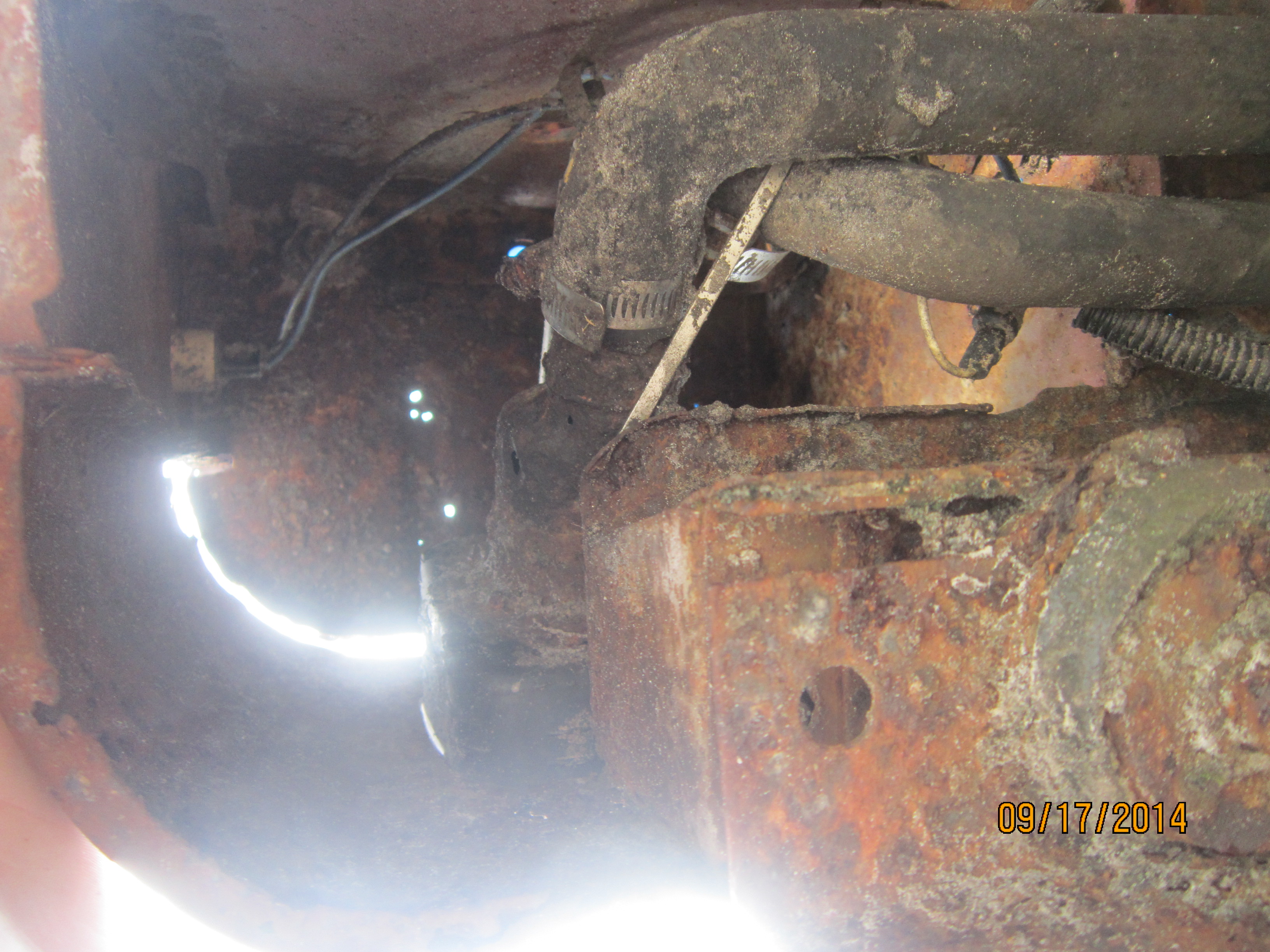

Mine cutout is 3 1/2" up from bottom of rear fender and 4" to the right of the tailgate edge, and it penetrates the fender well 7 1/2" (missing the inside fender box by 1/4") before dropping down to cross over to the top of the tank. I snapped pis with a Tape measure in for reference but cant seem to get them to upload.

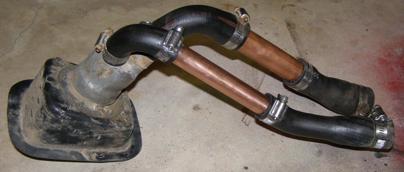

On a side note: Is that 3/4" copper pipe that you have spliced inline? I am just curious as to the effects of today's petroleum products on Copper.
I know it can get green and fuzzy.
I hope the rust holes in my jeep help to shine a little light on your situation,

Perfect Thanks very Much- It's been over 100 degrees here in SoCal but should be back into the 90's in a few and I can get back at it- Now I have a better Idea Thanks again
