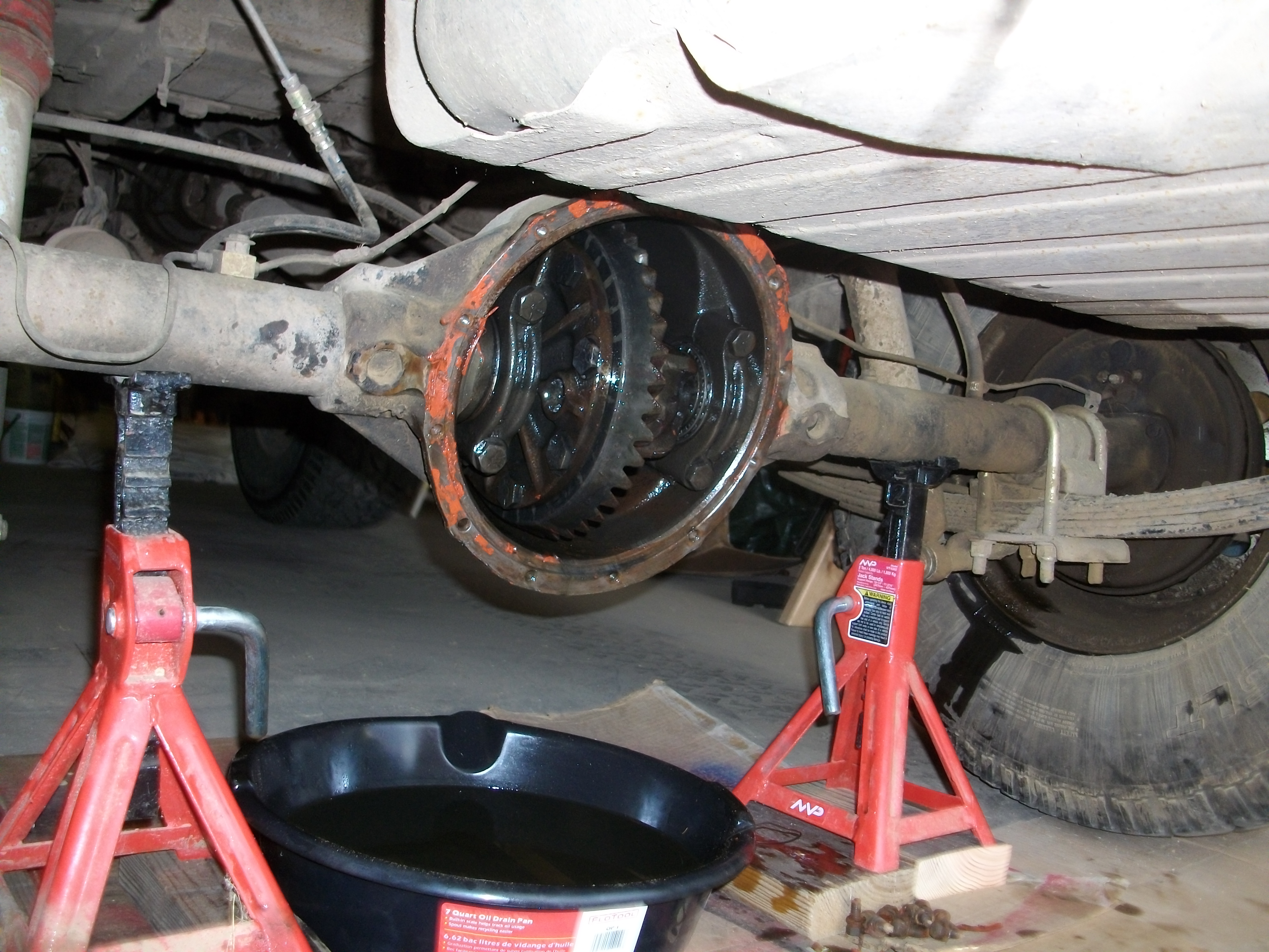

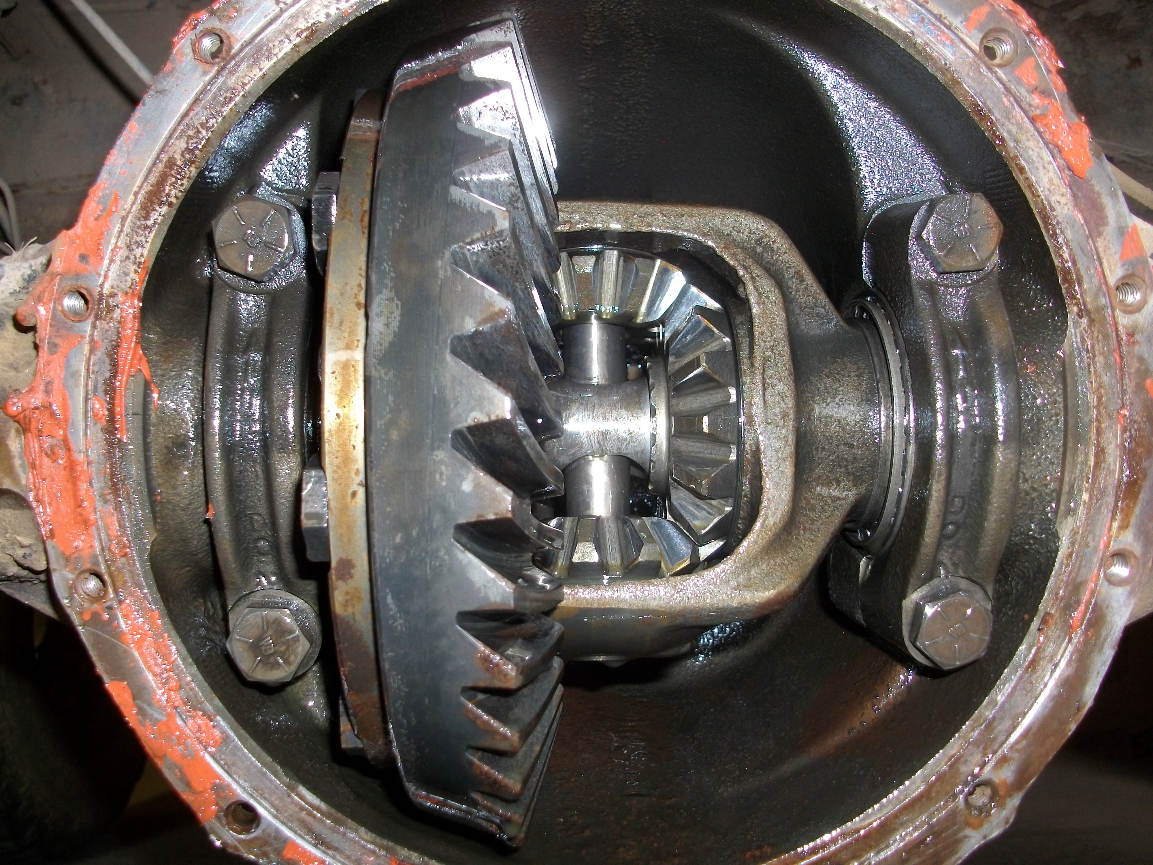

I bought a '79 CJ7 two years ago. It's pieced together outta everything, it's like a Johnny Cash song. Anyway I can't figure out what these axels are. Any ideas? There was another thread about the Dana axels and none of the dif covers matched what I got. Mine was round with no indentations, looked like it might be older. Take a look and tell me what you think. The number 168 is relieved on the top of the dif. Any help would be awesome. Thanks.
It's an amc 20. All cj's from 76 to 86 had them. The later 86 models came with Dana 44's

You can look on the side of the ring gear and it will be stamped with series of numbers (I.e. 43X13 which would work out to 3:31 to 1). The Trac-Loc differential case will be more square shaped and you should see disk (clutch packs) next to the spider gears inside. From your photo, it looks to be an open differential.

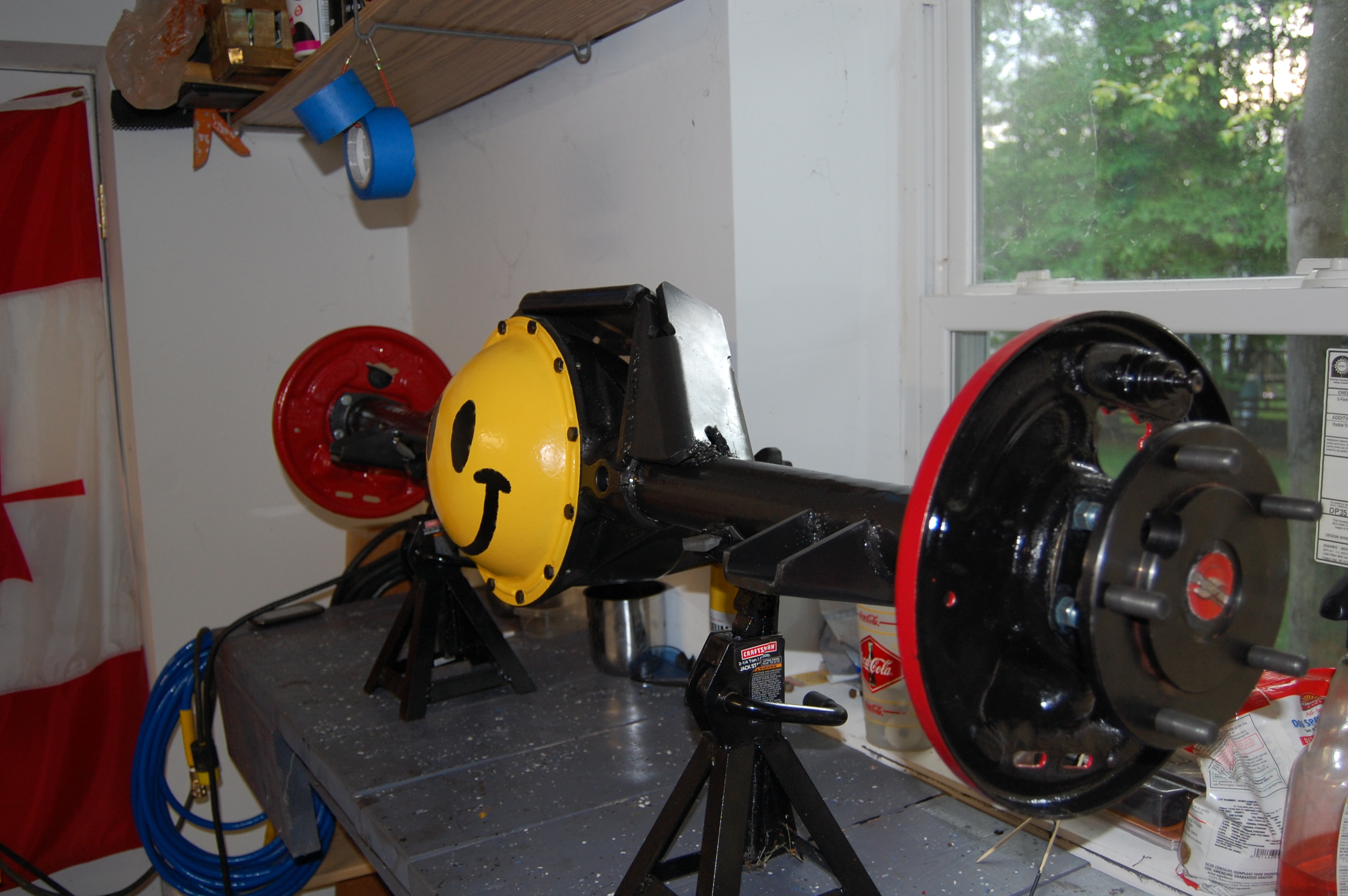

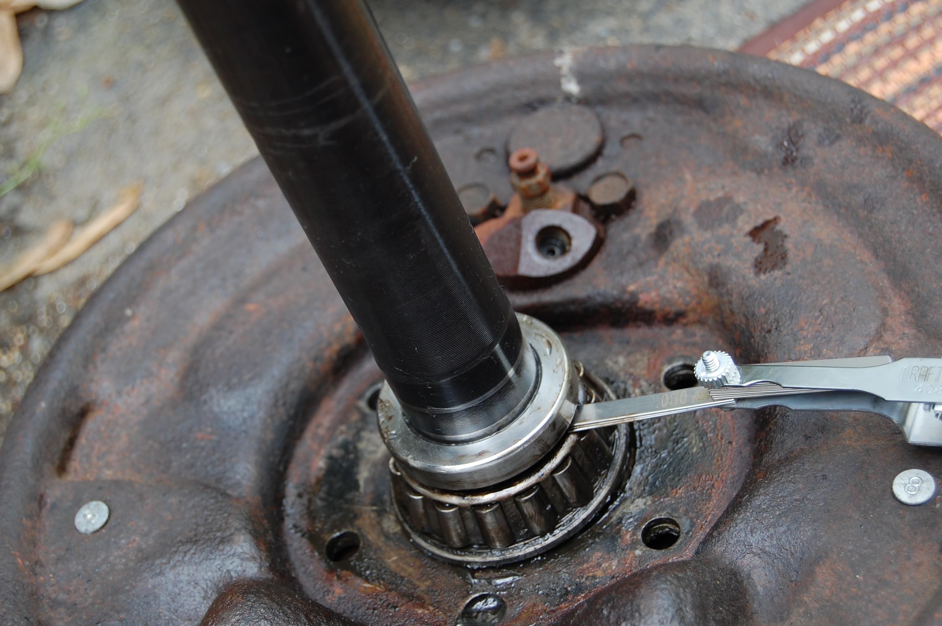

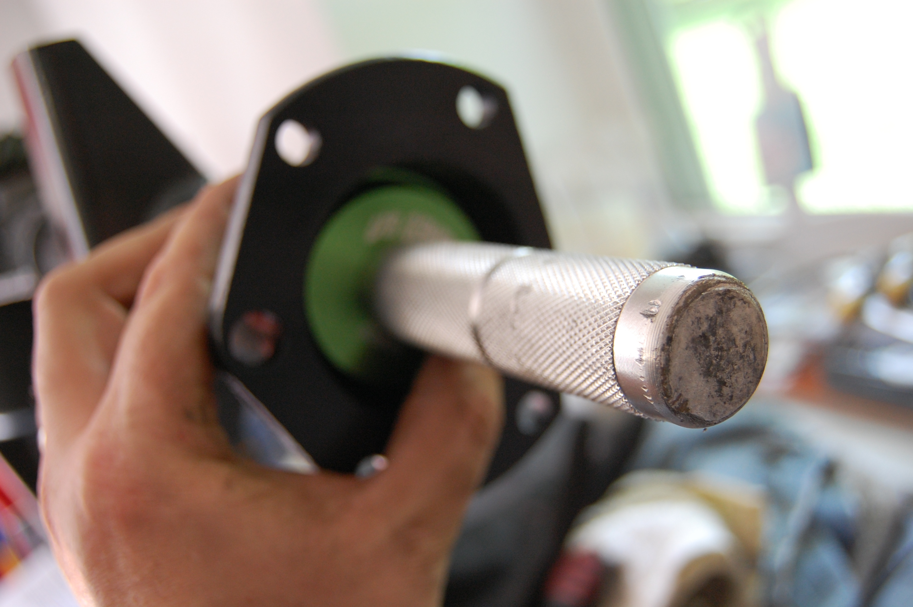

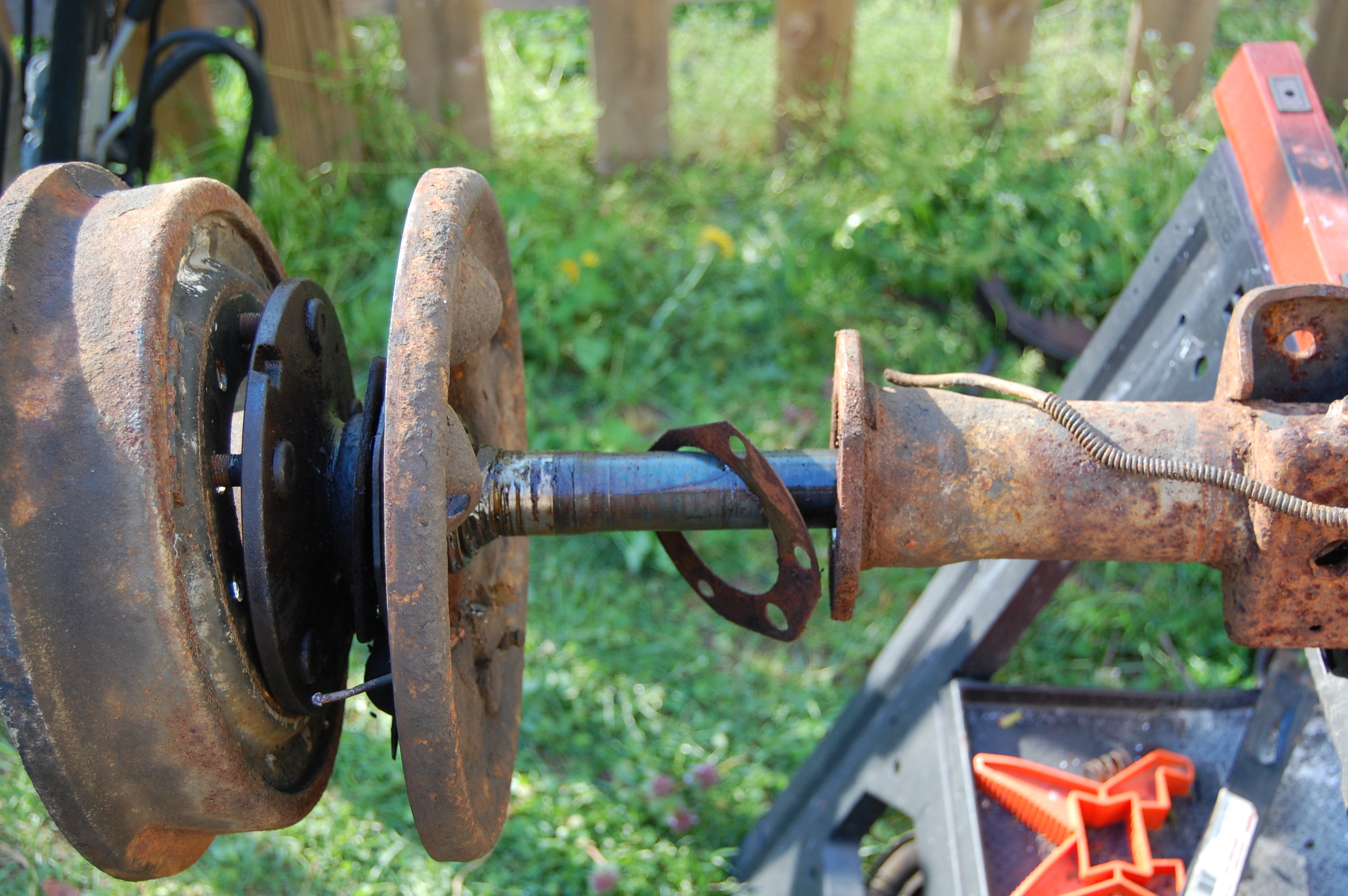

Alright, so I thought I had more photo's. But these will do,unfortunately they are of an AMC20 being upgraded to one piece axles during a complete rebuild and only show the stock set up being pulled out. And just in case you decide to upgrade, a couple of photo's of the wrong way to press on bearings (those are from a repair I did after a so called "Professional Shop" did an axles swap).
As you can see, the old shafts come out after removing the drum brake hardware and you take off the four axle flange bolts located under the hub. I normal just flip the drum over and install it upside down with the lugs tighten just a few turns, it will work just like a slide hammer to get the axle lose from the differential. Take note of what side and how many shims come off the orginal set up if you just repair the stock axle shafts, you will be reusing them.

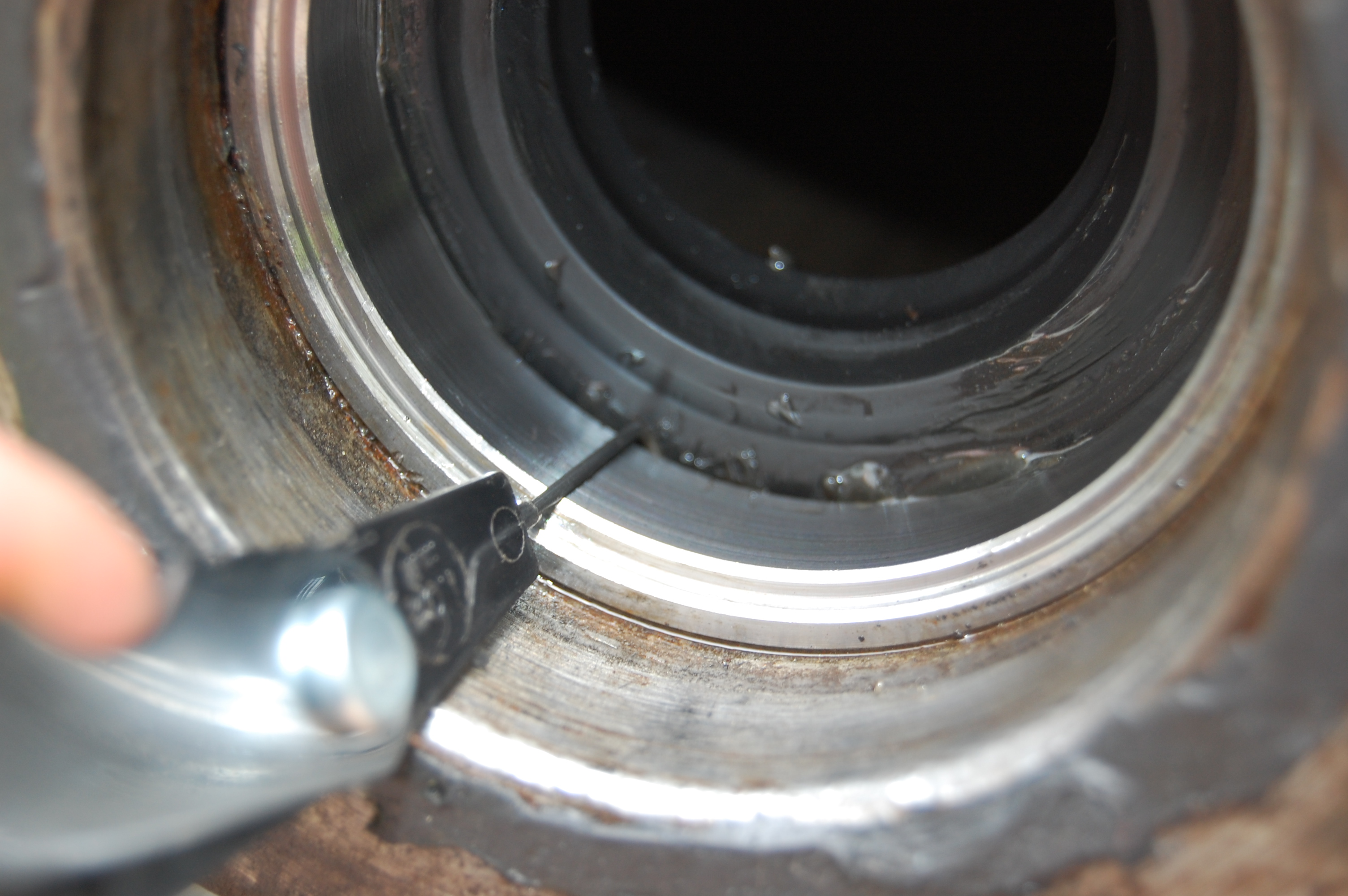

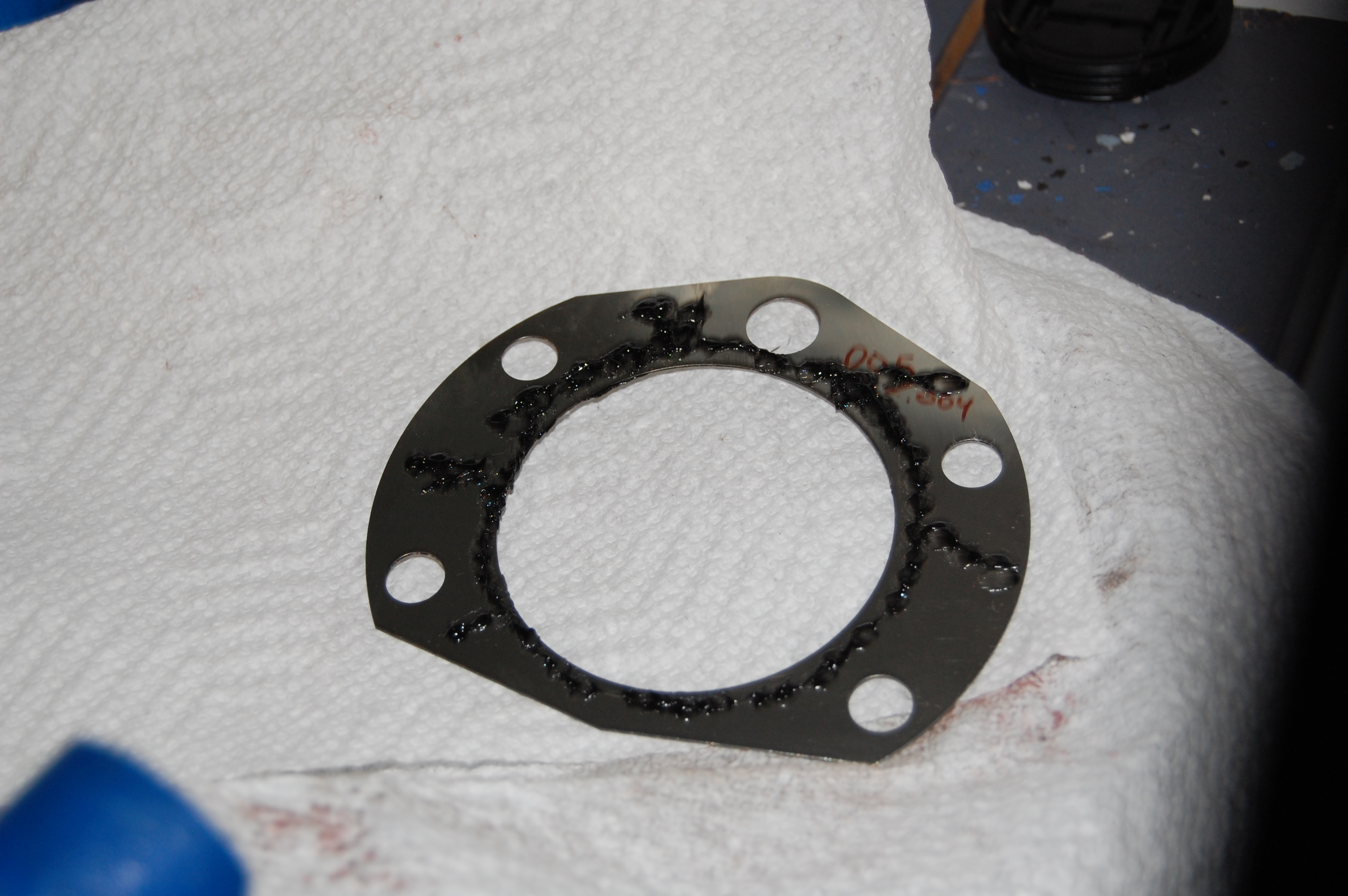

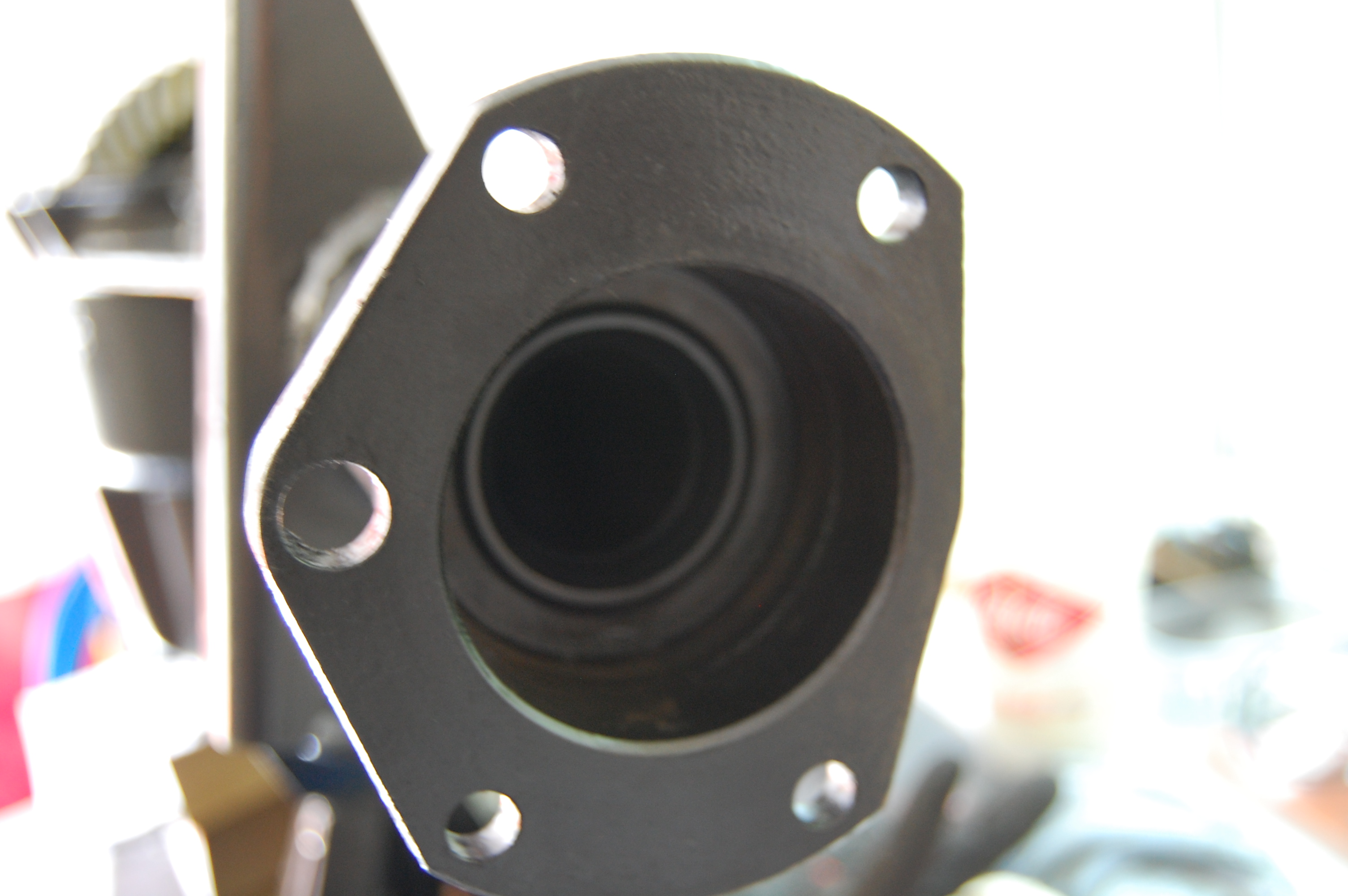

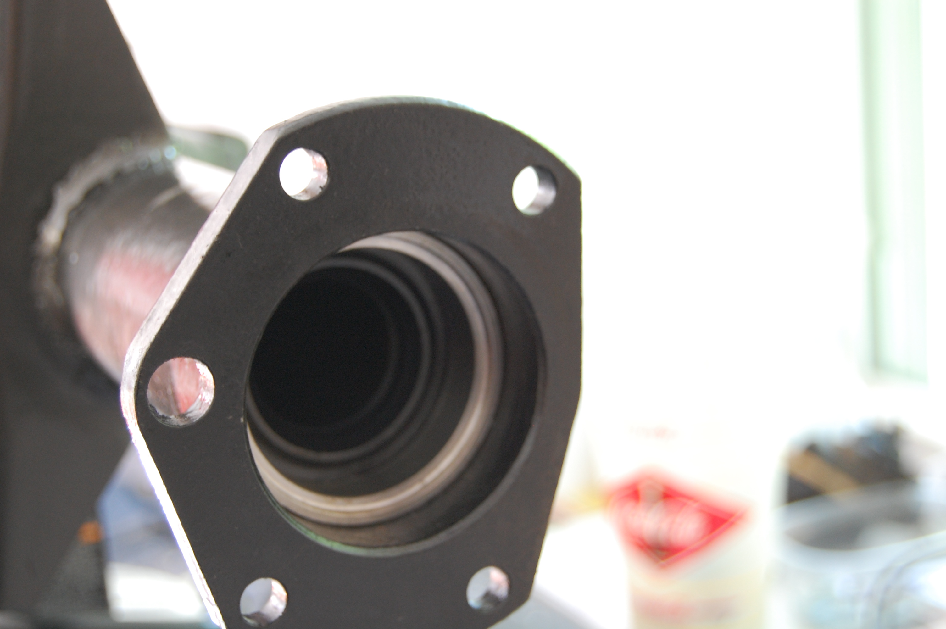

Before you replace the seals and bearings, you will need to clean out the axle flange to remove the old grease, residue, etc. I like to run a green scouring pad around the inside. Next you will put a light coating of RTV around the edge of the inner seal and gently seat it with your fingers.Then use a bearing race/seal tool to seat the seal fully (just couple of light taps making sure its square inside the tube). Without one piece axles you will not have the silver spacer.

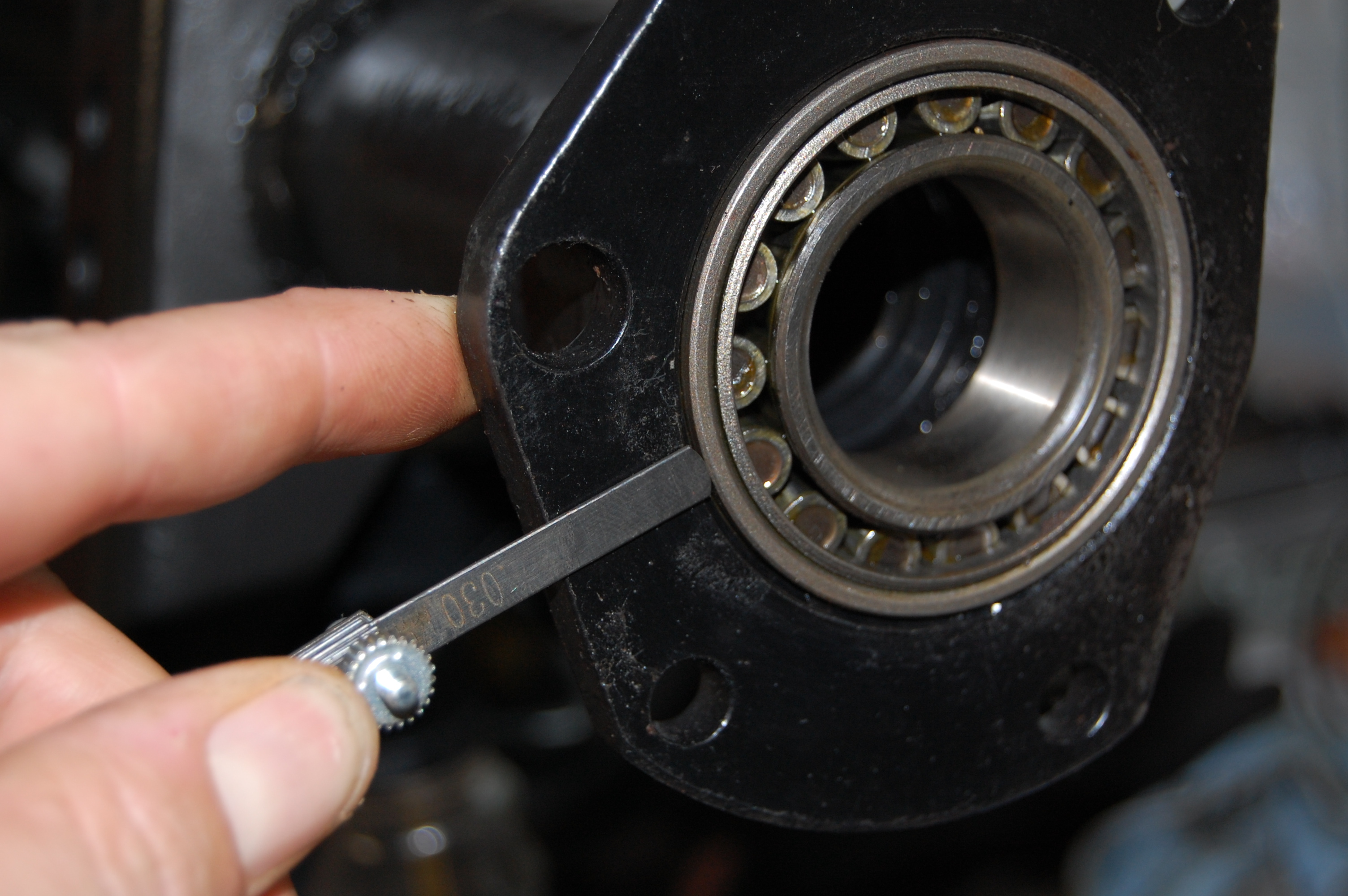

This photo is just FYI if you go with the upgraded axle route, the bearing and race should extend greater than .020" but not more.060". If its greater, you need to add shims to the face of the axle flange.

Regardless of the set up you go with, the next step is press the bearing on the axle shaft. On the stock AMC 20 axle the cone shape of the bearing faces the brake drum (remember that the race will be seated on top of the cage with the new bearing, so look close). If you don't have a hydraulic press equipped for this, your local garage should be able to do it. However, I have seen some clever ways of getting the bearing on the stock axle since it only has to move a little on the open end of the axle (on a one piece axle it must go on the splined end and slide down towards the flange, this will require a press). Do not try to use a hammer! With the one piece axle shaft upgrade, there are some additional steps before pressing on the bearing like putting the dust shield on,the outer seal and the brake backing platein place prior to pressing the bearing. Additionally, you'll have a thick metalring pressed on last as a retainer. Not to worry, all the one piece kits I have seen include crystal clear instructions.
