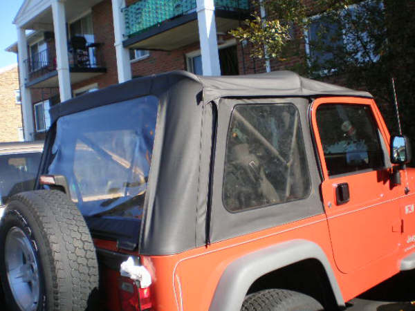

How comparable is a bestop to a factory soft top? i just found a used bestop, all hardware, only used for 2 months, good condition for $400. they were asking 500 but i offered 400, and they said yes. good deal, right? from the pics she sent me, it doesn't look like it comes with door surrounds. does anyone know if it needs them? i only have a hard top now, so i dont really know about soft tops. thanks for any help you can give.

You will need a pair of the Door Surrounds with the Full hard doors or half doors with soft uppers. If that's the Sailcloth soft top from Bestop, then thats the same OEM replacement you will get from the Factory. Bestop Manufactures the Factory soft top for the Jeeps..I've seen a better deal than that but rarely in my area. FYI, The door surrounds should be visible when the doors are open.

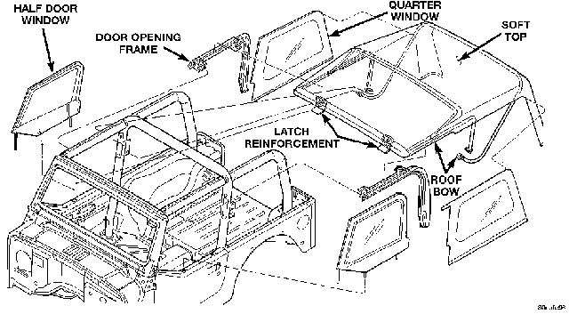

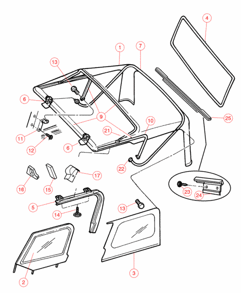

Hardwares: you will need a bow, cross support, 2 pivot brackets for the roll bar with 4 bolts, Front windshield header, rear window lower support, 2 door surrounds. here's the diagram.
