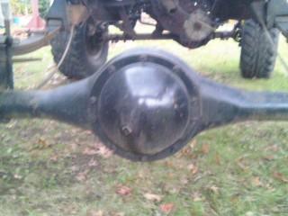

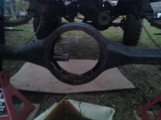

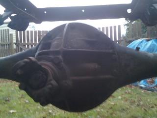

i bought a chevy one ton truck to get the axles for my new project truck but i cant figure out what the rear axle is.. it has a drop out 3rd member and the diff pan comes off too.. it says GM on the ring gear.. please help..

it's a eaton HO72 great axle, probably one of the most under rated axles, they do run a wierd gear ratio though
too add, if it is a 6 lug, it could be a HO33 1/2 ton rear axle built from 55 to 62 I think.. or it could be a HO52 built prior to 1955 was also built in a 6 lug semi float axle.
the HO72 shares a lot of parts with a 14 bolt, so if you wanted to run a 35 spline shafts, you can swap the 14 bolt shafts and carrier.
thank you.. i forgot to add it was a full floater 8 lug axle.. i kinda thought it may be an eaton but was sure.. you dont happen to kno how to get to the spiders to weld her up do you??
yea from my research they are pretty much unbreakable. can be shaved so they have more ground clearance they a dana 44 and are stronger and lighter then a corporate 14 bolt.. the only downside i have found about them is the newset ones are still lmost 40 years old(they stopped production in 77 or 78) i read alot of 14 bolt parts can interchange.. i wish i had the 5.14s or the 4.57sn gears but mine has 4.10s in it.. althought with the sm465 granny first i still should be able to get away runniong 40 or 42 inch tires and still have decent power. now i need to figure out how to weld it up. the way the carrier is you cannot see the spider gears at all..
If it's like a 14b you should be able to disassemble the carrier to access the spider gears. Weld them up and bolt the carrier back together.
thats what i was thinking but i have never disassembled an axle and this axle the gear pattern is perfect for being 40 plus years old the gear teeth look brand new, no chips wear patterns nothing... i may just bite the bullet and tear into the carrier. from what i read they are really easy to reset up the gears.. the 3rd member ways around 110+ pounds. but overall they weight less then a 14 bolt
