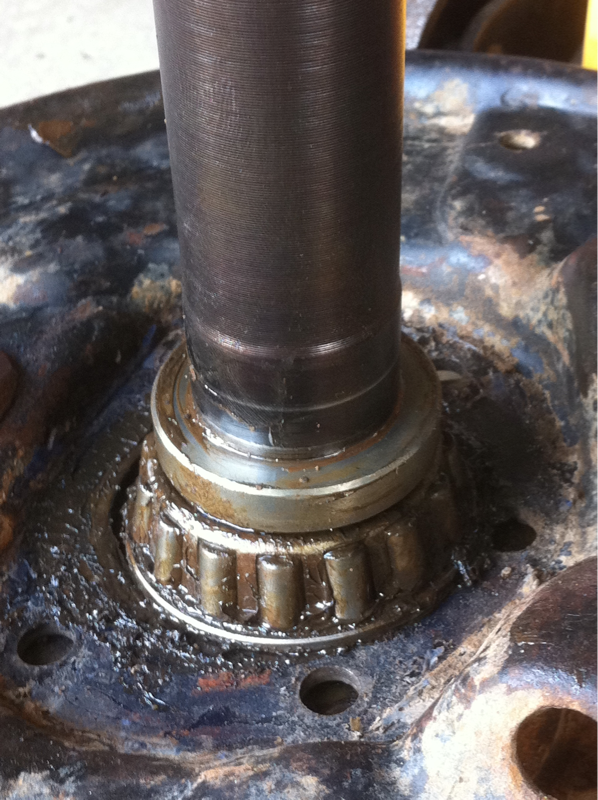

I am going trough the rear differential. I need to know what the piece is that's above the bearing and where i can buy two of them. Your help is greatly appreciated.

Part above the bearing is the bearing collar. It is pressed on over the bearing at high force to keep the bearing on the shaft. These will come in the new bearing kit.
