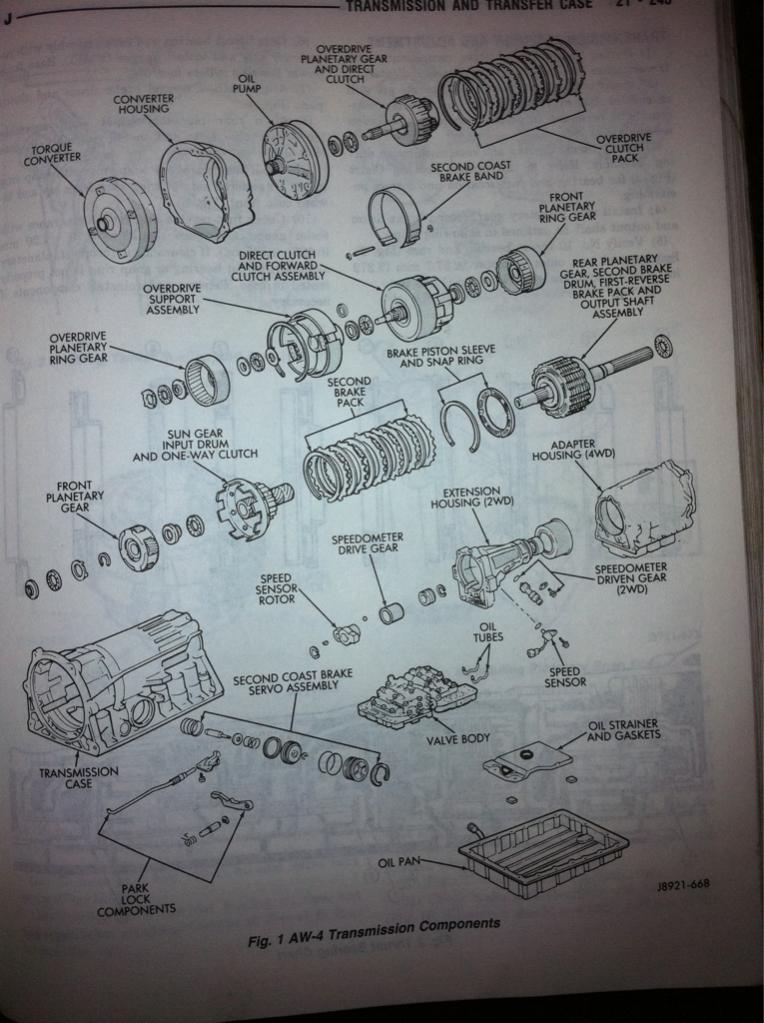

My 88 XJ has just recently rolled the odometer past 300k. The trans seems to be running its last days, even with external cooler on a high cfm fan and ATF+4. So I look to you guys and gals for an AW4 diagram, and any advice of known issues or problem areas. My mechanical skills are advanced, but as ive never broken down this trans, advice would be greatly appreciated. Even some feed back on your rebuilds, what would you want different, or the perfect build.

I will try to find a manual at work i work for a dodge dealer see if there is a schematic i can get ahold of. I had a customer that needed the range sensor and the cost was about 900 bucks dealer list.
ty jester32, that would be great. @jeepkid46 any tools you can list that you know of. This daily driver can only be down for the weekend so all tools and pit falls being know will save me some time.
There is a good 120 pages in the factory service manual. Here is a pic of the basic break down. There is a bunch of special tools for pulling various components out other than that all i can see is dial indicators. Outside mic. Feeler blade. And an assortment of snap ring pliers. Anything else you need let me know.

I cant remember i would have to look again but i thinknthere is a puller
