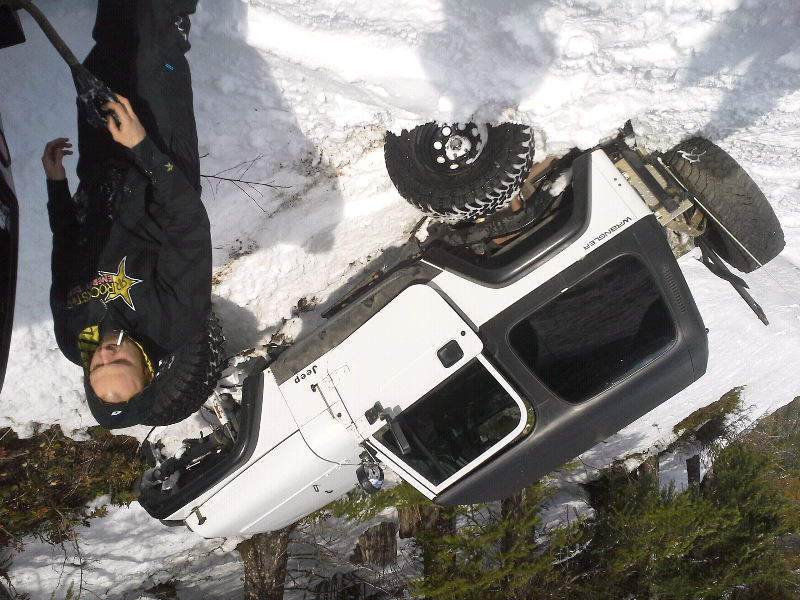

This is a picture where she cut lose on me. as I was backing up out of this ditch and yes I dumped the cluch alittle to pick up the rear end out of the ditch. Notice how far the rear tire is pushed forward on the passenger side. as I backed up snow built up behind the rear axle and as I gave her some juice...pop. I figured I would be safe from axle wrap too but this is the second time the CV snapped once in the summer rock crawling on a extreme.angle and now today in the snow. If I make something to.hold the rear end from moving so much back and forth would this help?? These CV are getting pricey

The axle did travel forward 2.5" if you look at the pic my rear axle was sunk in the ditch and I was heavy on the throttle in reverse. So I actually shoved it forward. I have good springs with AD a leaf in the rear. My Pinon angles are good. I think this was cause from operator error

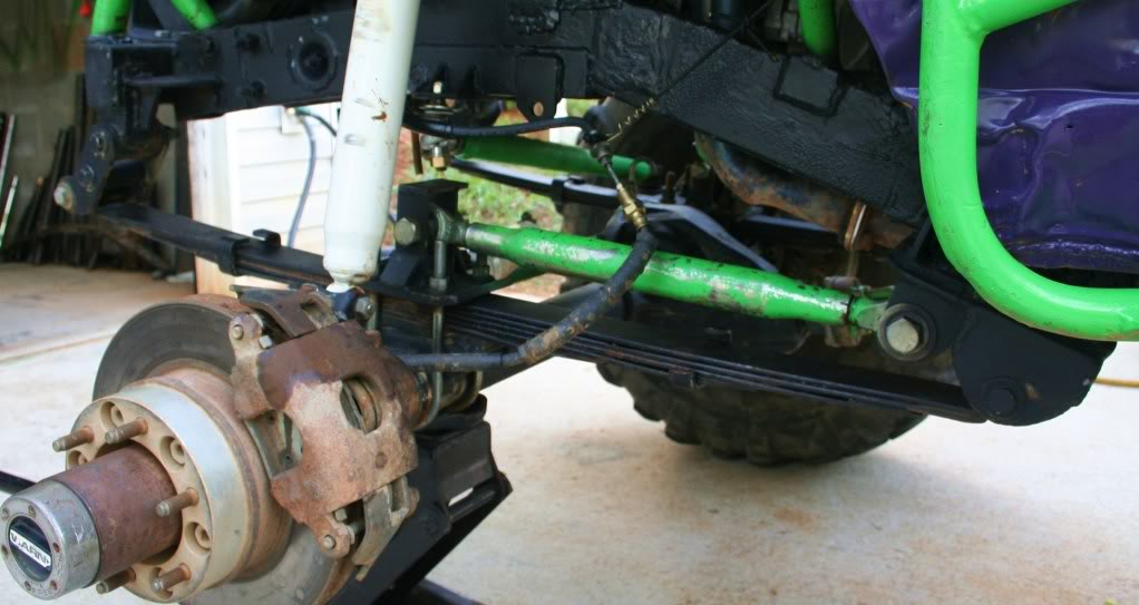

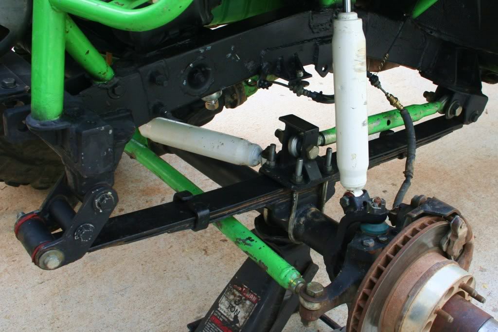

Found this idea on Pirate4x4 for antiwrap. I.T. (In Theory) will not limit articulation.
Hope this helps for ideas.
Bacon
I wonder if it would be any better if that bar was something like a steering dampner. Do you think it would allow suspension flex but absorb any shock load like axle wrap applied to the springs.???????
The correct way to set up an anti-wrap is to have a connection on top and bottom of the axle. As shown in the pictures above with only a connection point on the top side of the axle there is still the potential of that axle having axle wrap.
While power and gearing can make it worse you will have axle wrap no matter what if the springs are to soft. Which is probably the case with your setup. The springs being to soft and no antiwrap setup is also the reason your axle is walking, you are bending your springs which is causing the axle to move forward.
On my old YJ I ran something like this and I still got spring wrap on certain occasions but it def help.
Jeep Traction Bar for Rear Axle CJ-7 and YJ from MMountain Off-Road (M.O.R.E.)
