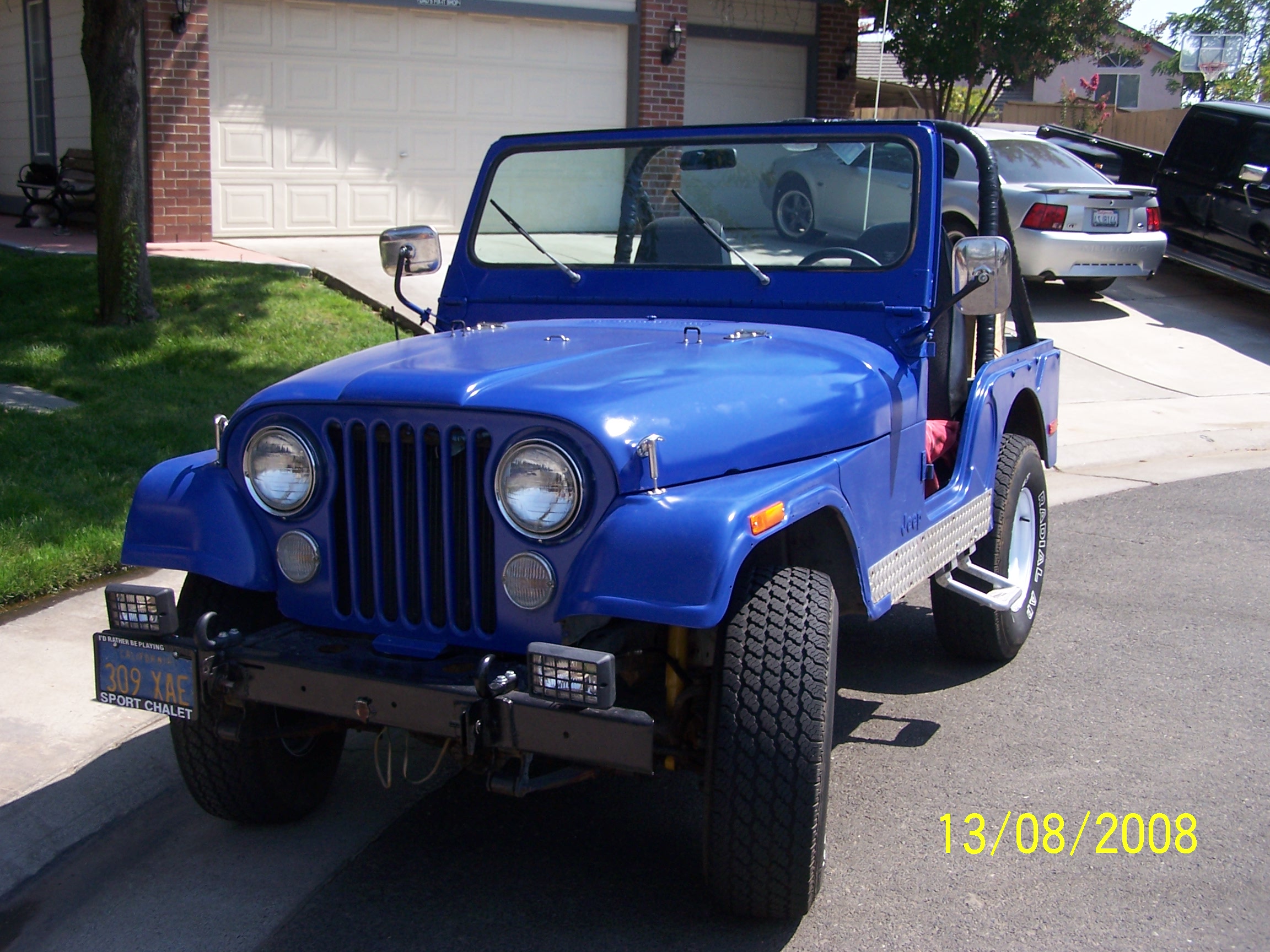

Hey i am new to this jeep thing and wanted some advice on wat i should do to my CJ5 its a everyday driver but i want to be able to take it out on the trails. So can anyone give me some advice on wat i should do?
Slight lift 2.5-3.5" 33-35's if they will fit and a locker for the rear, should get you through most trails while still keeping it simple and drivable.
stretch teh wheel base in the rear slightly. use a 4" YJ lift (mod the front hangers) and pull the rear back about 3 inches and run 36" tires with ease.
Cuz this is wat the jeep looks like as of now it has the stock lifts and 31x10.5
