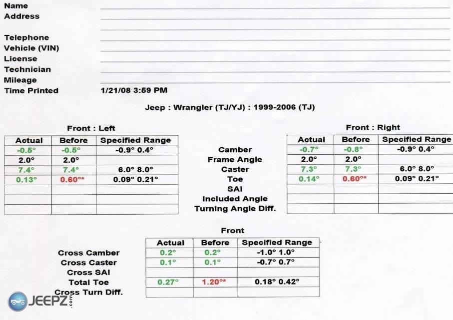

Here's a printout after I added 2" spacers
