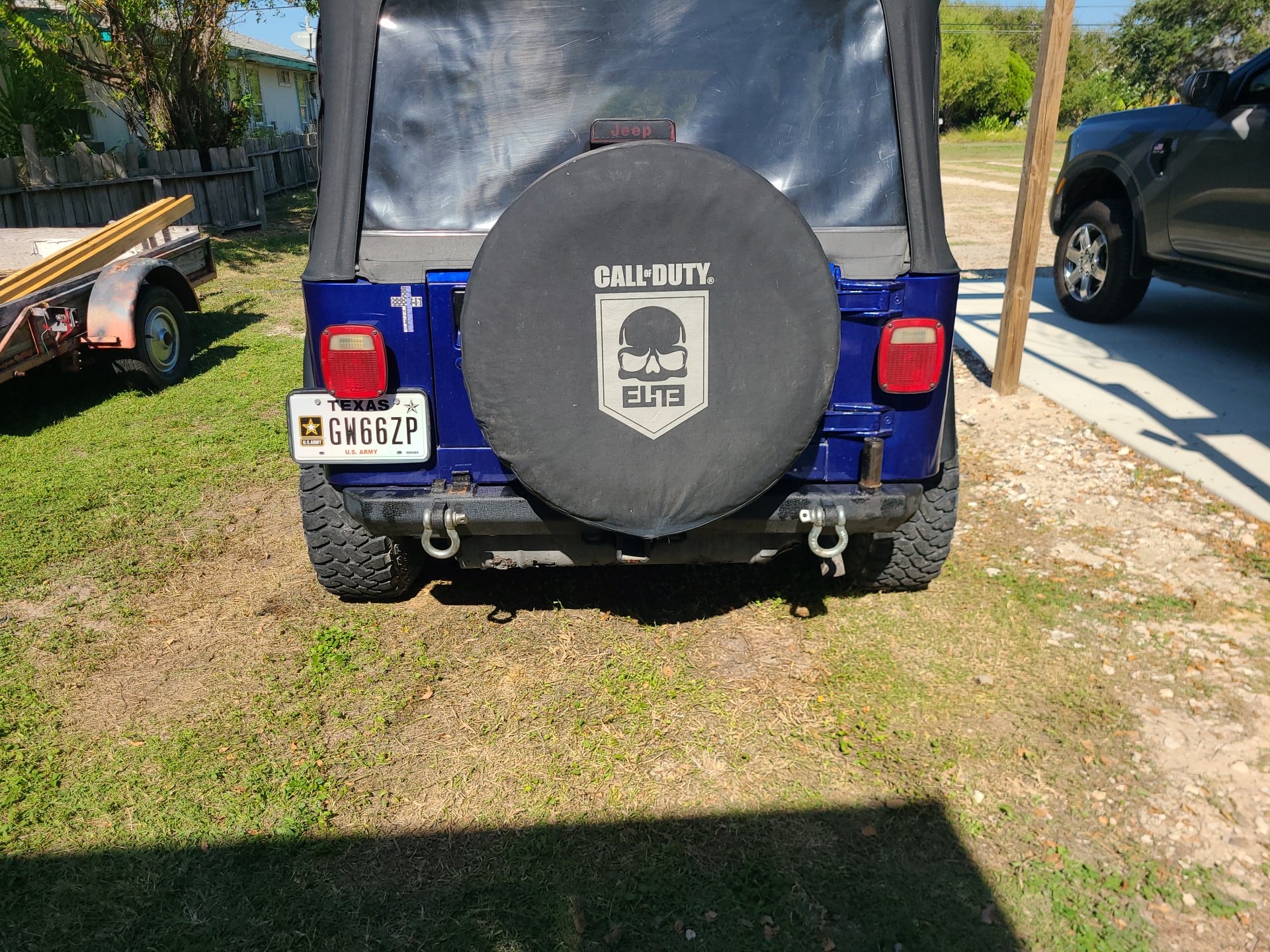

Added a facebook market place bumper
superj
Well-known member
Got it for cheap and put it on today.
Better than the stock tin can bumper, thats for sure.

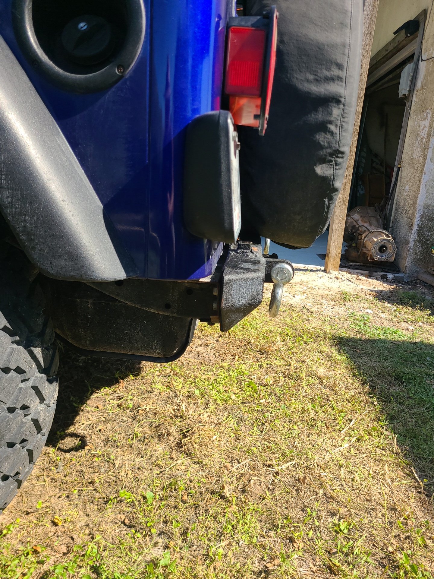

Looks nice. Do the shackles line up with the frame?
Like where the frame and rear cross member meet? I think they are about 3 inches inboard of the frame mount on each side i think. It has bolts on each side of where the frame and crossmember meet and i think those shackles are over the inboard set of bolts.
It uses seven 5/8" (16mm) 10.9 grade bolts on each side. 6 come through the cross member into the captured nuts welded inside the bumper and one on rach side coming up from the bottom
Just something to consider should you use the shackles to tow or pull someone out. Strength of the anchor point.
Yeah, they are just for looks. I told my son to take them off since someone in town will do it when he is not looking anyways
