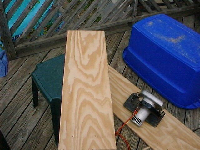

I saw an add on Ebay for a rear cover for Wranglers, that would cover our valuables. Instead of paying the $75, I decided to build my own for my CJ, and possible make some improvementsm. Click on the picture for a larger image

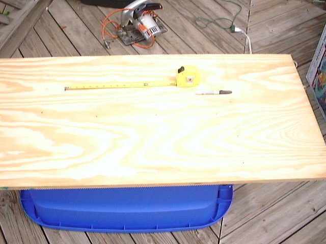

Step 1
I bought a piece of 3/4 inch plywood from Sears Hardware ($7)

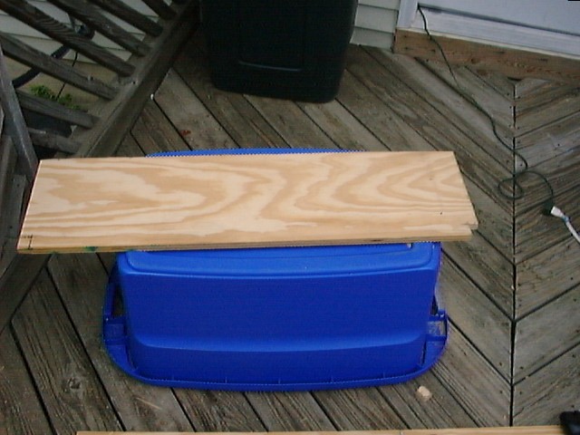

Step 3
Now you need to cut out notches to make room for the tailgate. Cut off a a 3" square on both corners of one side

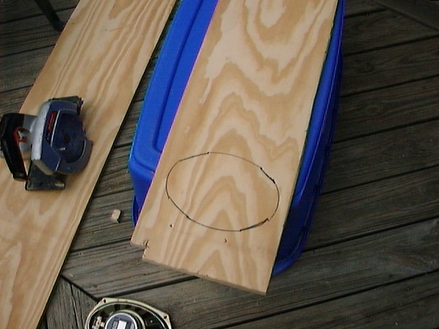

If you want, you can cut speaker holes.

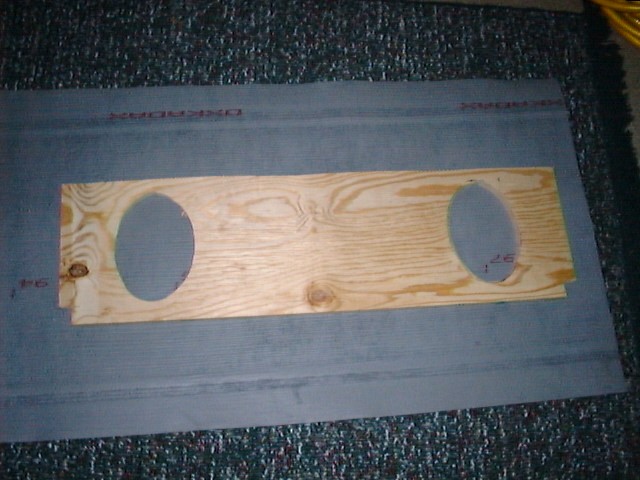

Step 5
Staple some carpet to it. I used outdoor carpet, which you can buy by the foot

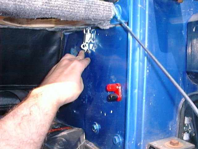

Step 6
Put latches on (I used the same type that come on foot chests). This allows you to snap your deck in and out, and will secure your valuables

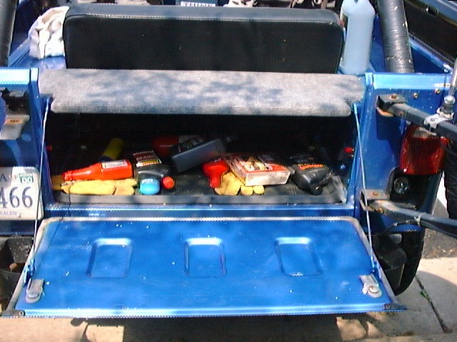

Step 6
Now you can hide your Junk!
I was going to do something simular to this too. But I have aluminum diamond floor plate to build a lockable tool box. Then place a removable pc of plywood with indoor/outdoor carpet for a platform for my dog Stupid to come with me.
Well that explains the three small holes that are drilled on the rear wheel wells on each side,i had a feeling thats what the prev.owner had done. Anyway i kinda liked the way yours turned out i may put it back that way...thanks
Thanks. It's a good way to keep casual thieves out of your stuff (it won't stop anyone serious though).
I did the same thing with my jeep, but then I went a step further. Folded the back seat up into the collapsed position,and ran the ply wood from the seat to the tailgate.It gave me about 3 feet of lockable storage space. I wanted it strong enough to support camping gear or a person. Got some angle iron from a bed frame and bolted that to the bottom of the plywood. notched out about 4"from each end of the angle iron so as to rest on the wheel well and bolted it down to the wheel well. I used 2 pieces of angle iron about a foot apart to support the plywood and go from wheel well to wheel well. works well,and dosnt take long to take it out or install it.
