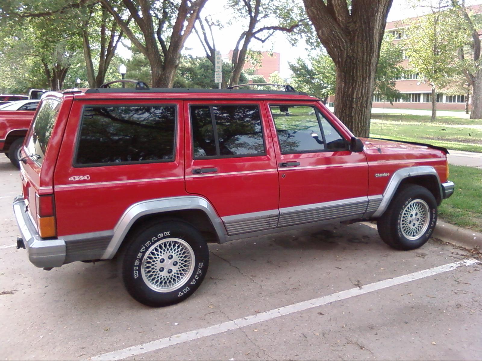

[See attached photo. This thing is a beauty. Hopefully you'll feel sorry for it... LOL]
